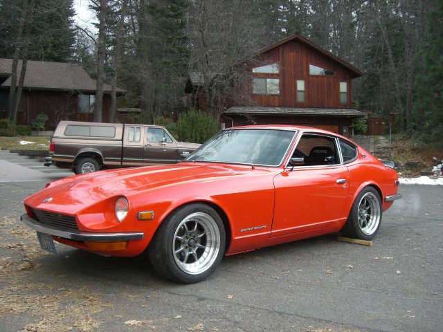

Andy...I did not do any of the mods on this car this is just the way she came to me, so as far as why the springs sit where they do its just a result of the sum of the parts i guess..as far as suspension travel i can let you know when the car is off the stands. Pictures? I have a few... -

Thanks for all the input guys..so far my thinking is this, the car is to low, i love the look and have owned more than a few slammed rides but this one needs to come up a wee bit. I think i have found a set of 200# springs so those will go in the back and the 175# can ride up front. Also think i will take off the burned out 225/45/16's and fit 225/50/16's not sure on that one though. The rear fenders are rolled and have a little flare (not my favorite thing about this car) so i don't think rubbing will be that big a problem. Camber plates may be in the future but have only driven this thing for about 30min total (started snowing as soon as i got it off the trailer) so i need a little more seat time before i figure out where to inject the cash, so for now waiting on a few parts from MSA...240hoke you have one of my all time favs...drooled over your car many times...way nice... -

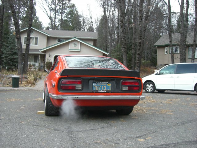

Well something was way wrong with the suspension on this car as soon as I drove it and now we see the damage, but the cause is a bit of a mystery for me. This is a ground control setup as far as I can tell, I believe the strut housings are 280z sectioned but I have to figure out how much was taken off. Both fronts are wasted and the rears are rubbing just not near as bad. Springs are Eibach 10†175# Rears and 150# up front. Inserts are unknown at this point. From what I can find around the site this is to light a spring rate, could that cause this kind of damage? Not sure why it would. Anyway looks like I will be looking for some parts soon and don’t want to see this happen to the new stuff. Any ideas are appreciated…Thanks

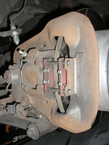

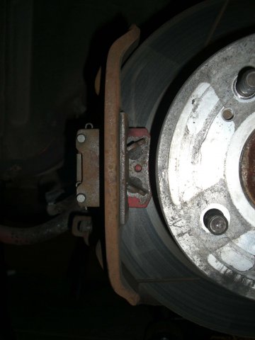

Can anyone I.D this rear disk setup??
Zgotrip replied to Zgotrip's topic in Brakes, Wheels, Suspension and Chassis
Prefect, thanks guys! I like the fact that these are Z parts and since my main short term goal is to sort out the suspension these will be sticking around for a while. After I got the car up on stands for the first time last night I was glad to see the R200 diff and suspect most (if not all?) of the rear end is from the same 280z…nice. Hope to get the rear coilover’s off tonight and see what there made of…Thanks again
