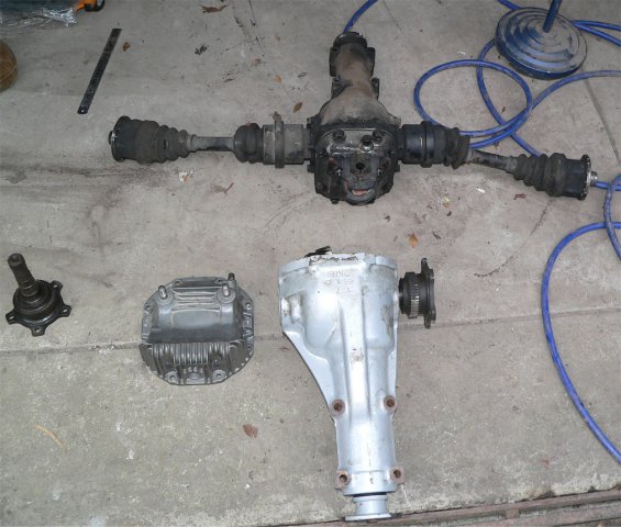

  1. Ok well, I now know that these cannot be adapted easily so my next option would be to buy the other end of the half shaft to the wheel hub, Does anyone know which model i would be best looking at going? and also what the distance is on a 280zx from wheel hub to wheel hub? or Hub to Diff. thanks Joe

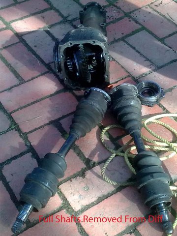

  2. Well basically after a lot of hard work almost knocking myself out, a half broken nose and about 2 & 1/5 tonnes of pressure i have my old shafts & Diff apart which i believe is a R180, i now have the issue of my half shafts & CV's The photos are what i have My questions are 1. Could i use the full shafts as the are from the old diff assuming they fit, even though from the R200 one of the half shafts is longer than the other? 2. If i cannot use the old shafts without altering them, how the heck do i go about using the halfshafts i have the rest of the existing shaft? I have done a bit of research but have'nt come up with a great deal any help is greatly appreciated Cheers Joe
