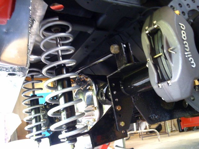

It's a ladder bar concept, going forward from where the pic ends it attaches to floor of car by way of a flat plate with a rod end. Will take pic and post. -

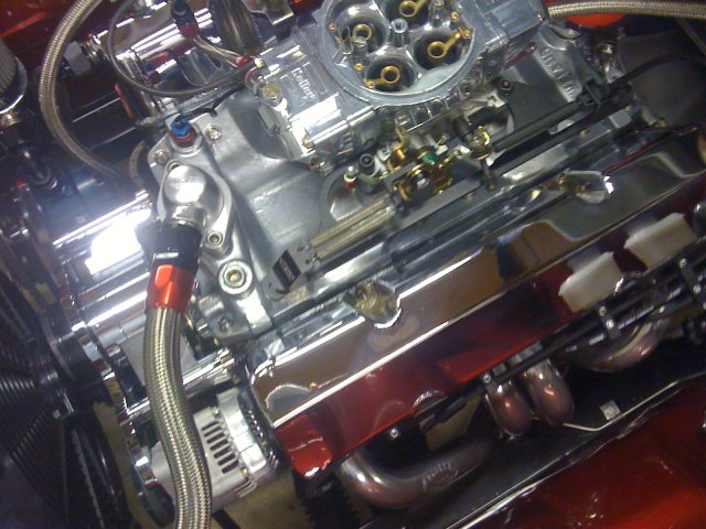

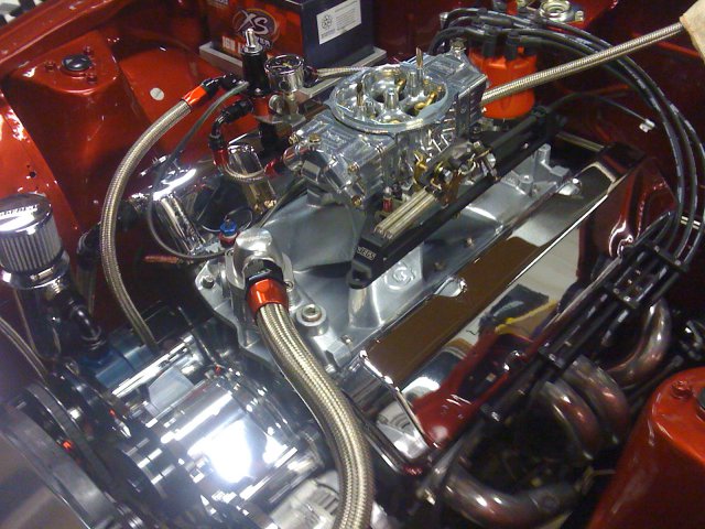

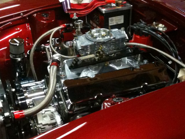

I have to ask what is that spiffy bracket you're using for the alternator? And it looks like you're installing A/C as well? Nice! Man thanks for the compliments!! It makes the stress of the project worthwhile. The bracket is made by Moroso it comes with a Billet Aluminum finish but I had mine chromed. It must been ran with the CSR,Meziere or Moroso electric water pumps. I think it's the most trick bracket available especially if you are running old school heads like mine which do not have accessory bolt holes. Actually what you saw on my motor is a crank case vacuum pump. A/C? lol this unit is being built for wheelstands not comfort! Good news is you won't need that bracket! Here's the link to the one you would most likely be interested in. http://www.moroso.com/catalog/categorydisplay.asp?catcode=30001
