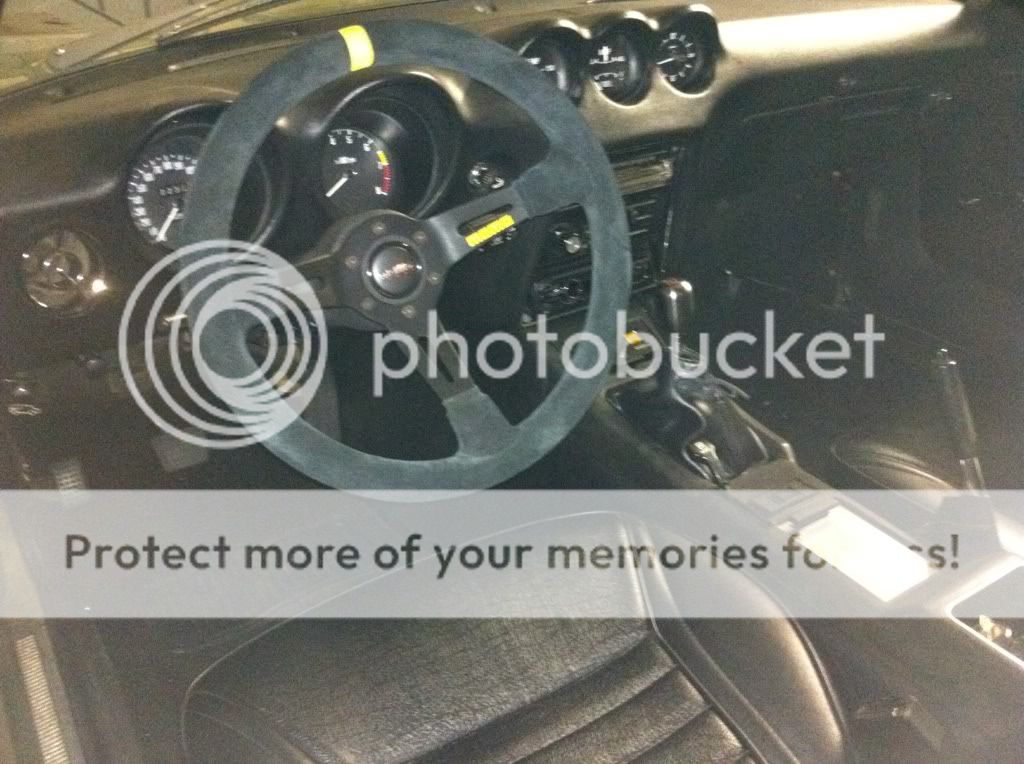

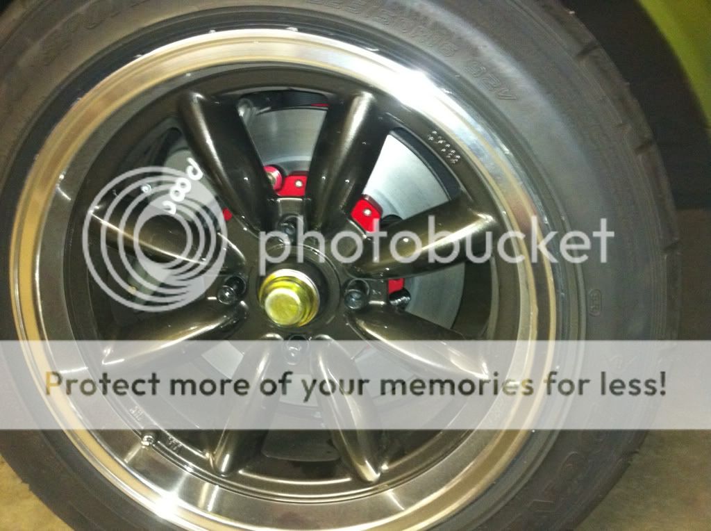

fastfloyd Posted June 9, 2011 Share Posted June 9, 2011 (edited) I bought this car last November from my father-in-laws best friend from High School. He was not the original owner but i think the 3rd owner. I got tons of service records and even the original Bill of Sale from the Datsun Dealer in Salem, Oregon. Sold for $4420 new. Built 3/72 HLS30 74950I did the interior first and POR15'd the floor which was in great shape. The Interior was Butterscotch and in poor condition so i decided to change it to black.Engine Mods (New Motor):280Z F54 Block with Flattop PistonsE88 Head with new Valve guides/ground seats/sealsStage 2 cam280ZX DistributorZ-Therapy complete rebuild on the carbs and a shaved balance tubeITG air filtersPertronix CoilMSA 60A internal regulator AlternatorMSA 6-1 Ceramic coated headerCustom 2 1/4 exhaustTransmission:NOS - 5spd (never in car) Chassis Mods:TTT complete all 4 cornersArizona Z-Car Complete Coilover kit (250lb Springs)(Custom non-adjustable spherical ball upper mounts)Wilwood Arizona Z-Car 4-piston Front BrakesAZC billet mustache bar and billet brace kitSilverline Motors - Rear disc conversion (very nice kit and awesome e-brake)ST ft & rr swaybars (1" ft - 3/4" rr)Rota RB - 16x8 -4Dunlop Direzza Star Spec - 225/50 Edited June 8, 2014 by fastfloyd Quote Link to comment Share on other sites More sharing options...

fastfloyd Posted September 13, 2011 Author Share Posted September 13, 2011 Went to PIR for a HPDS school from Cascade Sports Car Club and finally got some track time. Car worked great, but stock seats are a NO GO! Bought some Sparco's and a MSA Roll Bar. Will install next week. I'll post more pics after. Quote Link to comment Share on other sites More sharing options...
fastfloyd Posted September 25, 2011 Author Share Posted September 25, 2011 Putting some Sparco's and a rollbar in tomorrow. Will post up some pics tomorrow Quote Link to comment Share on other sites More sharing options...
luseboy Posted October 2, 2011 Share Posted October 2, 2011 This car is awesome! So clean! the only issue I have with it is the rims look way too big... but that's just me, I'm into small rims. Anyways I really like your car! I plan to paint my '73 green hah. how did the por15 stuff work? and how is that roll bar? I'm looking into getting one... Quote Link to comment Share on other sites More sharing options...
fastfloyd Posted October 12, 2011 Author Share Posted October 12, 2011 I ended up yanking the MSA roll bar. Sparco R100 seats fit great but the roll bar would not allow seats to go back far enough or to recline. Quote Link to comment Share on other sites More sharing options...
luseboy Posted October 12, 2011 Share Posted October 12, 2011 On 10/12/2011 at 2:14 AM, fastfloyd said: I ended up yanking the MSA roll bar. Sparco R100 seats fit great but the roll bar would not allow seats to go back far enough or to recline. Interesting that you did that. I had been planning on getting a jegs roll bar for a while but decided against it for the time being (decided I had other priorities, like getting the car rolling). The interior looks great! Quote Link to comment Share on other sites More sharing options...
fastfloyd Posted October 12, 2011 Author Share Posted October 12, 2011 The MSA roll bar fit fine and the quality is good but with these seats, i could not go back far enough and i am only 6 ft. I also could not recline the seats properly. In the end, i simply mounted the belts to the stock location on the body up above the quarter window. Gonna sell the roll bar now. Quote Link to comment Share on other sites More sharing options...
luseboy Posted December 16, 2011 Share Posted December 16, 2011 On 10/12/2011 at 2:22 AM, fastfloyd said: The MSA roll bar fit fine and the quality is good but with these seats, i could not go back far enough and i am only 6 ft. I also could not recline the seats properly. In the end, i simply mounted the belts to the stock location on the body up above the quarter window. Gonna sell the roll bar now. Woah I took forever to reply to this. Any updates? Did you happen to take any pics of the bar installed? And was it very heavy? Haha I shouldn't have any problems with that, I am about 5' 11" but I have short arms and legs so I like my seat really close to the wheel. Those seats look great! I was thinking about getting the R100's, but decided that I really want a true bucket for the driver's side, so I will probably get a kragen seat for passenger (girlfriend doesn't want to sit in a bucket haha), and the sparco speed 2 for the driver's side. Should be cool. Quote Link to comment Share on other sites More sharing options...

fastfloyd Posted June 8, 2014 Author Share Posted June 8, 2014 (edited) I decided to take my car a step further and bought some CCW wheels and wide ZG flares. I also decided on a new color scheme; Gulf Racing livery. Here are some pics of the progress. Edited June 8, 2014 by fastfloyd Quote Link to comment Share on other sites More sharing options...
fastfloyd Posted June 8, 2014 Author Share Posted June 8, 2014 (edited) More pics of the progress. Was a big deal to cut the fenders. I was really on the fence about it. But. I have a vision in my mind of what I want the finished project to be. Edited June 8, 2014 by fastfloyd Quote Link to comment Share on other sites More sharing options...
fastfloyd Posted June 8, 2014 Author Share Posted June 8, 2014 (edited) Going to wrap in Gulf Racing Blue. Orange wheel centers and Orange side stripes. Doing a wrap is almost as much work as a paint job, but i do a few HPDE days a year at PIR and a wrap seemed more sensible. Carbon BAMF Flares from jdmflares.com 17x9.5 in front, 17x11 rear NOS fender mirrors will complete the look. You really have to take the car apart if you want to do it right. Edited June 8, 2014 by fastfloyd Quote Link to comment Share on other sites More sharing options...
