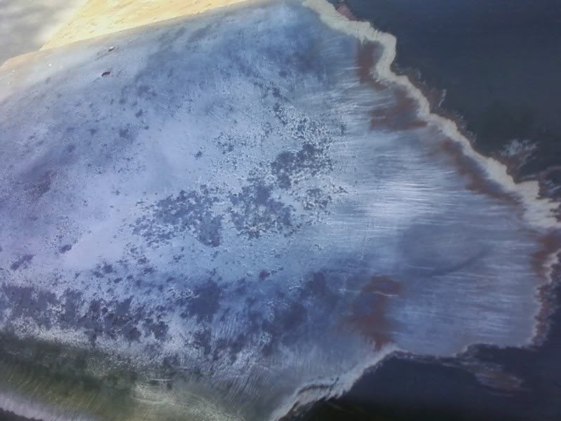

Siberian Husky Posted June 18, 2011 Share Posted June 18, 2011 (edited) There was a molded spoiler that was startin to go bad underneath. I stripped it off and found some rust. Wire wheeled my way to this. How bad is this pitting rust and what is the best way to remedy it? Edited June 18, 2011 by Siberian Husky Quote Link to comment Share on other sites More sharing options...
johnc Posted June 18, 2011 Share Posted June 18, 2011 Not bad. Spray with a high zinc primer, POR15, or some other rust treatment. Quote Link to comment Share on other sites More sharing options...
jpuga Posted June 19, 2011 Share Posted June 19, 2011 Looks like u got some small holes... Make sure u treat both side of the metal and you should. You could just add a little filler to cover them up but definitely treat the metal with pot 15 Quote Link to comment Share on other sites More sharing options...
Meph Posted June 19, 2011 Share Posted June 19, 2011 a cheap hand held sandblaster (10-20 dollars) and a compressor is the best treatment before paint. Quote Link to comment Share on other sites More sharing options...
280z4me2 Posted June 21, 2011 Share Posted June 21, 2011 I always use phosphoric acid to clean rusted metals. You can buy a gallon from home depot for about $15.00. It will actuallytake rust completely off or turn pitted rust into a black color which is chemically converted(no more rust). Do a quick google search on instructions for it. Its super easy and works great! Quote Link to comment Share on other sites More sharing options...
Pharaohabq Posted July 12, 2011 Share Posted July 12, 2011 pitted isn't so bad, so long as it's not all the way through the panel. (look at the other side to make sure) once you're certain of that, por15 and a high build primer should be fine. Quote Link to comment Share on other sites More sharing options...
