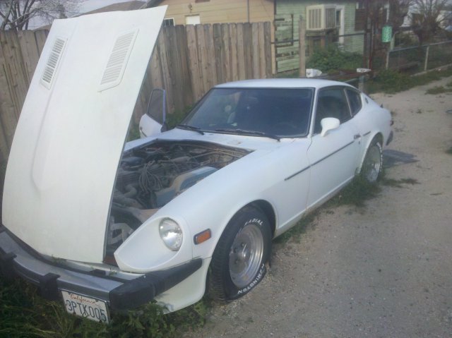

Ha rust that's funny... I took a good look at my inside of my floor pans and found a bunch of that (cruddy) rust and on the pass side got a few holes about a nickle in diameter. The driver side has one about 3inches ling and half inch wide. The pass side frame rail is smashed like a beer can because I tried jacking it up and crush. Lots of rust. Ill replace part of the frame rail and parch those holes. I do have small holes on the pannels but not much I'm not too woried about those. I do have a welder and some welding experience (kind of) will post pix of it later.
Ill be fixing her up and make her my daily driver.
