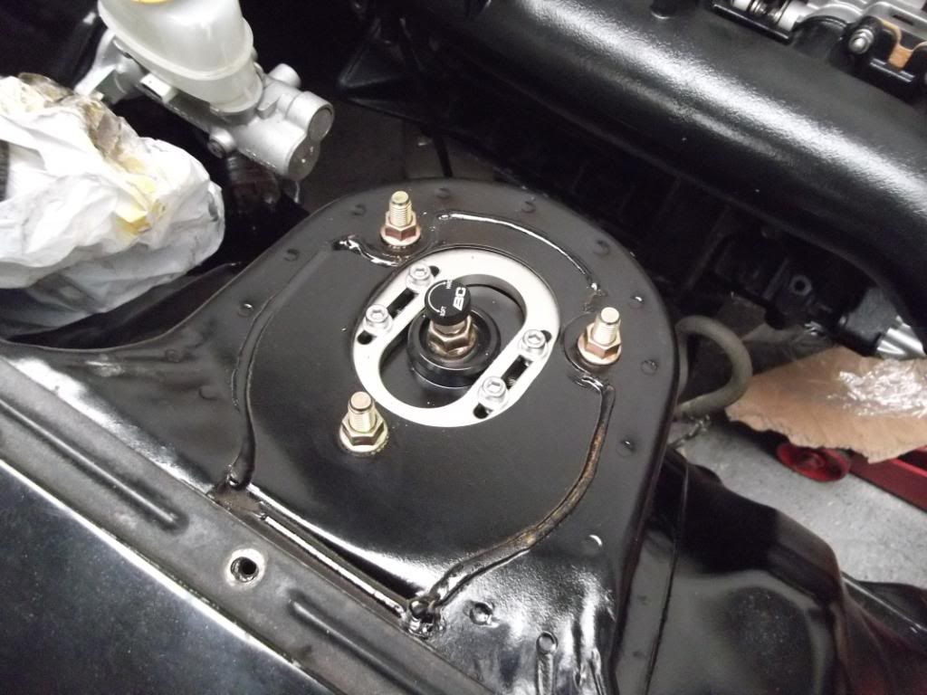

djz Posted June 25, 2011 Share Posted June 25, 2011 I'm working through it at the moment on my car. Strut tower cut out for camber adjustment One of the problems I have at the moment, with R32 GTR rotors (296x32) the rotor is hitting on the end of the control arm Modified R30 Skyline control arms to fit inside crossmember Custom made ball joints to fit in R30 arms, S14 taper 10mm longer Mockup of S14 5 stud hubs/knuckles with BC Gold coilovers Redrilled holes in the rear to fit coilover tops I tried R31 radius rods and they were too short. At the moment I'm trying to do something similar to this with these S13 adjustable radius rods: Quote Link to comment Share on other sites More sharing options...
