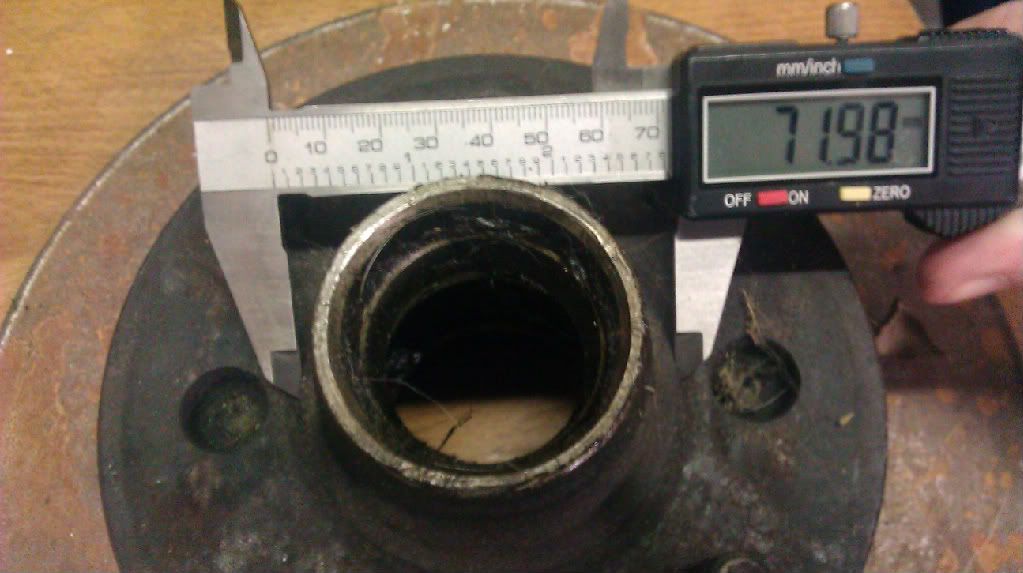

Kevin.pk Posted October 5, 2011 Share Posted October 5, 2011 This is my 78 280z hub. It measured ~71.98mm. But there is a very slight radius where the center piece meets the hub face where it isn't completely flat. 73.1mm total seems like a fair estimate for that though. Quote Link to comment Share on other sites More sharing options...
johnc Posted October 5, 2011 Share Posted October 5, 2011 The center bores are also different from front to back and within model years. Nissan always made running changes during production. S30s are designed for lug centric wheels anyway so it looks like a 74mm center bore wheel should cover it. Quote Link to comment Share on other sites More sharing options...
