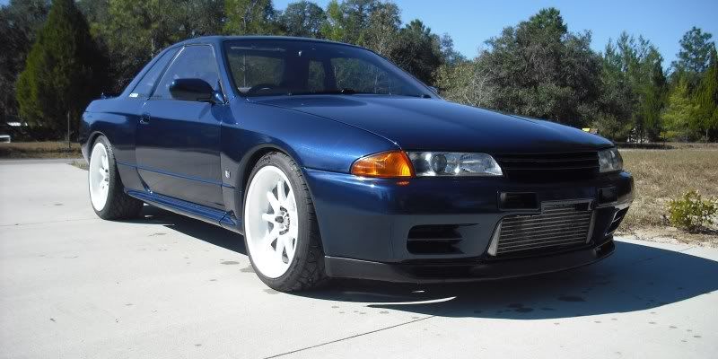

1991 R32 GTR w/R34 GTR Vspec II RB26DETT

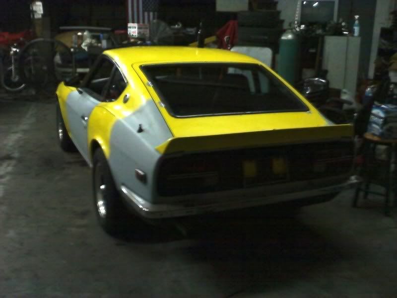

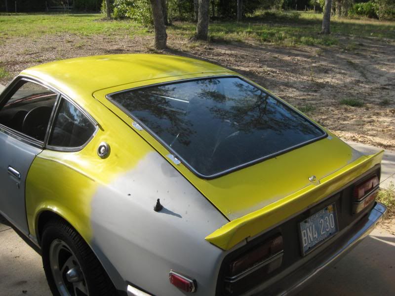

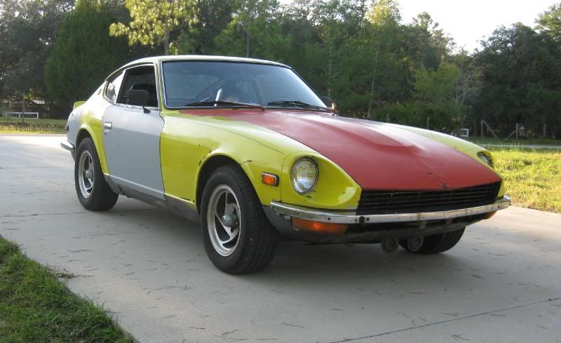

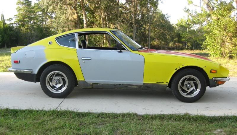

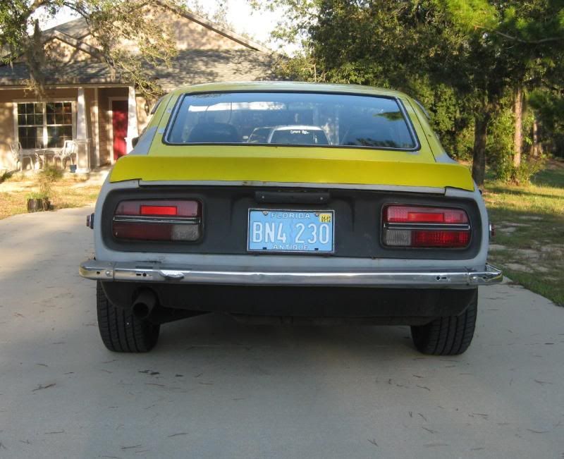

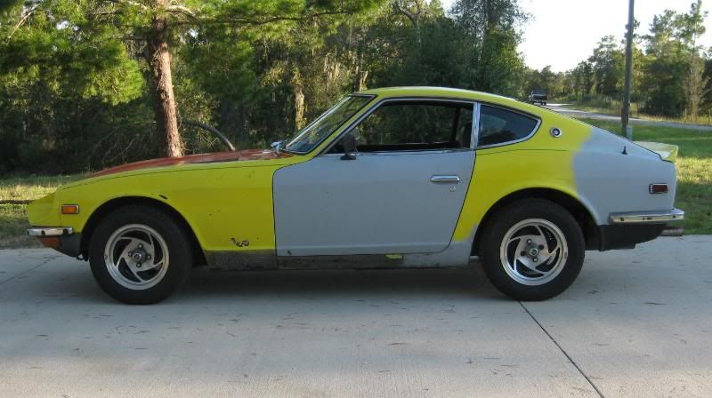

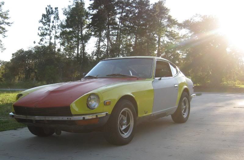

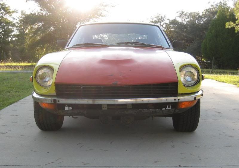

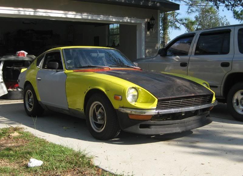

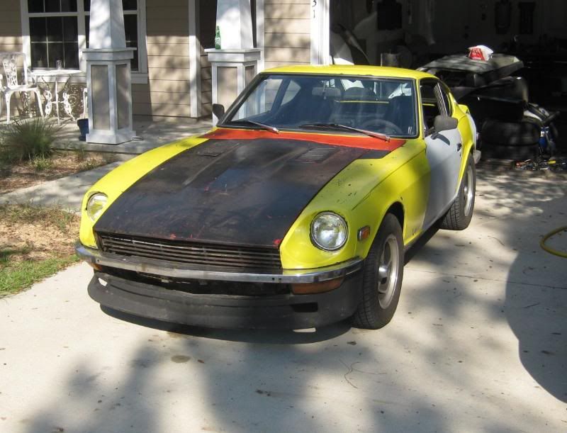

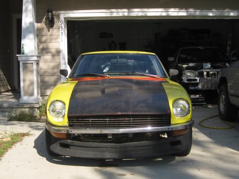

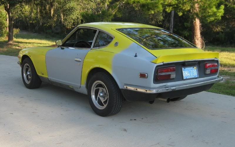

alrighty, well, here's the car in all it's "glory". I didn't wash it, just scrubbed the **** out of the interior, and threw some meguiars on it, and ran a quick vac over it...
If any of you guys REALLY know about old cars, pay attention to the body lines, the rust repairs, the minimal rust left to be addressed. look how the doors line up.... this is a SOLID, and straight car. floor pans, front frame rails, lower cowl panel, rear lower rockers/gas tank area, solid straight fenders have all been replaced, it also has around 50% of all the weather stripping replaced, overall a pretty solid foundation for a decent build i would think.

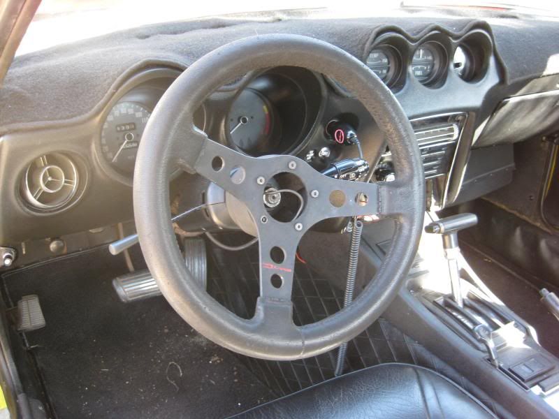

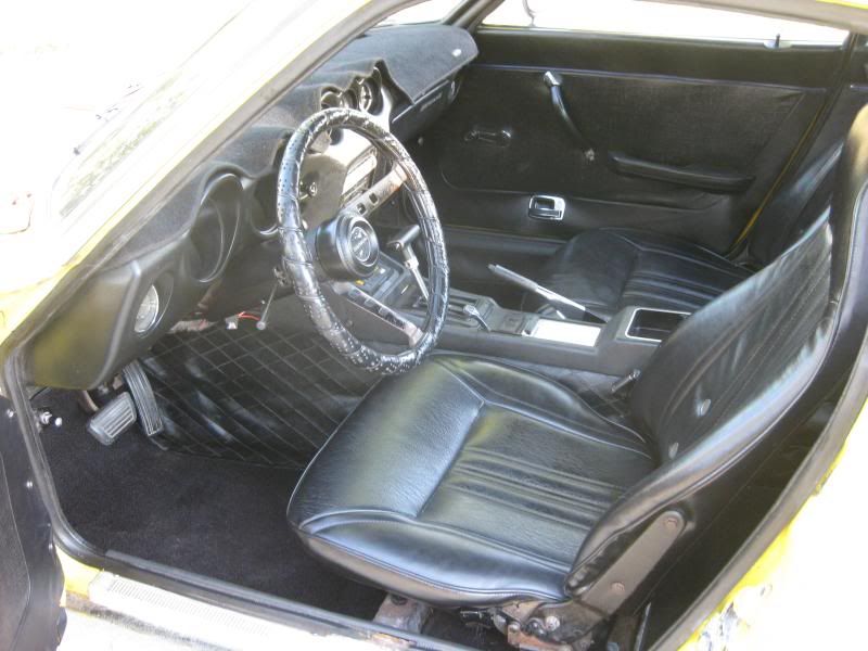

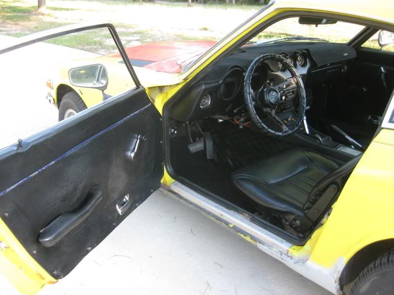

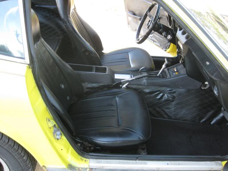

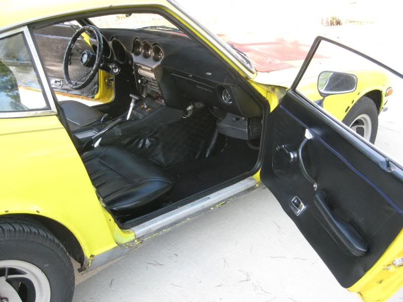

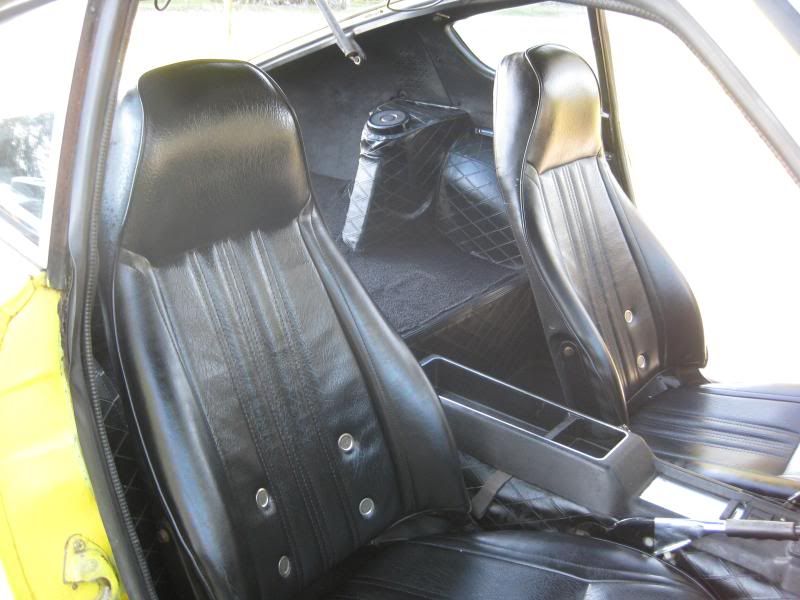

few shots of the interior, remember, this is EXACTLY how i got the car... only thing I've done is a ***** 3 step detail, nahmeen?
grocery shopping made amazing.
don't want too much back sweat...

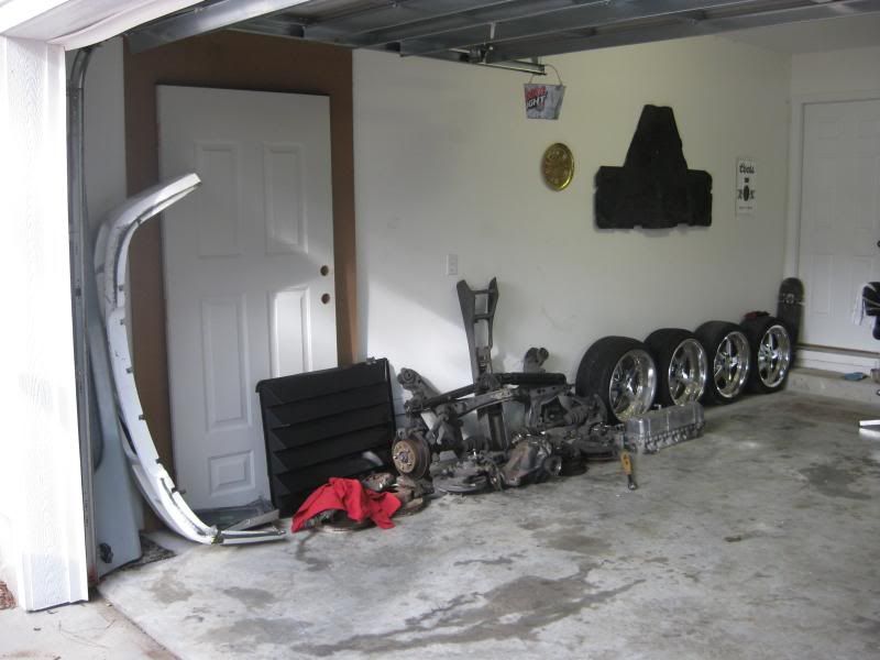

i made some progress towards getting the car ready for paint and body. I scored a SWEET deal on some parts from a local Z shop, on the low low... and he's got 4 more parts cars and is breaking me off decent on anything i want... no Zed tax.

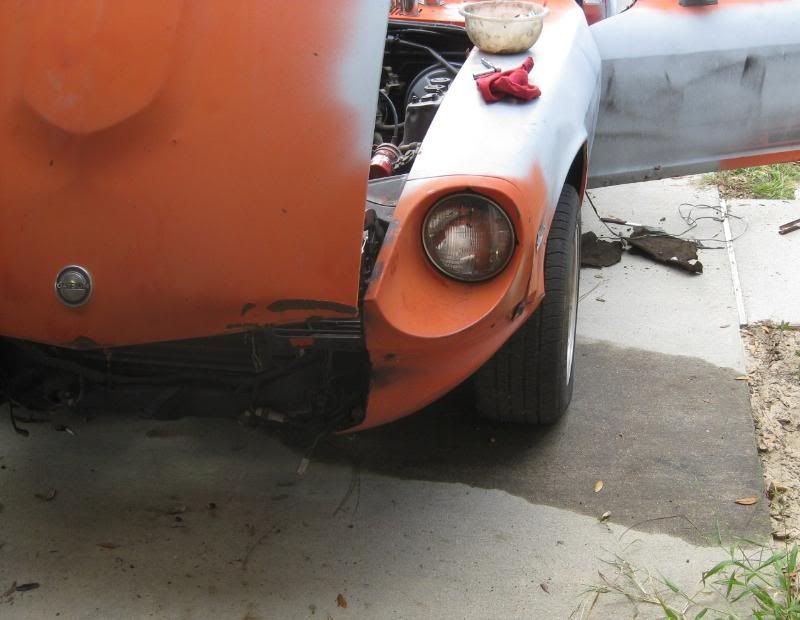

one thing i picked up was this front air dam...
over all i think it looks great, i mean, it's used, but ****, it's in great shape, mounted up SUPER easy... it's urethane, so it sags a bit in the middle, but that's fine, it's sure to see pleanty of cones, and parking space dividers from DD'ing it.

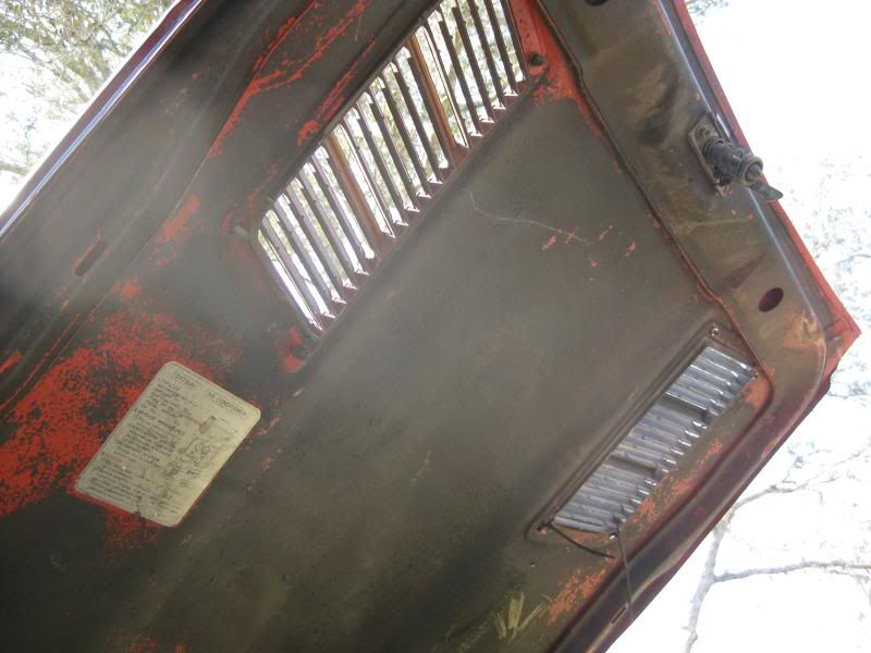

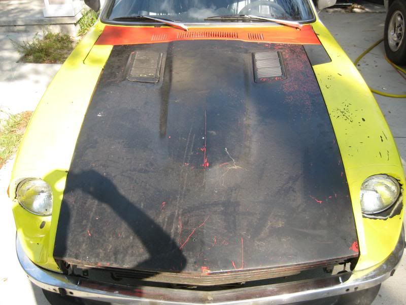

don't know if anyone noticed, but i picked up a MINT 77 vented hood from a 280Z, they're pretty large, and are actually fully functional...
i kind of want some custom fabbed replacement louvers instead of those plastic ones.... DCW?

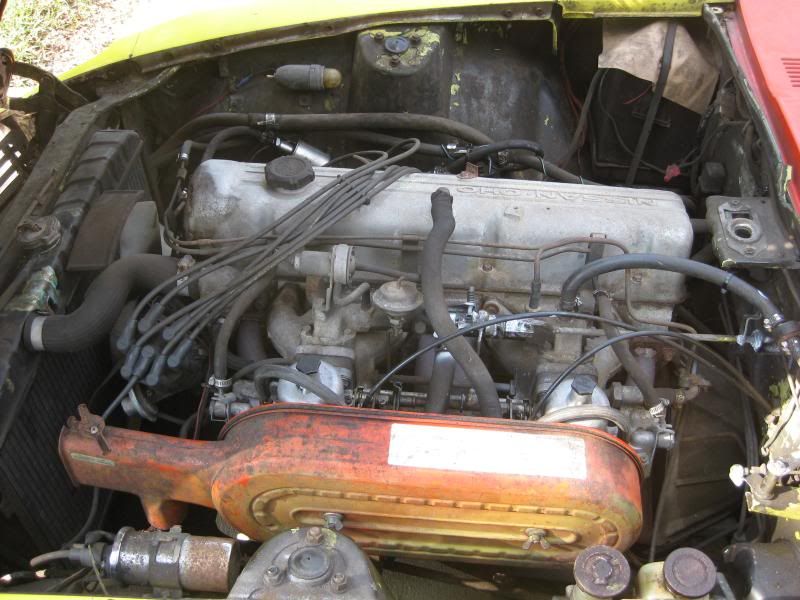

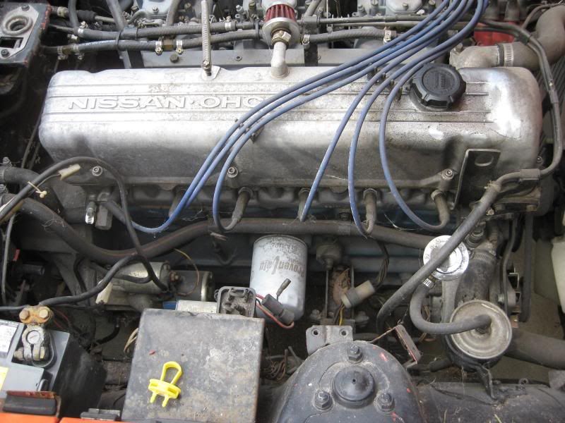

oh yeah, here's the engine bay shot. not sure if i posted one, but it's not much to write home about.... 10K engine, 4K trans, 500m twin SU carbs. Fires up and runs like dream, has a shift kit, medium cam, 6-2-1 long tube header, 2.5" exhaust and a decent muffler, and would prob romp a stock 5spd IHE KA car... other than that, it's pretty weak.

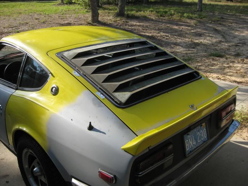

looked in the back corner, and what did i see? OEM 1972 rear window louvers in mint condition (paints fucked, but metal is perfect)... here it is shown without, and with... just picture it flat black...
kinda don't know if i want to run it yet, but it's easily removable/installable within 10 seconds, so some days, some days not. who knows it was $25...

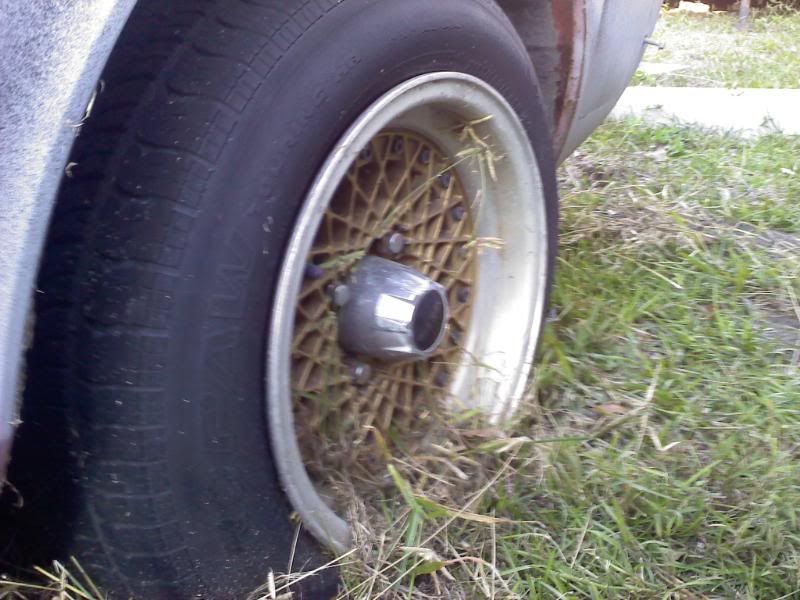

when i go back to tomorrow, i'm going to trade my redneck wheels for these 2pc 14" western wheels...
should look a lot better till i get my permanent wheels that will fill the ZG flares... that and my current wheels are 14" so those brand new tires and be swapped to the meshies... saves money...

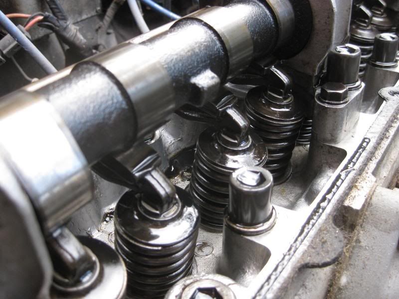

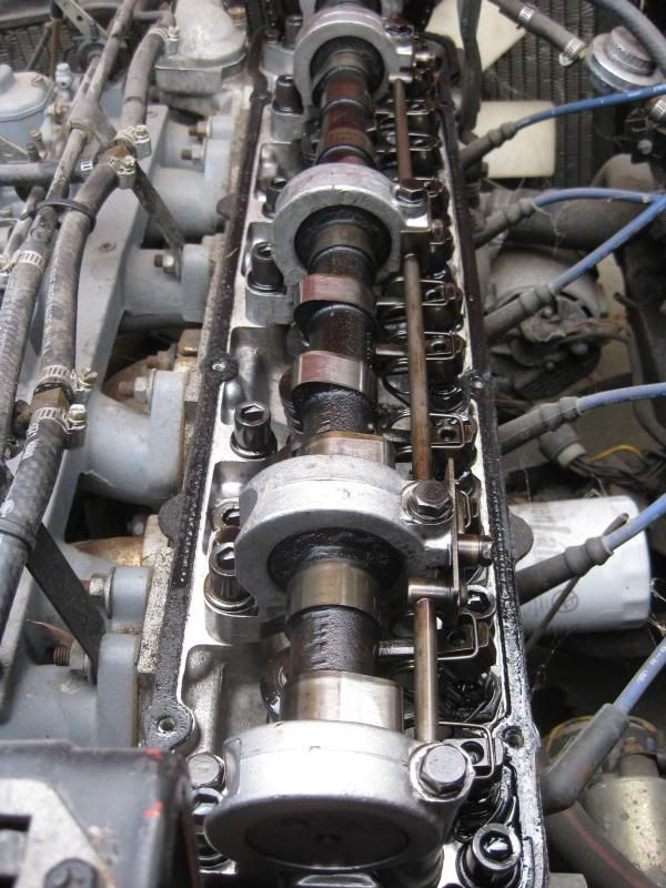

first time ever adjusting solid lifters... simple yet tedious to get puuuuurfect...

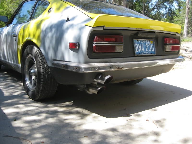

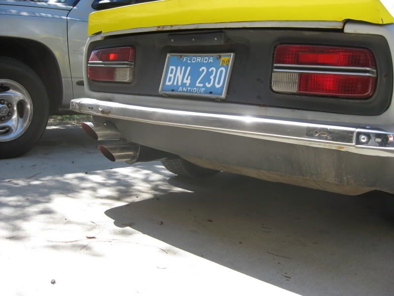

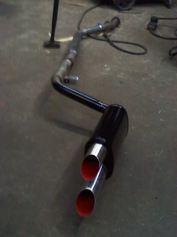

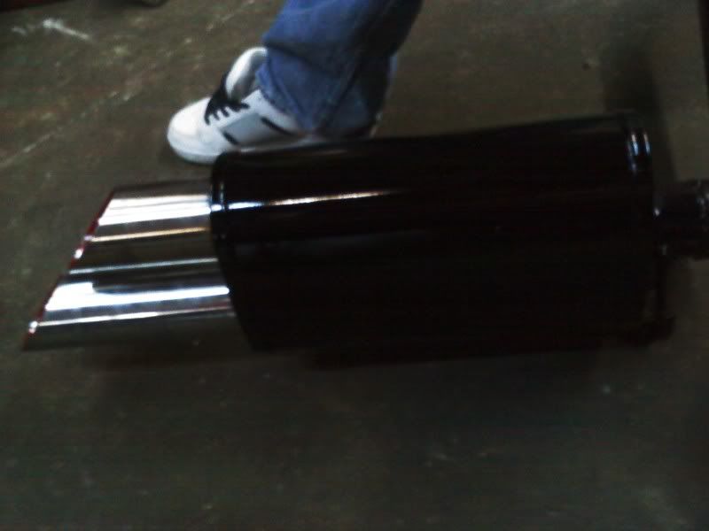

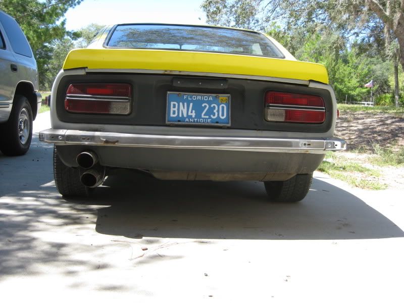

that, and well, i decided it was time to get rid of that resonator in my exhaust, and boy am i glad i did, no pics, but inside the 2 1/4 resonator, the actual baffle was like 1 1/4 diameter, and did this weird snake thing inside... like if you looked in one end, you couldn't even see out the other end, nor if you put a flash light on it could you see ANY light through the other side... WTF?

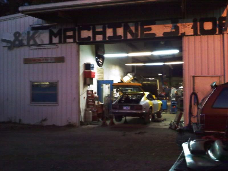

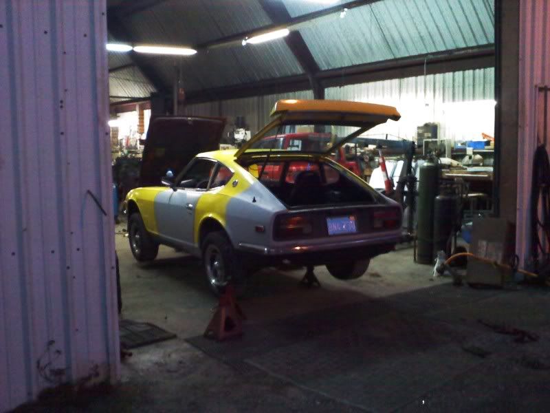

so, after that, **** got crazy at the shop, my buddy (co owner of J&K Machine shop) gave me a single in, dual out stainless magnaflow muffler, and so i ended up fabbing my own exhaust...

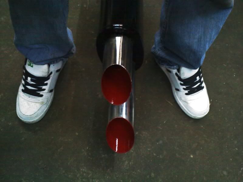

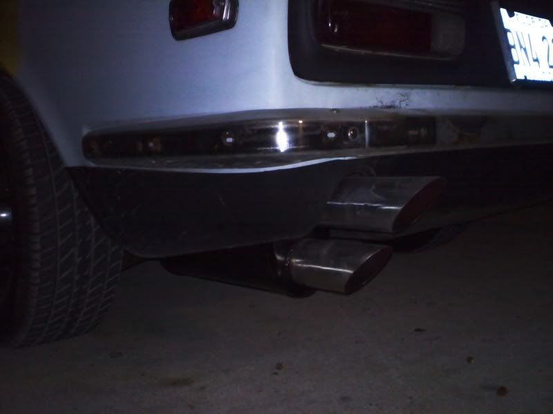

i cut down some truck exhaust tips, welded em on the muffler, and redid my entire header back exhaust... yes, i fab stuff from time to time...
josh painted it for me, was a "present" i was just going to leave it rough stainless...
and he painted inside the tips....
here it is, fully mounted...
i'll get better pics in the day light, but it looks bad ass...
daylight photo's of the exhaust.
other than setting the valves, and fabbing my own exhaust, i changed out all the spark plugs... what a difference the total package made, the car is NOTICEABLY faster, mor response, more oompff off the line...
thanks J&K for access to the shop, and it's eqiupment... they well also be doing all my race head work on my SR that i'll be dropping it... decking, port, polish, multi angle valve job, and some other sekrit sawce...

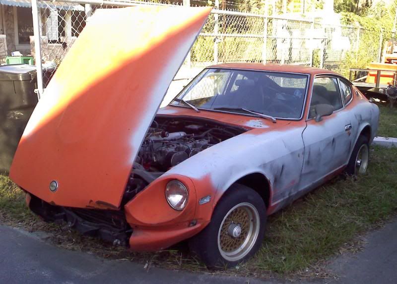

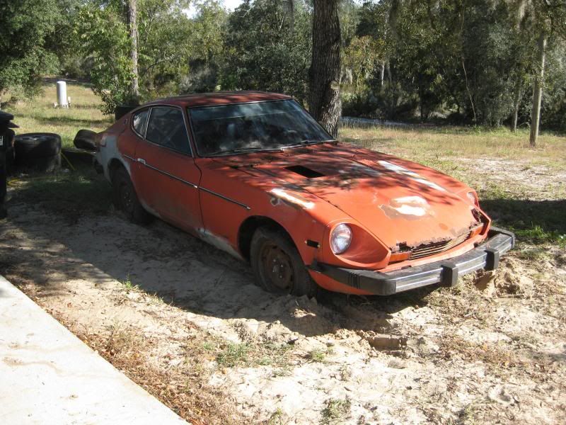

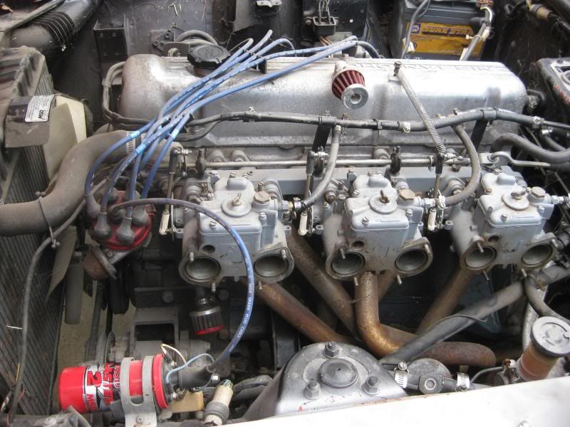

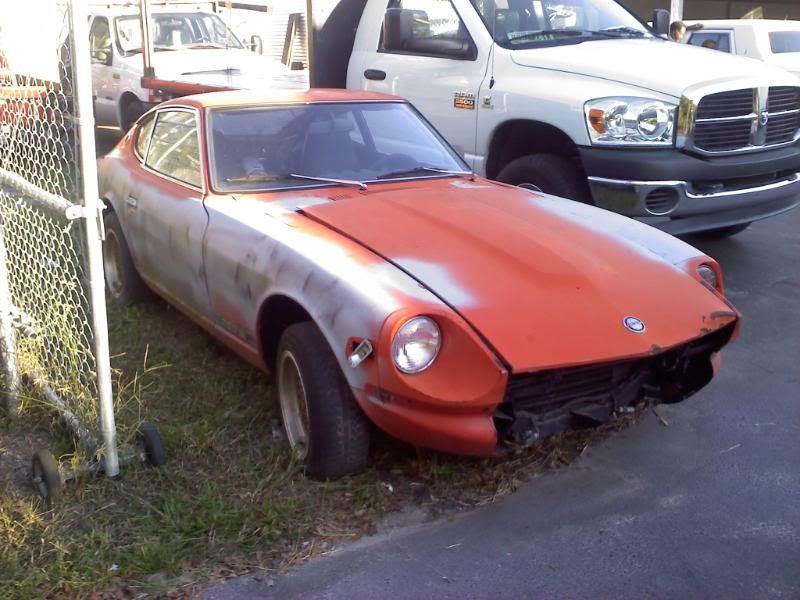

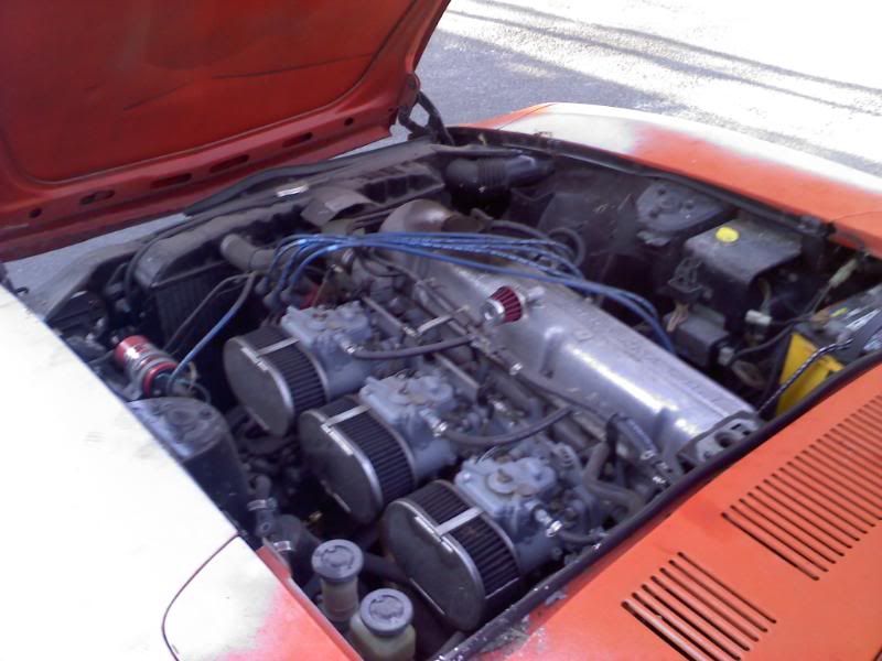

so i picked up two more Z's today, one a 1975, the other a 100% compete 1977 5spd parts car.
the 75 is a 90% rust free car, anywhere, like, what the ****, where's the rust bro? AND comes with a few gnarly parts...

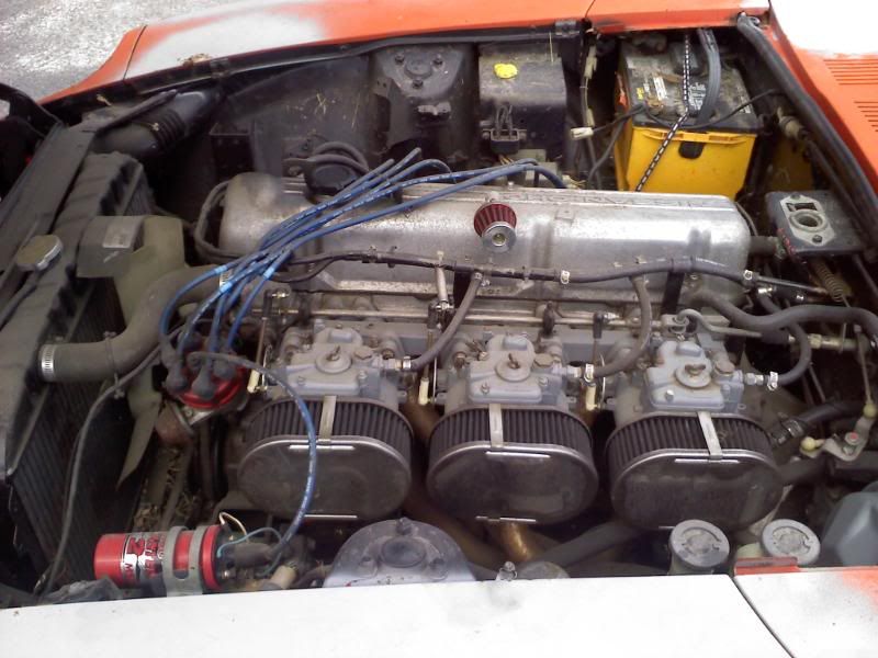

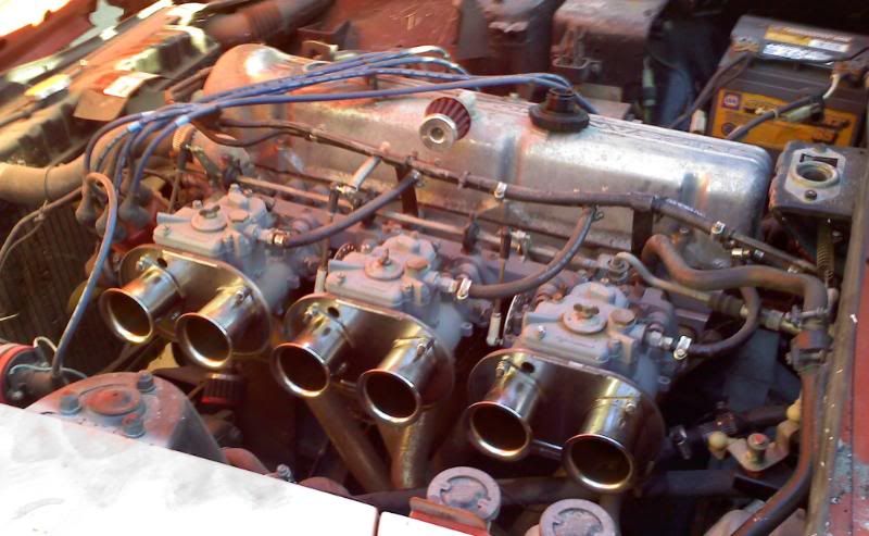

Ceramic coated MSA 6-1 long tube header
MSD elec distributor
MSD blaster coil
NGK wires
built p88 head
built block
new NOS OEM radiator
all new lines, hoses wires
Triple Weber 40 DCOE carb kit
90% RUST FREE CHASSIS!!!!!
original uncracked dash
what a apears to be a built/rebuilt 5spd trans
working AC!!!!
who know's what else!?

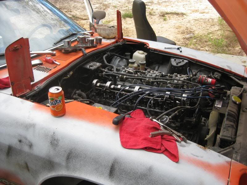

in the trunk is a pile of NOS parts, still in boxes, including an upgraded P90 head, with fully polished valve cover, and the HIGHLY coveted N42 head that's still wrapped in machine shop plastic in a 15 year old machine shop box, looks like it was just serviced. Not to mention numerous other resto parts, including 15 year old paint haha.

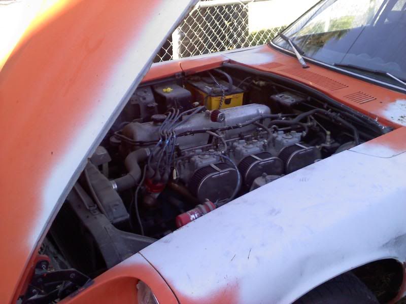

someone put some SERIOUS money in this engine, and although it has a layer of dirt/dust from sitting since 08, the engine is fresh painted blue, the head, a bright aluminum, polished valve cover, and powder coated triple weber carbs that go for almost $1700 for the kit.
the parts car, well, it's that. a parts car. it's a 77, original 5spd, complete L28 engine that looks as if you throw some fresh gas in it, a new batter, it'd crank right up... some decent rust, but panels/glass/interior pieces are near mint...
here's the photo's...

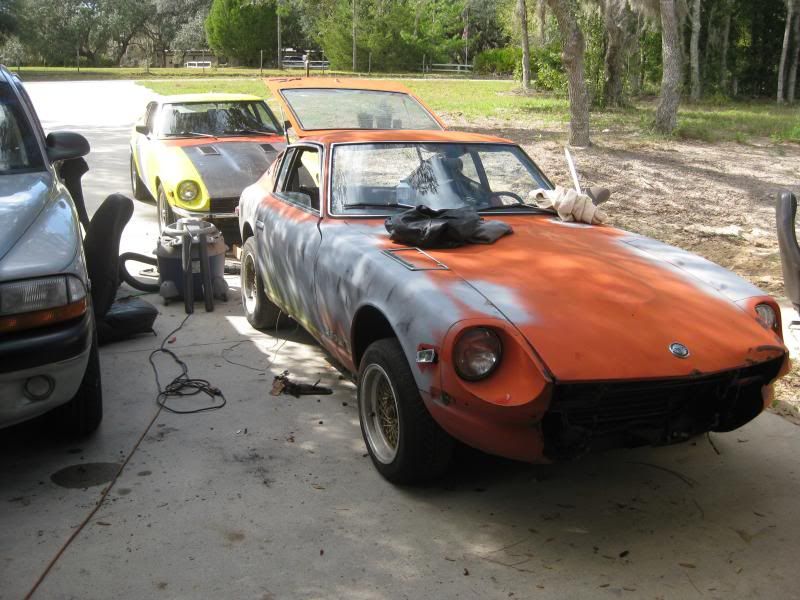

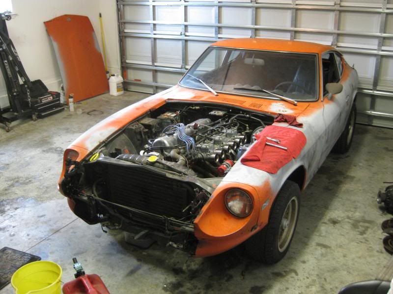

after turning some serious wrenches tomorrow, it shall be a good day when i get the new one to fire up after sitting for a year and a half...

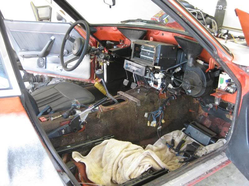

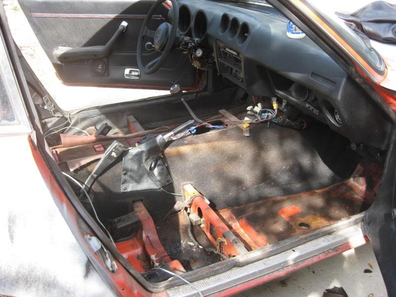

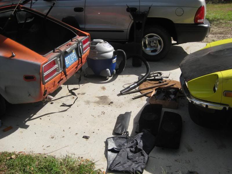

getting ready for tear down...

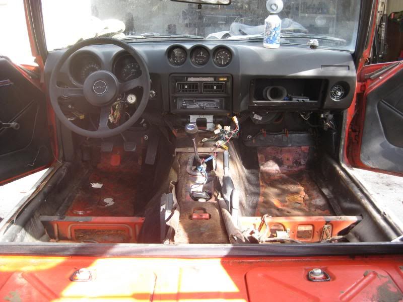

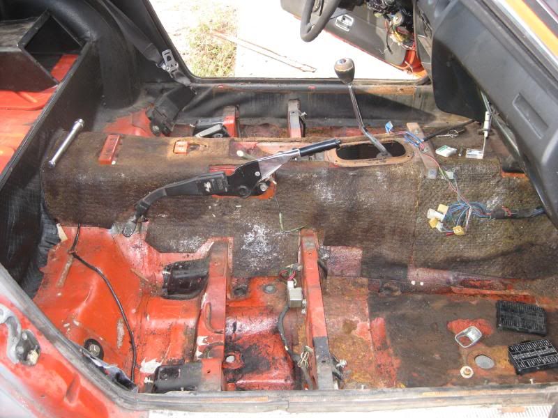

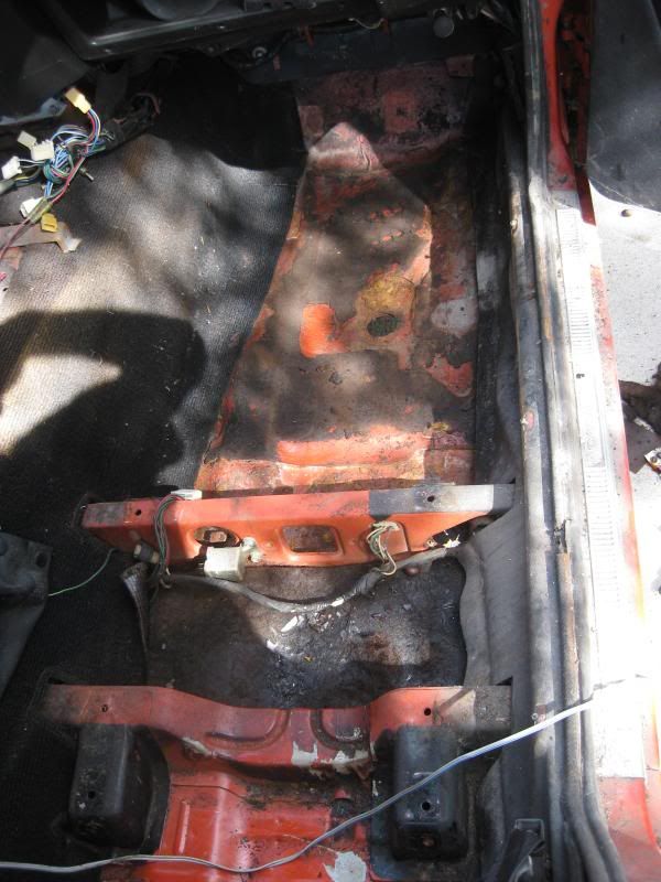

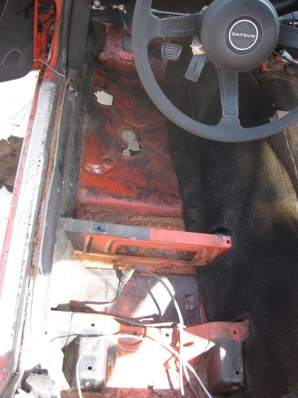

getting interior pulled out...

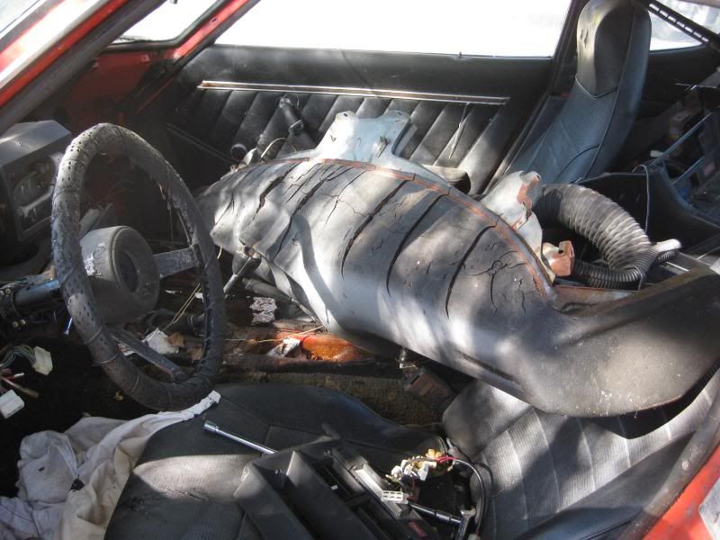

holy grail of Z cars... unckracked original dash, people pay $1K+ for these.
random **** from the trunk...
coveted N42 head (pretty much race ready from factory), and a good street/strip head, the P90A, and a freshly polished valve cover, +1.5 for great extra parts...
while getting the AC/heat working, i forgot the fuel lines leaked from 3986573 places, and the car peed a lot on the driveway...

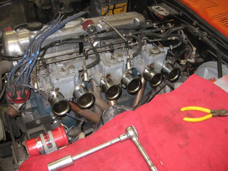

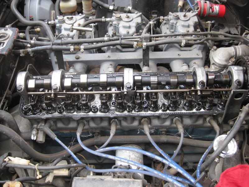

motor shots... "it may not look like much, but it's got it where it counts kid"

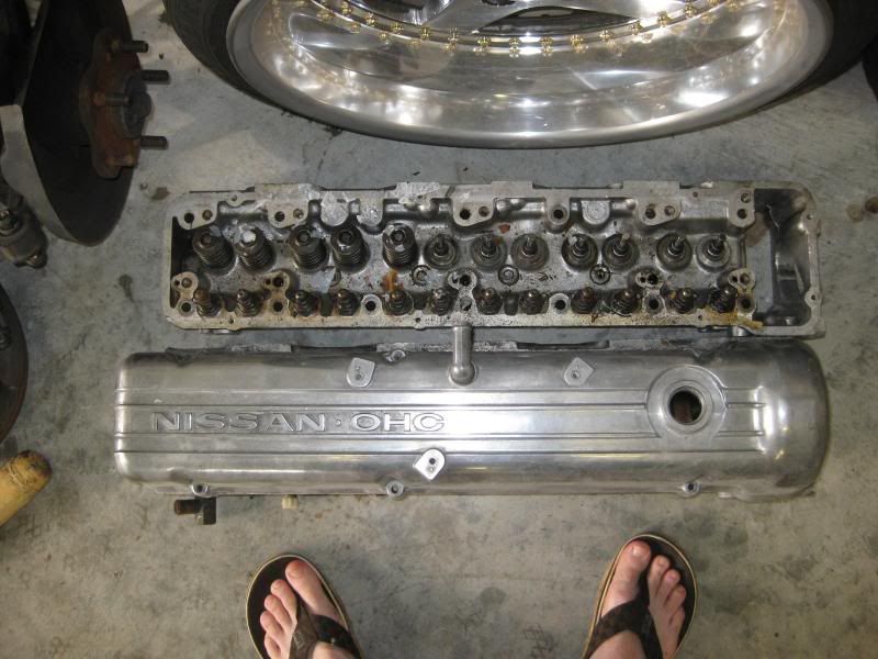

i wanted to swap out valve covers, and use the polished one, was awesome surprised at the cleanliness of the motor/head...
minty...
ooooooooold school...

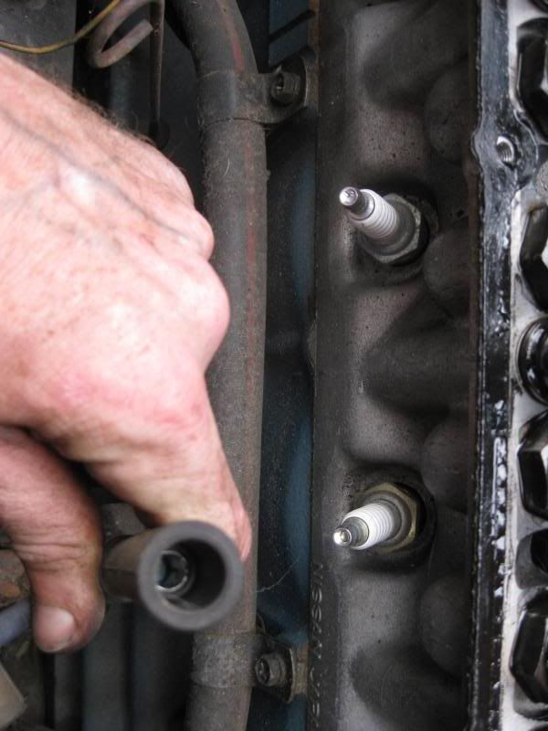

as a testament to the freshness of everything on this motor, check out the plugs and wires, besides the dirt from sitting for so long, they look like they were put on/in yesterday...
welcome to my office...

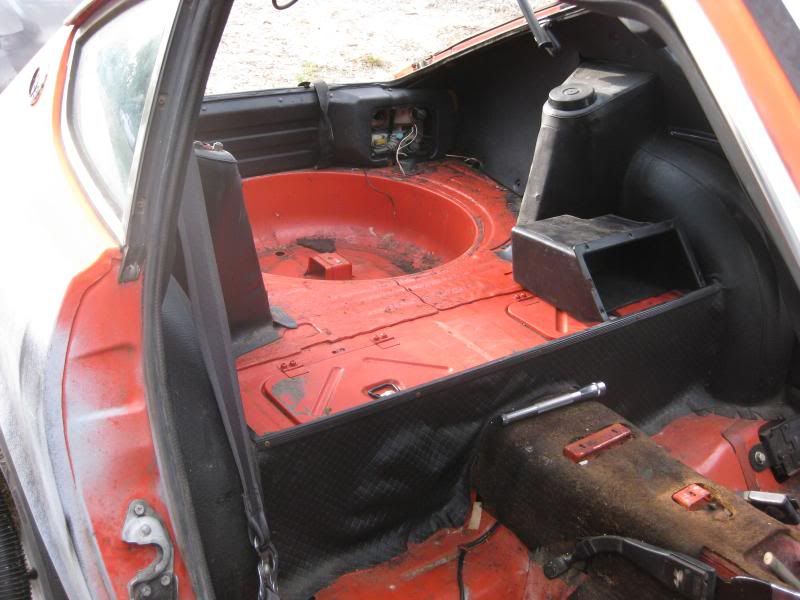

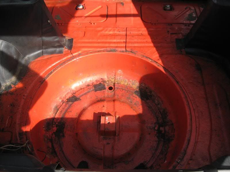

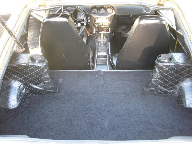

rear hatch area cleaned up, see the built in tool boxes/weed storage areas? sickness...
time to order new carpet sets now i got all the old **** yanked out and thrown away.....

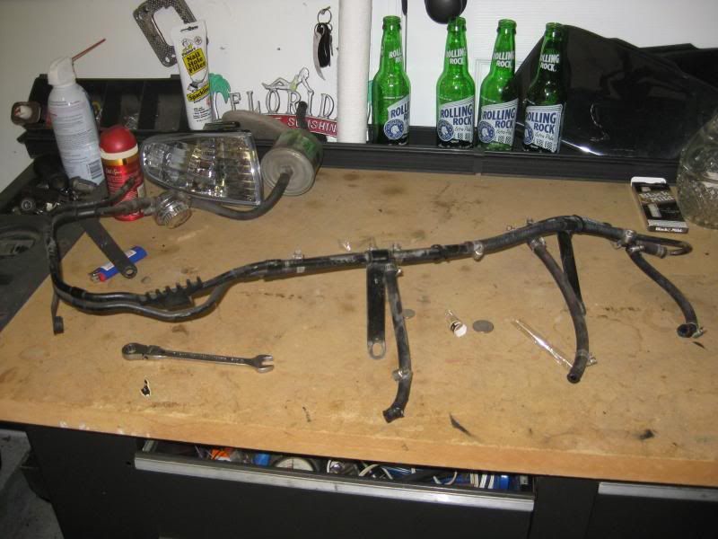

old "fuel rail" with adj FPR, and Z32 fuel filter that leaked from 9345873495783 places (mostly where all the clamps are)... we swapped out all the lines on the rail, and the 23949872 leaking hoses from the gas tank forward... this is OLD technology, i love it.

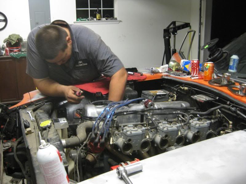

my buddy josh, owner of J&K Machine shop came over and lent a hand...

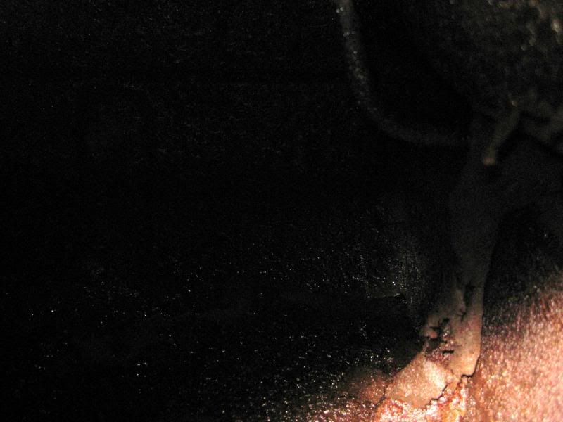

further inspection found that the fuel tank was fouled up... tomorrow it's going to butler radiator for servicing.

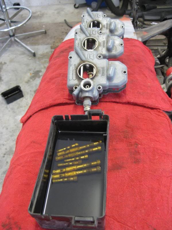

so, while i was on the topic of gas and ****, i figured I'd break down the carbs a bit, and service some parts, individual carb fuel filters, jets, etc etc.
pulling it apart...
soaking in seafoam in a S13 fuse box lid, then blown out with compressed air...

did some research, that's a $600 header....
all buttoned up, new fuel lines/rail, filter, waiting on a rustless gas tank.

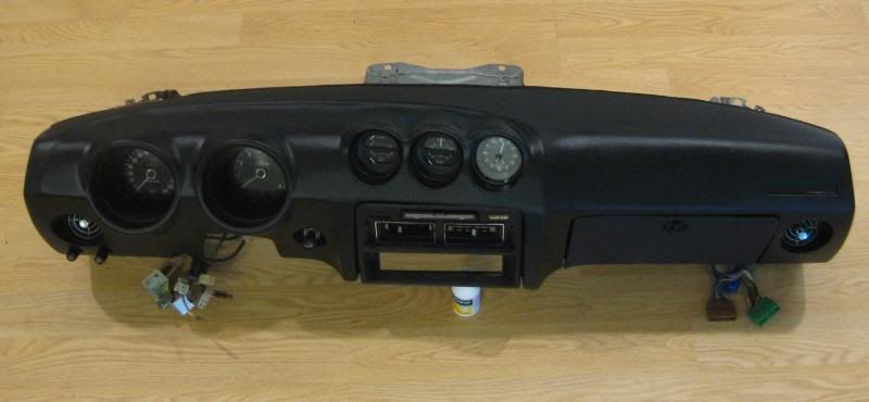

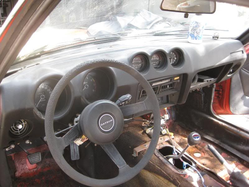

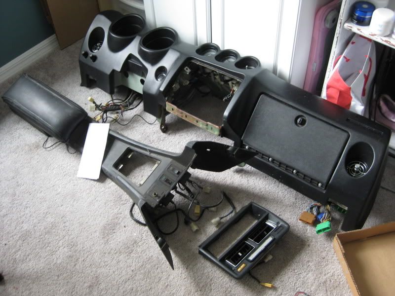

SO, dash works in progress...
none of the lights worked in the 75 dash (current focus car for build), because the bulb to socket contacts are just ******* old, and i didn't like the condition of the dash (uncracked, but still "sunburnt").. so i pulled it out, treated the sunburned dash, and ordered 10x 5 SMD LED bulbs in red for the gauges/AC panel/glovebox... stock lighting is this pale green, and VERY dim... so i figured the red LED's should prove bright enough, and not impair night driving at all.... if it's still not bright enough for my tastes, the i'll be fitting a full barrage of Autometer gauges to replaces the stockers (AM's pretty much bolt right in!!)
anyways, here's the dash... Z guys would flip **** to have this dash, they go for around $1,000 in this condition...
holy ****, what a mess!!!
still a lot better than the parts cars dash!

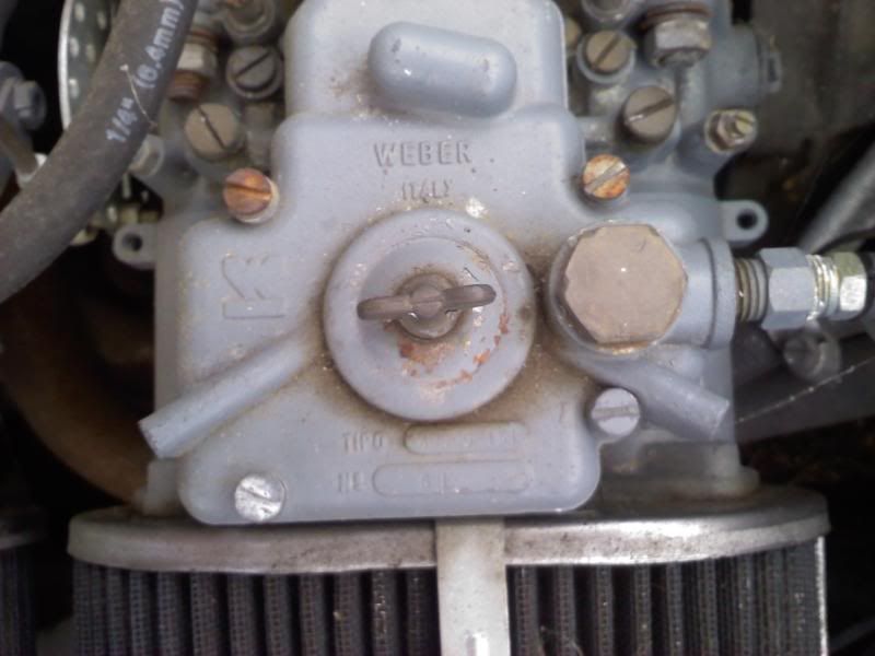

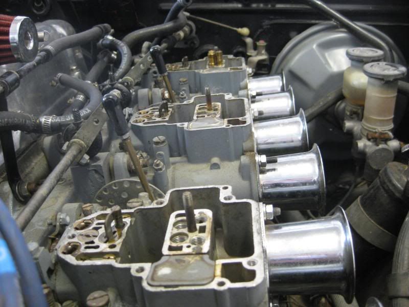

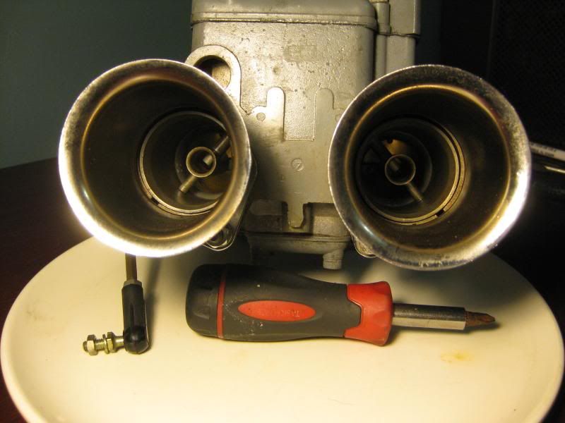

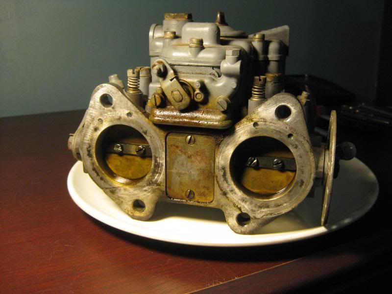

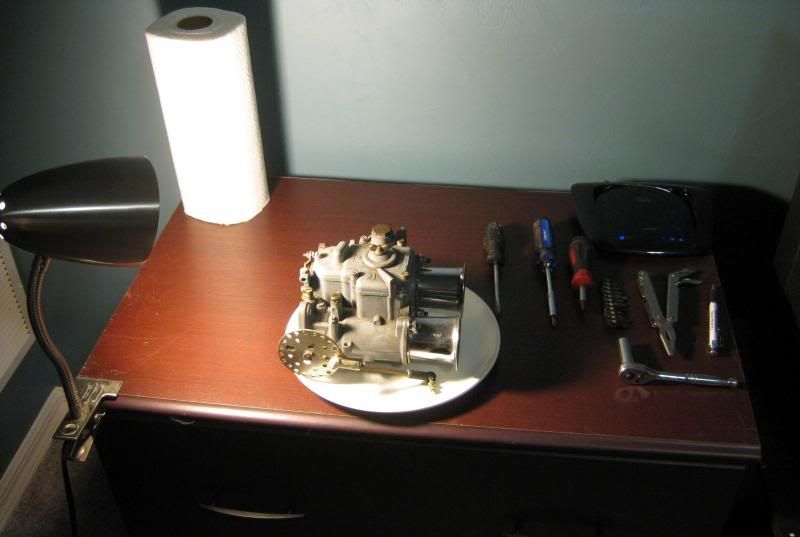

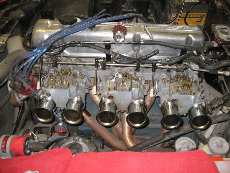

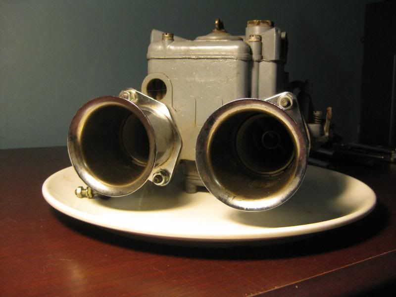

ALSO, i decided to get into my carbs to figure out what jetting i had in there, to match up to the motor with proper jets (if needed), come to find out after research, these Weber carbs, like everything else, are also hopped up...
work station....
inlet side...
30mm choke, 45 aux venturis..
outlet side, deff needs some cleaning/refreshing...

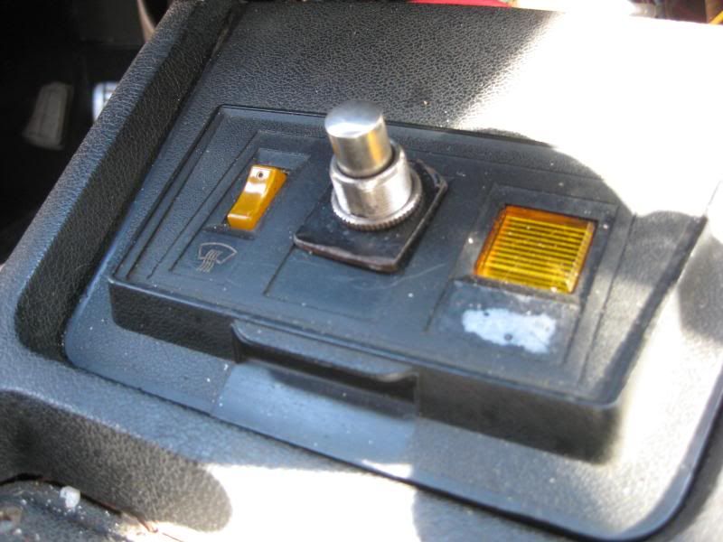

i didn't really like the redneck/halfassed push start in the yellow car....
so i ordered a Pivot unit from the motherland to replace it...
can anyone read japanese? all the instructions are in jap.

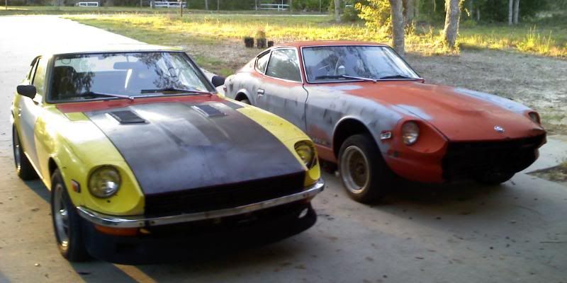

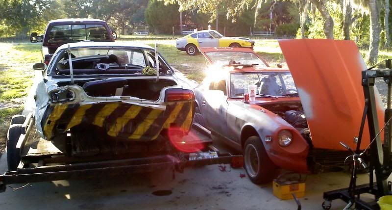

here's the third Z by the way... the rusted out parts car... still a ZILLION things i can use off it, so at $400 it was a good buy...
be sourcing a LOT of **** out of this car, high pressure AC system (vs low pressure system in the 75), intior bits, head light buckets, fender etc etc etc...
also might be picking up this cartech triple carb turbo manifold...
not a very efficient design, but it's hyper rare, and i can run low boost to the L28E... all other parts would be OEM 280ZX turbo parts (manifold, turbo elbow/outlet etc etc etc), I'd have to fab my own piping, FMIC/MMIC etc etc... but it would make for a bad ass period correct turbo kit that the OG jap guys ran back in the day.
will be finding out about the Cartech later today if it's mine or not...

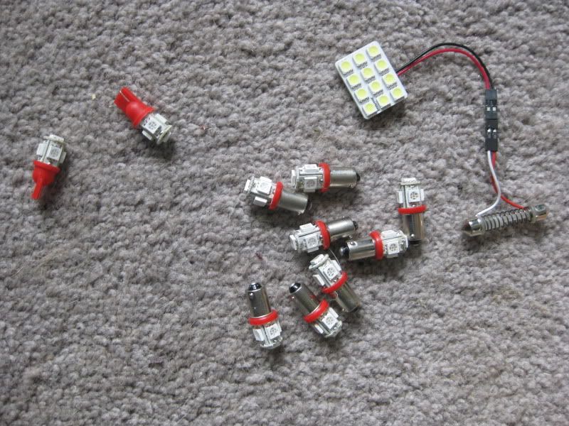

But lo, there is SOME progess to be made. my LED's came in from Hong Kong so i can finally get working on my dash...
feels good to be making progress...
push button start is now installed (was going to put it in yellow car, but i felt it should go with the uncracked dash in my 75 orange car...

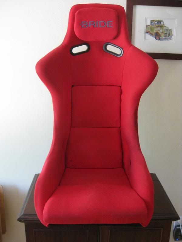

so that's pretty much it for now, till i order the carpet kit, and fit my bride seat in the car...

also, as a treat, i pulled the spart plugs, looks like the F54 L28 is fully built with billet pistons... WOOOOOT! i want to pull the oil pan off to see what crank i have in there, might be a pleasant surprise!!!!
