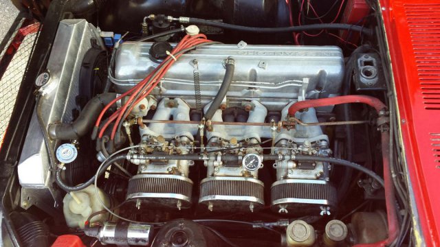

JGREEZY Posted November 12, 2014 Share Posted November 12, 2014 I'm considering on doing this swap in my 72 240Z, i'm just about to jump in, not sure if I'm going to pay a shop, or try and tackle it. before I buy the engine, I hope some of you guys that have done the swap can give some input. like should i try and find a non-vvti engine, what type of problems does the vvti engine pose, over the other. Also my car is manual transmission now, what would it take to convert to auto the manual trans cost as much as the engine. here are some pics of the car now Quote Link to comment Share on other sites More sharing options...
grayson260z Posted November 13, 2014 Share Posted November 13, 2014 I myself picked up a Non VVT-I 2jzge from an sc300 and plan on boosting it a little later down the road. With this you can easily just use the sc300 ecu and such or from what I've heard/read swap out all of the electronics with a 7mgte harness for a "plug and play" application. Notice the air quotes Quote Link to comment Share on other sites More sharing options...
devil280Z Posted November 14, 2014 Share Posted November 14, 2014 For everything I've read, most people don't like the VVTI because its a little harder to tune. As long as you can find a good tuner near by its a much better motor. Get your torque at lower rpms, runs smoothing and much more fuel efficient.. Downfall is after market. If you want to stay south of 500hp not a problem got vvti, if you want a huge HP motor than got GTE. Either way great motors!! Quote Link to comment Share on other sites More sharing options...
Ryan Merrill Posted November 14, 2014 Share Posted November 14, 2014 Why can't you go over 500 hp on a 2jz GTE vvti? We have numerous cars running close to 6 in the area using the aristo engines. Quote Link to comment Share on other sites More sharing options...
