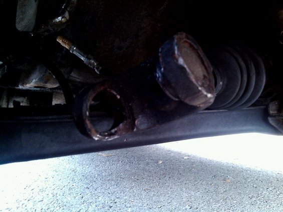

wfritts911 Posted April 4, 2012 Author Share Posted April 4, 2012 Well I probably would have got one today, until I pulled out of stop sign and got on it, shifted into second (Not even that hard, might have been the problem, maybe I let the drivetrain get a little slack), and what happened next sounded about like "Clunk! Bang bang bang." I get out of the car, halfshaft is no longer connected to the stub axle... LS1 + Monster Stage 3 clutch (They weren't kidding when they say this clutch will find weak links in your drivetrain. So far its killed a 10 bolt, a U-joint/8.8 Driveshaft Flange/F-body driveshaft, and now the half shaft). Sheared the outer U-joint on the drivers side, taking the half shaft along with it. Bent the U-joint ear on the yoke up pretty good. Just got one photo below courtesy of FlatBlack. Fortunately I will be pulling another half shaft off a parts car tomorrow from a buddy so I should need towed home. On a depressing note, I had to have my buddy's V6 mustang tow me back to his apartments (The place I ended up at wasn't in the friendliest of places). On a happy note, I got an electric fan that Mat was nice enough to give me wired up today, no more worrying too much at stop lights hehe. I promise more pictures of the actual build process and the car as a whole will be coming eventually along with driving videos. -Will Quote Link to comment Share on other sites More sharing options...
FlatBlack Posted April 4, 2012 Share Posted April 4, 2012 On 4/4/2012 at 4:43 AM, wfritts911 said: Just got one photo below courtesy of FlatBlack. Where did the watermark come from? lol I'll be up at the shop today if you need me to grab anything, but I don't have tools with me. Quote Link to comment Share on other sites More sharing options...
wfritts911 Posted April 4, 2012 Author Share Posted April 4, 2012 I use supermotors to upload photos, so thats where the watermark came from. And I am going to try and swing out there later to show Jesus the car if I get it driving before dark. -Will Quote Link to comment Share on other sites More sharing options...
