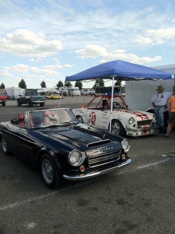

Oh, but it did indeed ! It was awesome fun. It made a car that already felt like it was on rails come even further alive. Also...I've never thought of this cars build as anything more than a spirited daily driver. Never meant to break any records of any sort. I was pleasantly surprised however how well it hooked from a dig. I thought it did well previously with just the addition of 10" wide wheels.
