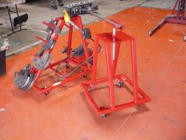

fast-datsun Posted March 31, 2012 Share Posted March 31, 2012 JD2 is great I got one of the first ones and still use it here are carts I made to make it portable... Quote Link to comment Share on other sites More sharing options...
proxlamus© Posted April 1, 2012 Share Posted April 1, 2012 Be advised.. you can only use the JD2 on a rolling cart, IF you have a hydraulic ram. Which just adds more money to the total investment. Using the hand mechanism requires the stand to be bolted to the floor. Keep that in mind. Quote Link to comment Share on other sites More sharing options...
robbs70z Posted April 1, 2012 Share Posted April 1, 2012 On 3/31/2012 at 10:18 PM, fast-datsun said: JD2 is great I got one of the first ones and still use it here are carts I made to make it portable... Very sweet setup!!! Quote Link to comment Share on other sites More sharing options...

fast-datsun Posted April 2, 2012 Share Posted April 2, 2012 if you shop around you can up grade to air/hyd for a reasonable cost if your going to do alot of bending. its easier to hit you marks. Quote Link to comment Share on other sites More sharing options...
