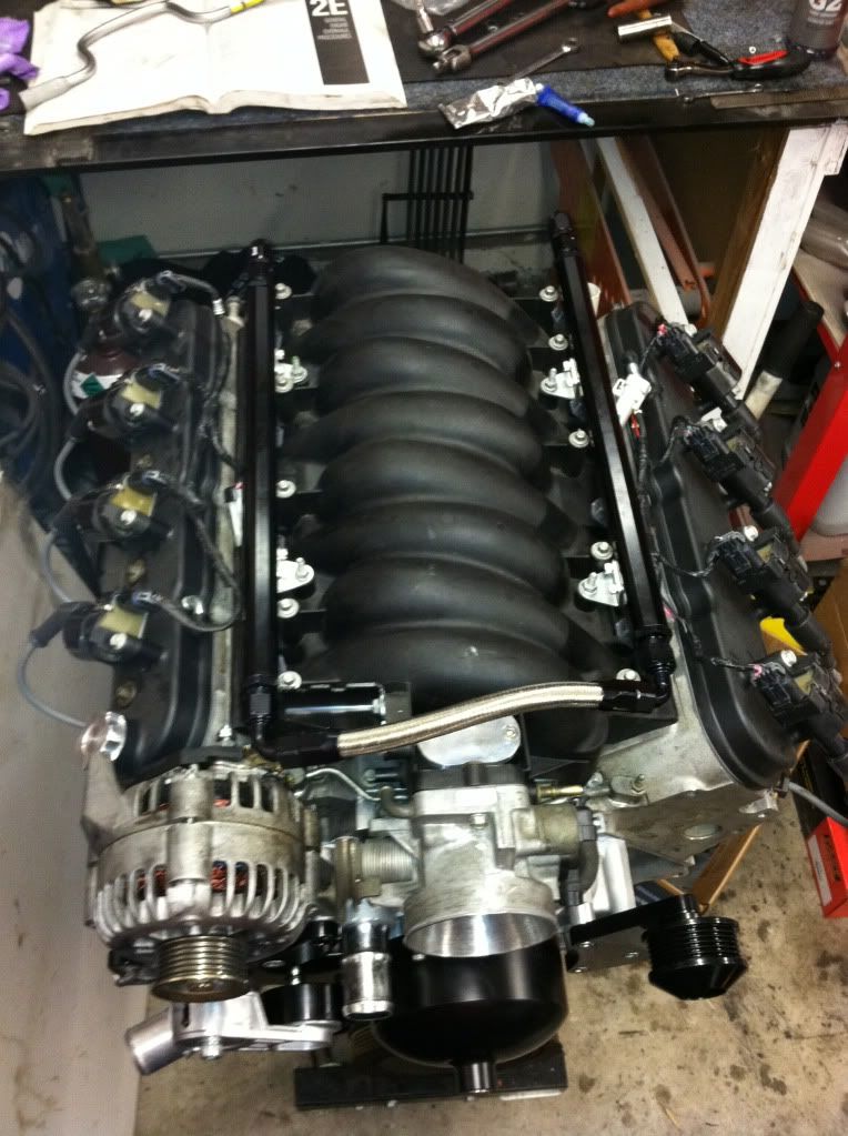

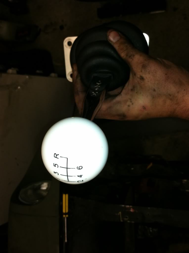

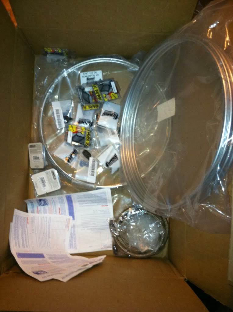

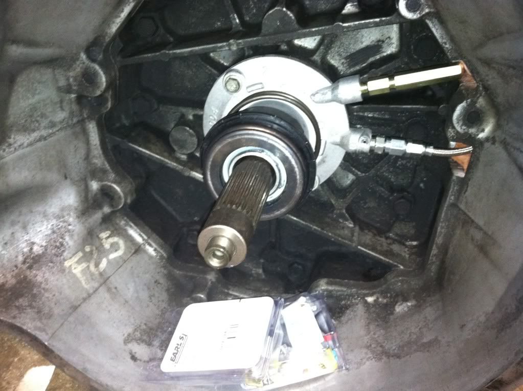

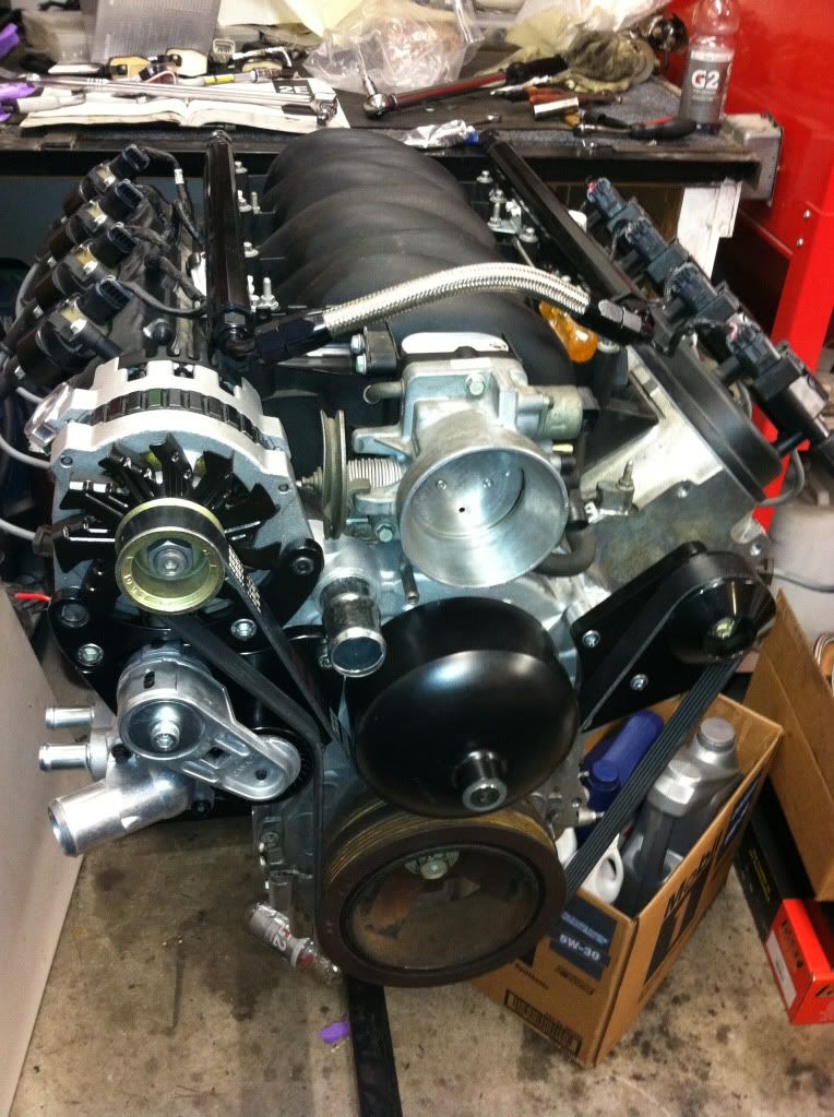

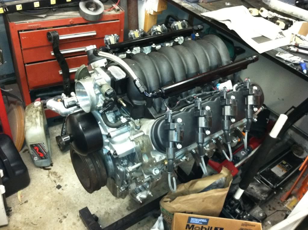

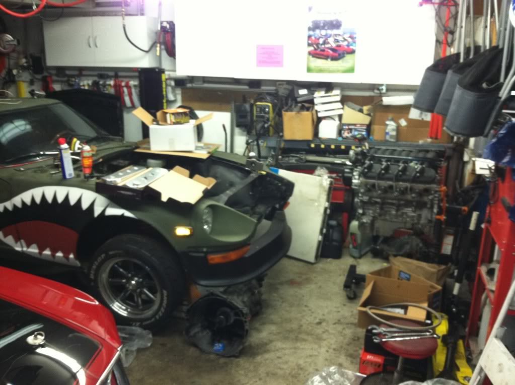

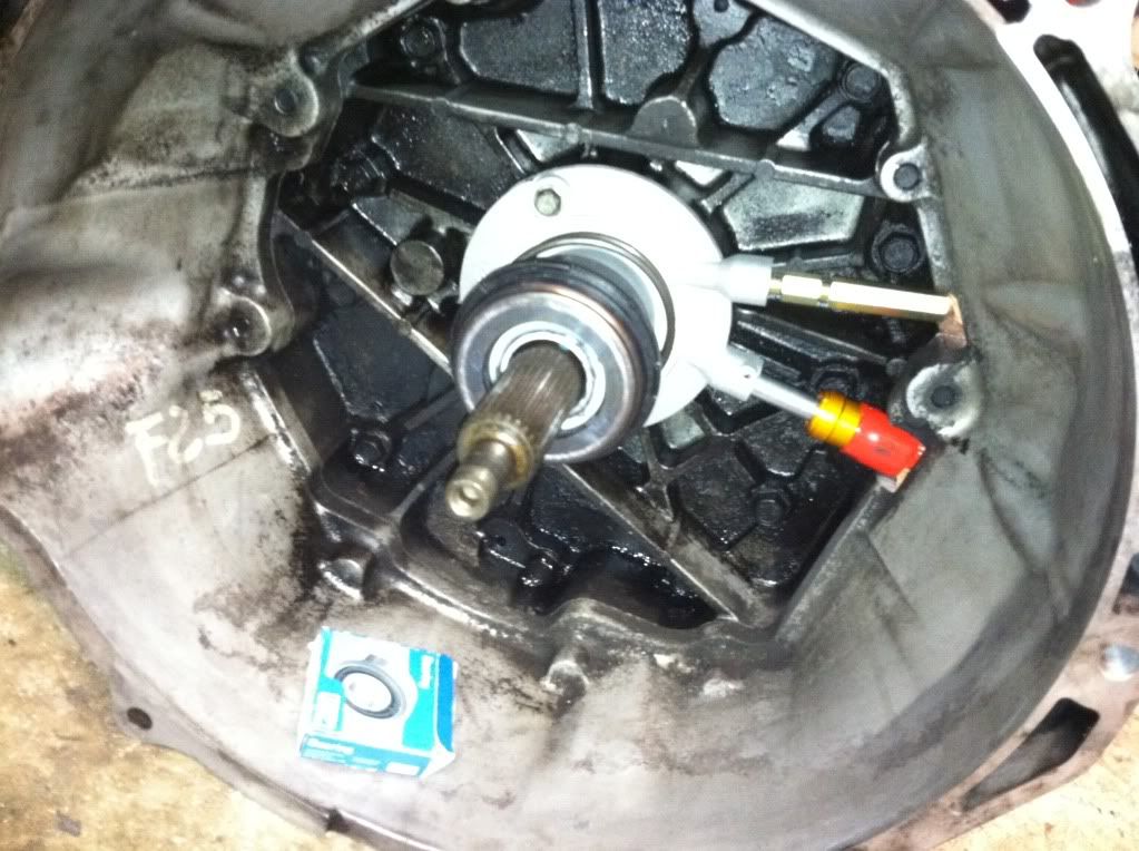

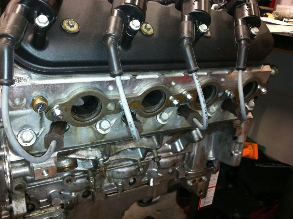

Fuzzydicerule Posted May 10, 2012 Author Share Posted May 10, 2012 (edited) Also, i was gonna post a bit of an update last night, but i passed out from exhaustion The rest of my fuel system crap showed up, as well as my water pump bolts and exhaust flanges Got a bit more work done on the motor, got my front fuel crossover in, as well as some very pretty looking Holley valve covers. Exhaust flanges and my cheap-o Spark plug wires. Ill probably change those out eventually New slave and TOB on WFritts suggestion. cleaned the bellhousing a bit (the front of the trans was being a beezy so i gave up on it, i dont care enough... My crowded as hell garage and my bag o bits any my old school white knob, it wont go with my interior at all, but whatever. LASTLY, Anybody interested in these? theyre a set of nameless Fabricated aluminum valve covers. they are very pretty, but they dont have coil mounts or breathers, i was going to use them but then i acquired the holley VCs and decided to use those Edited May 10, 2012 by Fuzzydicerule Quote Link to comment Share on other sites More sharing options...
SUNNY Z Posted May 10, 2012 Share Posted May 10, 2012 (edited) I would look into doing a remote bleeder on the t56 slave - It will make your life easier in the future. Looking good! and on the stub axles, i'm at the mercy of chequered flag joe. As soon as they're here, it'll be shortly after that they're available Edited May 10, 2012 by SUNNY Z Quote Link to comment Share on other sites More sharing options...

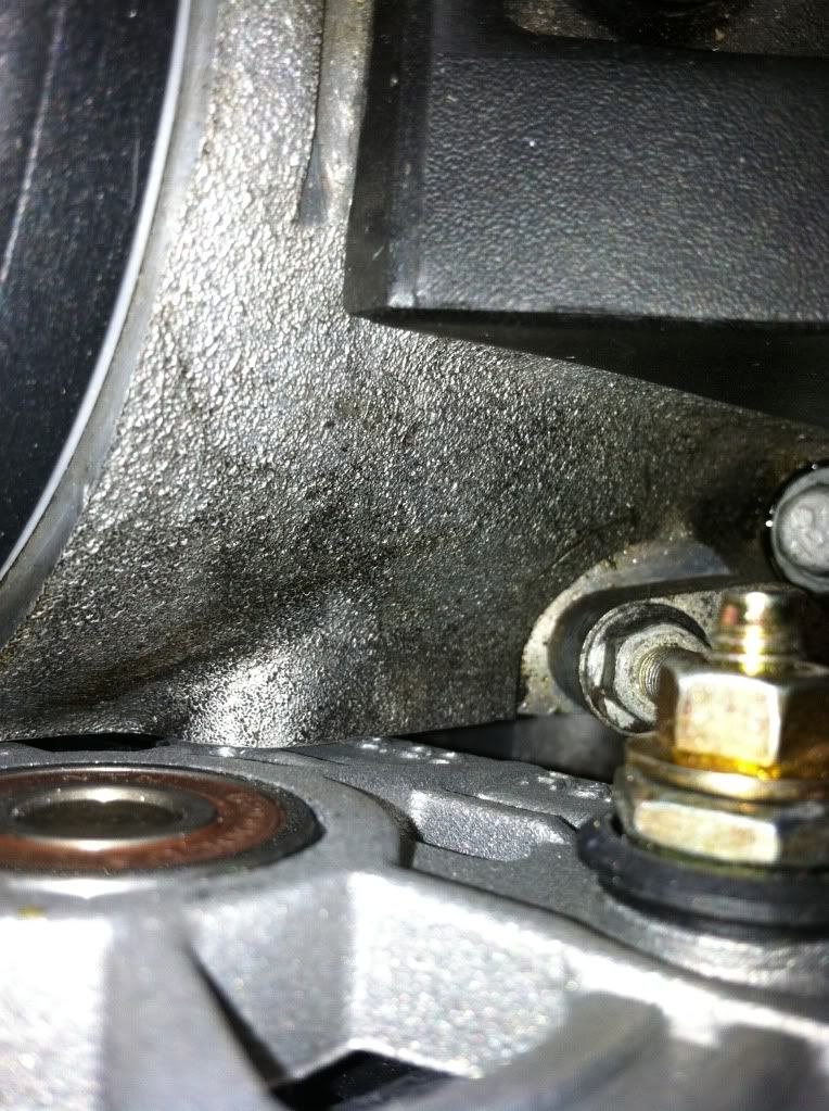

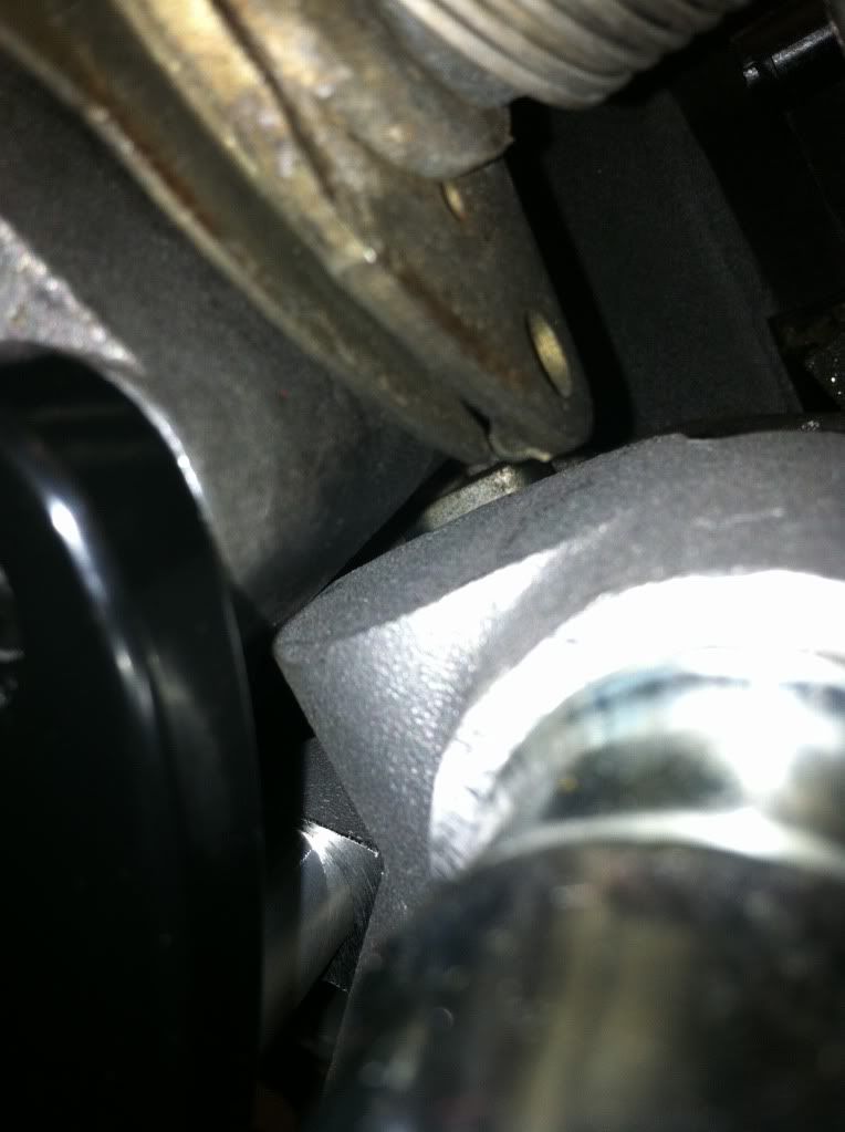

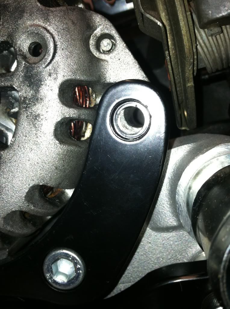

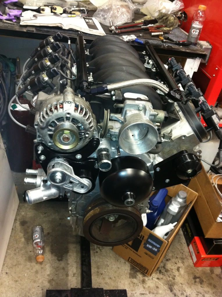

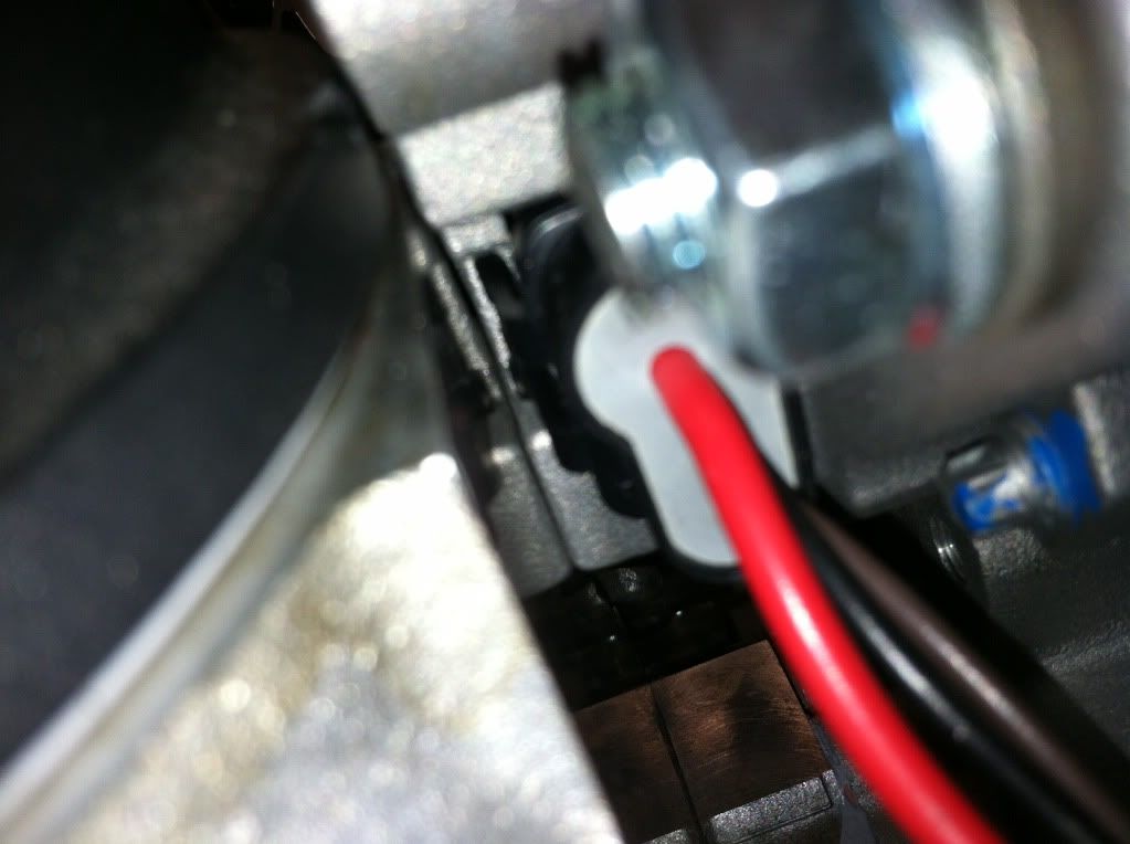

Fuzzydicerule Posted May 14, 2012 Author Share Posted May 14, 2012 I won't really mind if I have fitment issues, I have the capacity to alter the mount Anywho, I am currently 3 alternators and 3 belts deep into getting this high mount kit working. The avalanche alternator was an identically terrible fit to the f body alt( hit the boss on the water pump and te lead were way too close to the head, so a work today I spent half an hour looking through my alternator lookup and out of 30 or so that looked promising, I had one in stock, an Alternator from a 94-96 Buick skylark, and after grinding off a useless boss on the back and trimming the plug, it fits, just barely but it fits. As far as the belt, my original estimate was a smidge too short and I overshot on the second, hopefully the in between will do the trick Quote Link to comment Share on other sites More sharing options...
Fuzzydicerule Posted May 14, 2012 Author Share Posted May 14, 2012 Belt Number 3 works damnit, Its a 63 3/8 belt, and was still difficult to get on, but once i realized i should to the WP last it slipped right on... Im a big fan of how this turned out, i just wish the company would have provided more information on how to get this bracket to work The back of the alternator is all but touching the head, luckily with this alternator it is the case of the alternator, not a power lead like on the F body and Truck alternators that i tried, all it required was grinding down an extrusion on the back and cutting the pry bar on the electrical plug and it slipped right in. The plug is on the underside, the downside is that i will have to remove the alternator to undo it (which is two screws and taking the belt off, so its no biggie) The upside is that all the wiring will be damn near invisible Quote Link to comment Share on other sites More sharing options...
