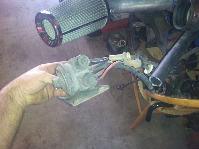

What part of the harness are these two connections
ryan95i4
vacuum pump/EGR/A/C(idle kickup) controller.
Question to be asked is: Is this device ECCS(ECU) controlled or controlled through external sources?

Ray,
Both of those devices are controlled by the ECU. I just went through my L28ET swap. My advice, keep both of them, EGR is a good system that does not hurt performance.

AAC valve is what controls the idle speed. This system only works when the throttle switch is closed. The other device, the air regulator can be done away with.
What do you mean by MPG hike at cruise?
EDIT: The other device shown in the pic is the EGR vacuum modulator. I was referring to the other device on the intake manifold that controls air flow into the manifold.
