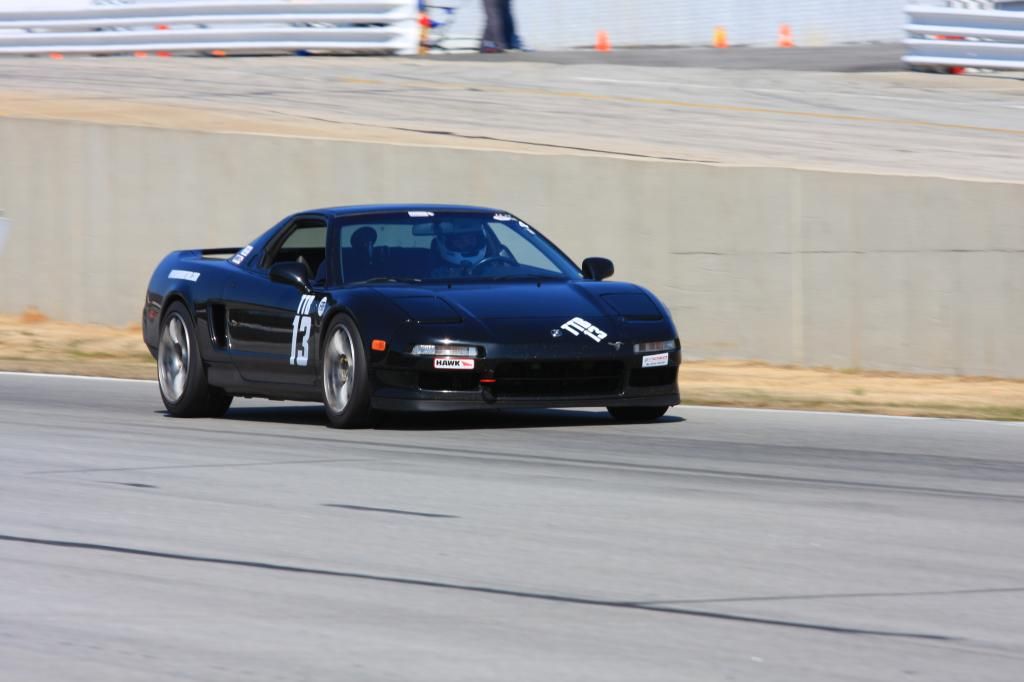

Wheelman13 Posted June 30, 2013 Author Share Posted June 30, 2013 (edited) I've also been busy with the other car. I chalked up a TT win on my second visit to CMP in February, and then made some progress lowering my personal best at Road Atlanta (even though it wasn't enough for a podium with a deep field of really fast cars/drivers). At Road Atlanta: Some video of my quick lap on the weekend: Currently, she's developed a taste for left-rear wheel bearings, so I'm in the midst of digging for the root cause there, but hope to have the car back up and in rude health soon. Edited June 30, 2013 by Wheelman13 Quote Link to comment Share on other sites More sharing options...

Mikelly Posted July 27, 2013 Share Posted July 27, 2013 Just watched your track videos... Well done man... Greatly enjoyed them! Zcar is coming right along! Mike Quote Link to comment Share on other sites More sharing options...
Wheelman13 Posted July 30, 2013 Author Share Posted July 30, 2013 Just watched your track videos... Well done man... Greatly enjoyed them! Zcar is coming right along! Mike Thanks much, glad I could help kill some time. I need to get back out to a track, but the NSX has been having some electrical gremlins. Typical Honda FI main relay issue and I think an open wire to a blinker of all things . I've nearly got them sorted again, but my time's been getting stretched thin. Quote Link to comment Share on other sites More sharing options...
