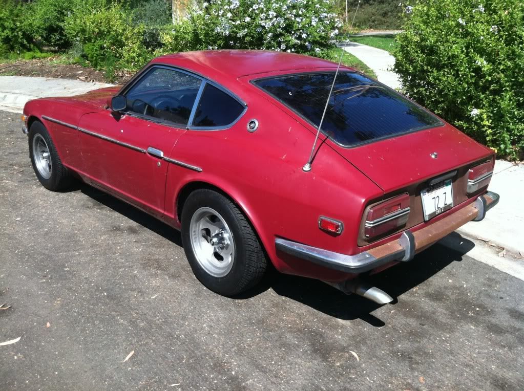

Hey guys, I finally succumbed to my problem, and i picked up another 240z.
The name comes from an old joke with my parents, my dads old 280z was Maroon, and they refer to it as "old purp" and when i got this one home, my dad mentioned that it was the same color, so i figured its fitting.
Ever since i got my green car running, ive realized im not really into that straight racecar thing, and the shitty ride nonexistant interior got old almost immediately. I decided i wanted to pick up a nicer shell than what i was dealing with. The main reasoning was some frame damage and the fact that its been punted a few times...

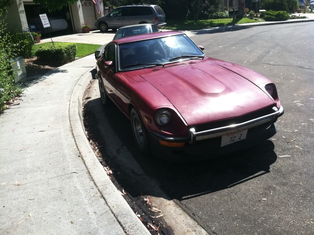

I found this car on zcar, actually it was up for an hour or so when i first saw it, and i was the first, and last emailer.
I bought it with the intention of porting my LS into it, since then, ive decided i dont really want to do that, so this car is probably going to end up with an RB25 or a 1JZ
Ill let the pics speak for themselves...

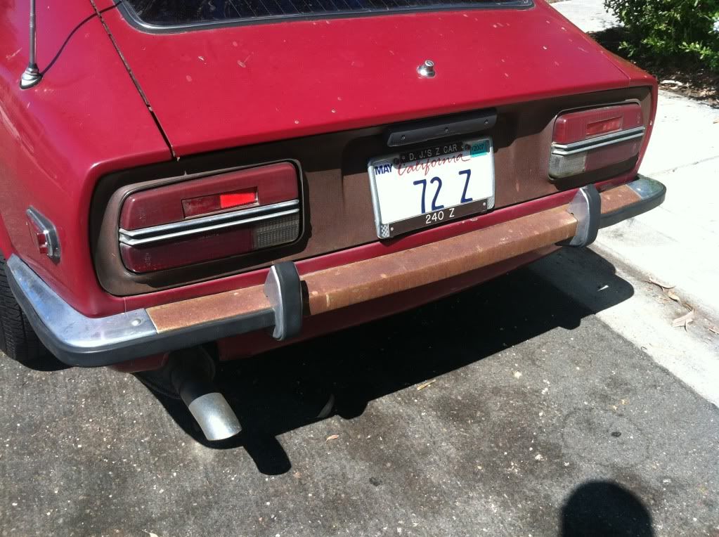

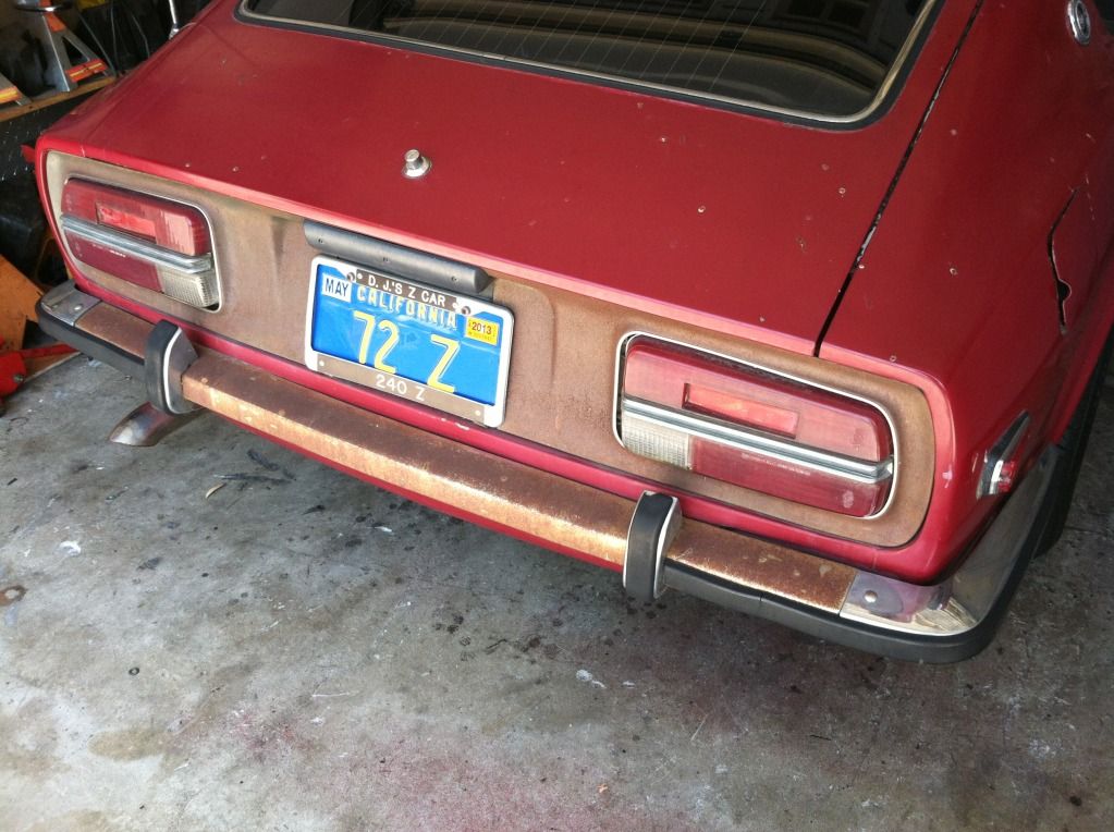

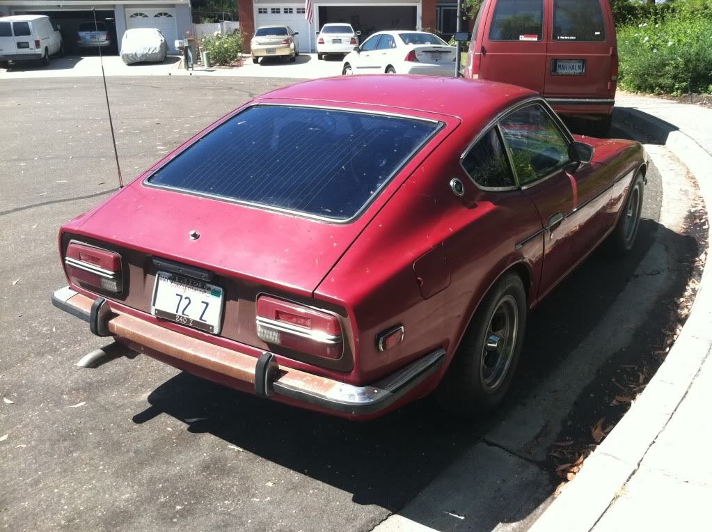

rear taillight surround is a bit rusty, im just going to put the good one off the other car.

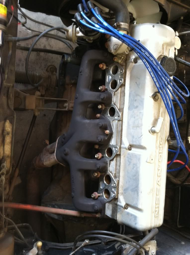

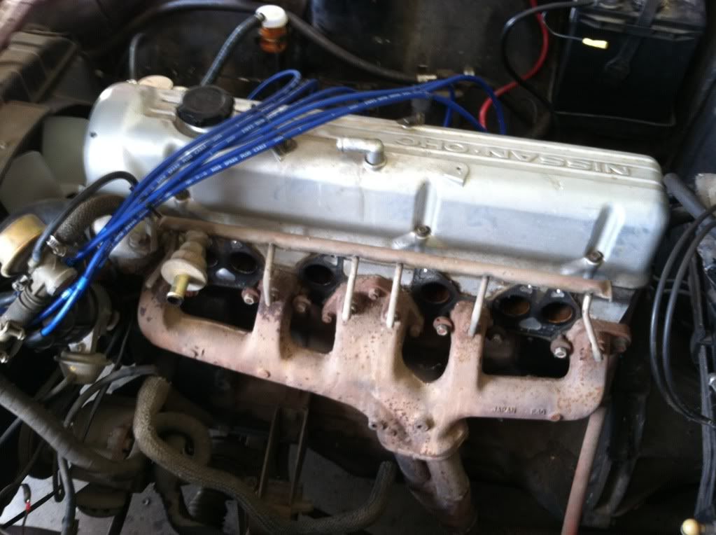

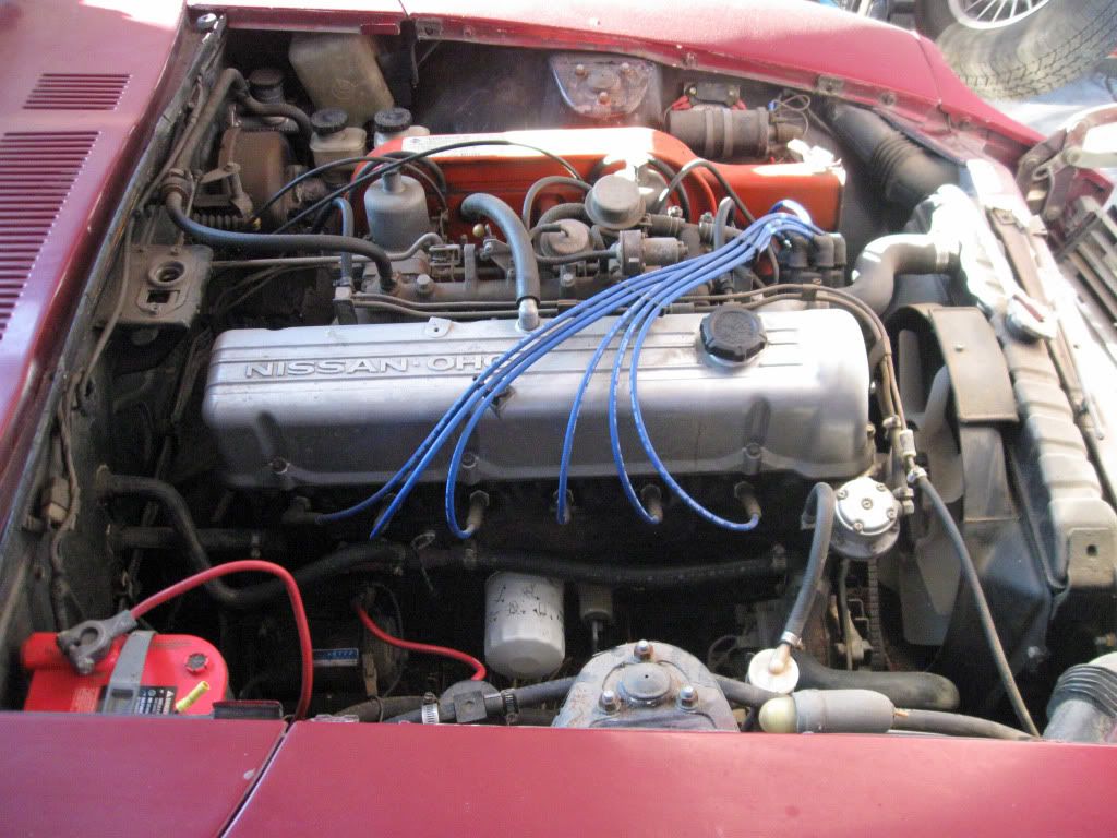

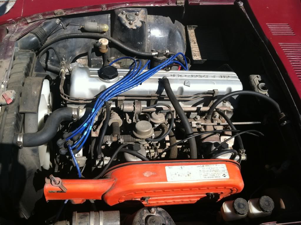

Bone stock L24, it even has the smog pump belt on it, im surprised that still happens

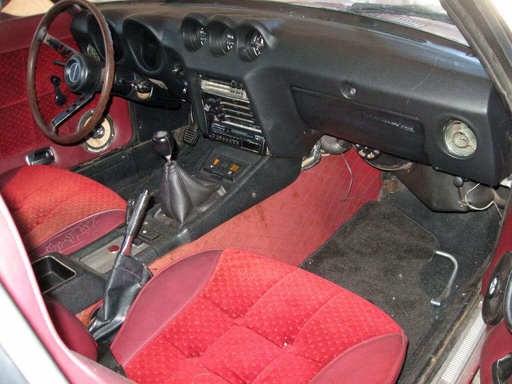

Unfortunately, it is cursed with a porno red interior, that will change eventually, its only a minor speed bump.
It has some sort of foot rest bolted to the floor on the passenger side, not sure what thats about, but its kind of neat

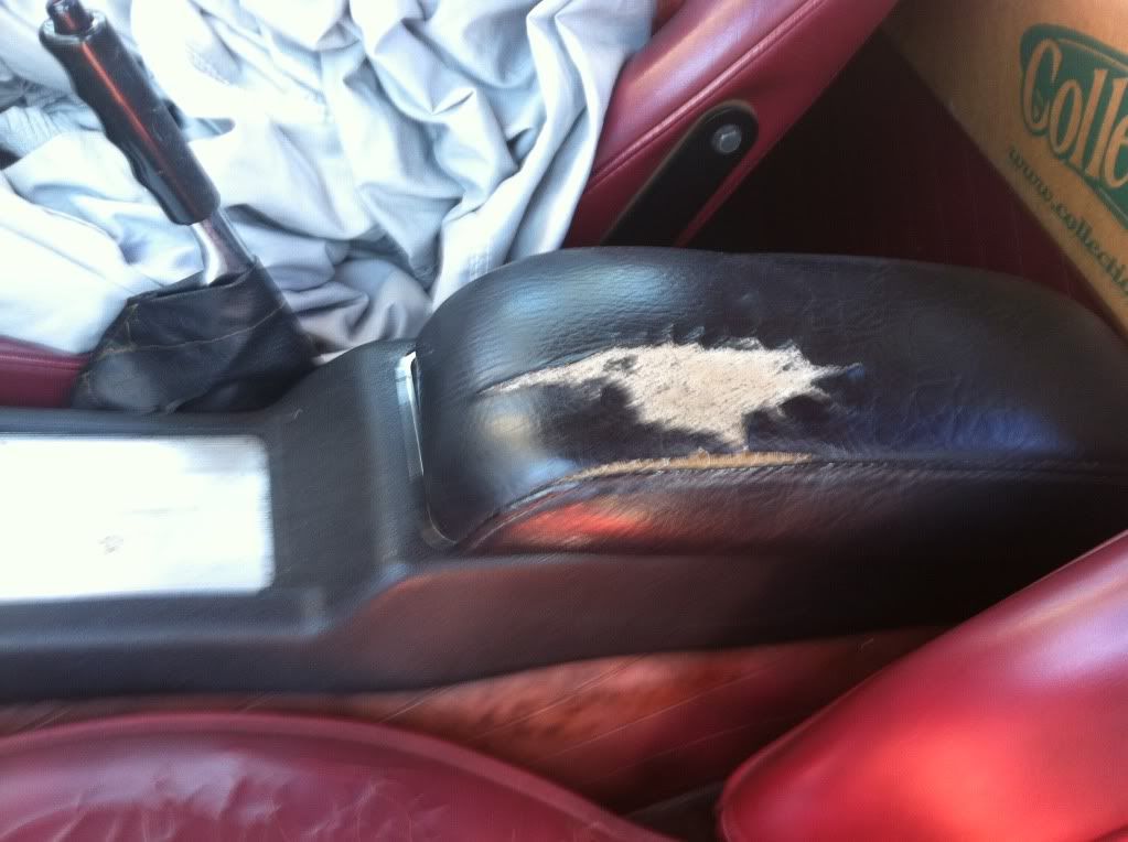

It has a neat armrest i think im going to reupholster and use

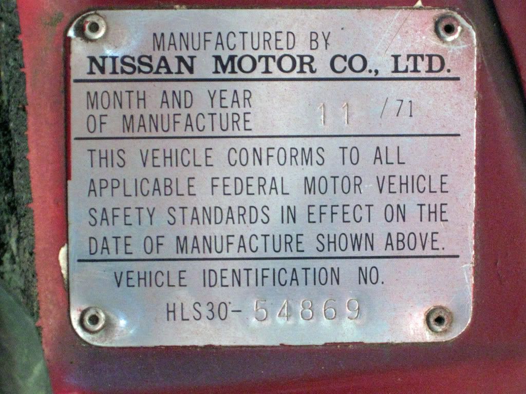

Turns out the PO has an Original brochure
and a blue plate
and consistent service records from purchase in January of 1972, up until the sale to the guy i bought it from in 2005

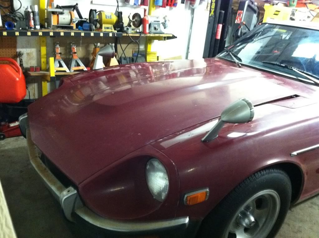

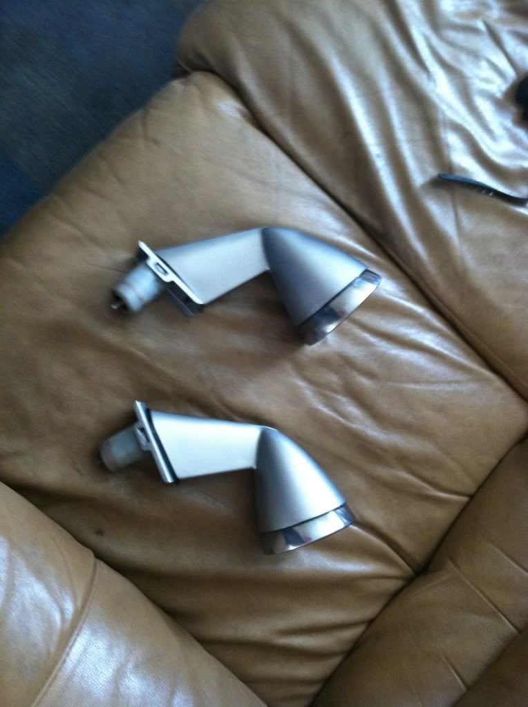

My buddy gave me some TA27 Celica fender mirrors which will probably get installed tomorrow, painted duplicolor Stainless steel color

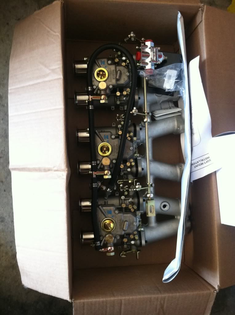

and his set of webers for his car, im planning on swapping this car soon, so this is basically me getting to set up his carbs for him.

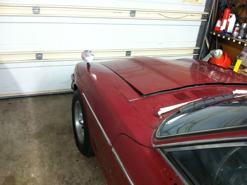

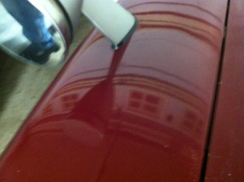

First things first, i got my TA27 mirrors mounted.
I also decided to test a proof of concept, and buff out the paint on the front of the fenders before hand. it actually looks like with a bit of TLC and some touch up paint, i may be able to get this thing looking pretty damn good.
(compare that to the rest of the exterior pics, it has absolutely no gloss whatsoever.

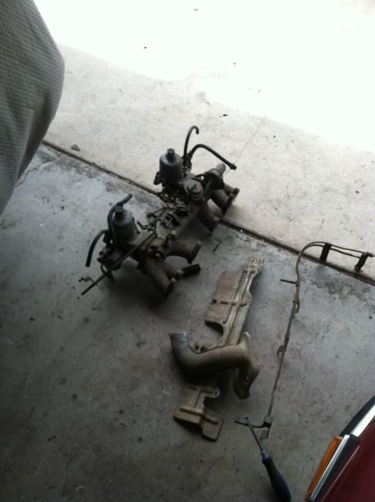

Small update. I got up early this morning and got my webers installed.

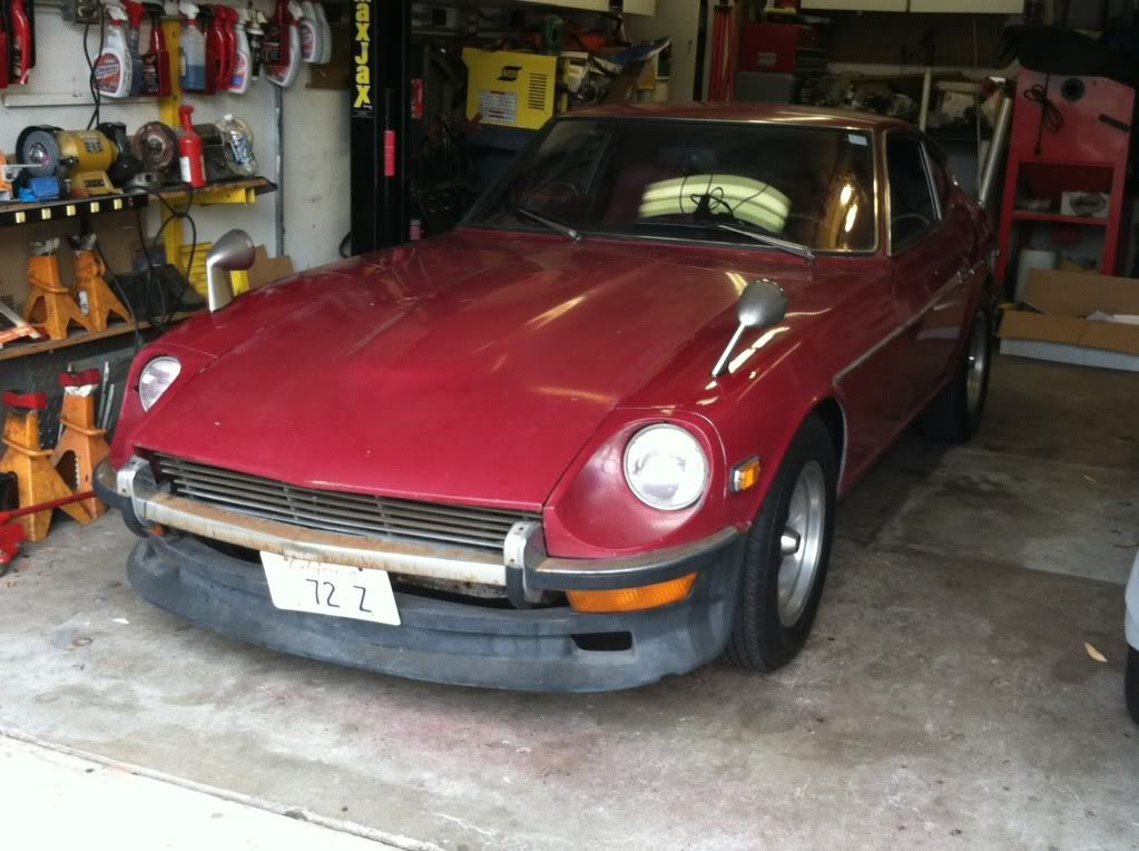

Small preface, i took this picture before i started, just a better pic with the fender mirrors.

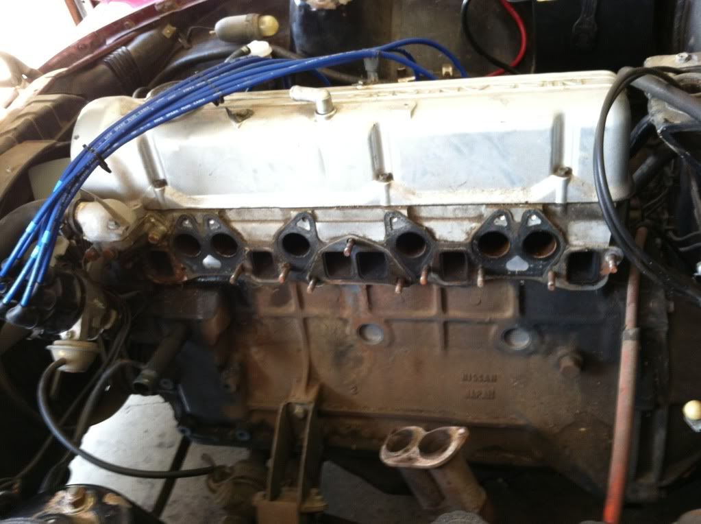

Took me a bit to take a pic, Here is the main problem, sourced and removed

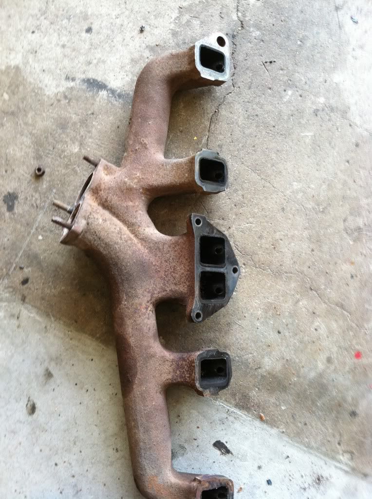

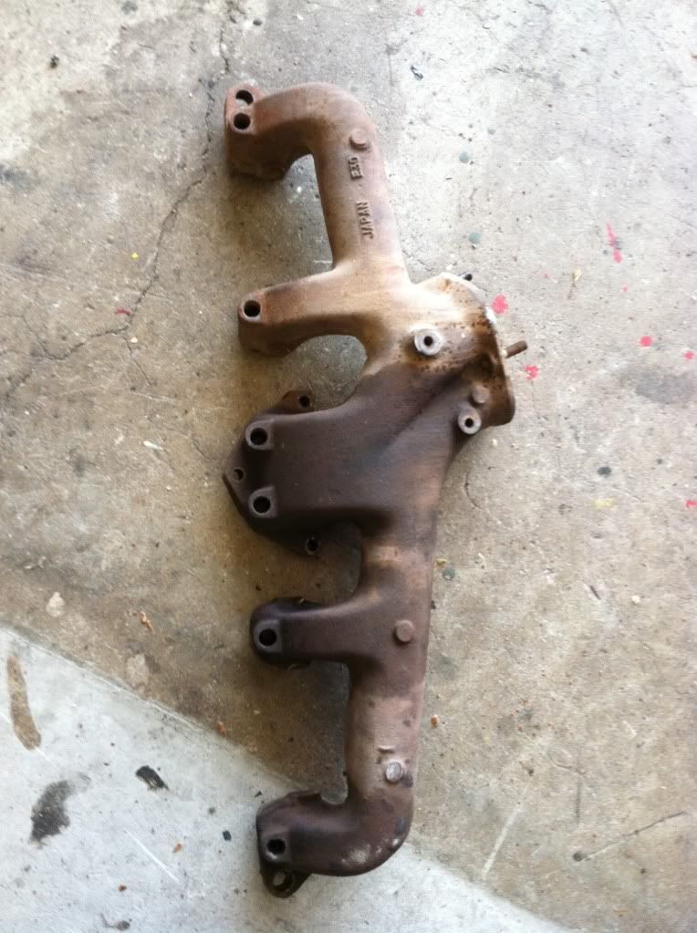

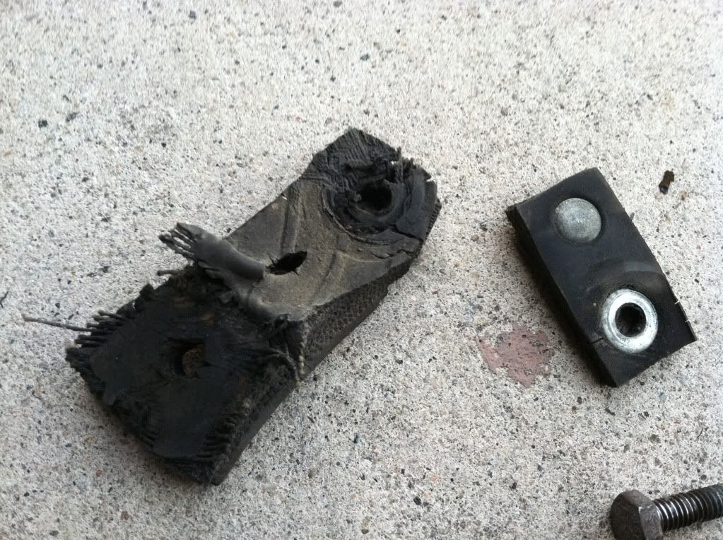

Right about this point, i realized that i should remove the exhaust and get rid of that god awful heat riser.
Exhaust off and heat riser removed
smog tubes out, turned out to be MUCH easier than i was expecting

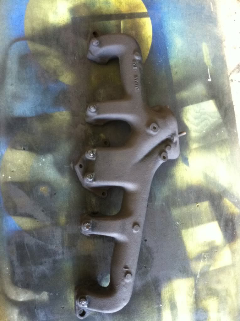

Plugged, painted, and ready to go.
Installed
All done
