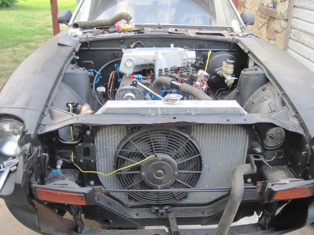

Shemyazaz Posted September 25, 2012 Author Share Posted September 25, 2012 Just a quick udate. Haven't been posting play by play or anything like that since nobody seems interested. Got the upper intake installed. A bracket made for the coils. various sensors mounted. Trigger wheel centered and attached, along with its pickup. got the throttle and trans link figured out. (Made bell cranks. When was the last time you saw one of those?)Put the radiator in. Hopefully my guages will ship this week so I can reinstall the dash this weekend. Quote Link to comment Share on other sites More sharing options...

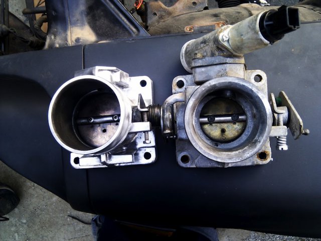

Shemyazaz Posted September 25, 2012 Author Share Posted September 25, 2012 The intake can be mounted either direction. The problem that I encountered is the fuel rails from the explorer....the nice chrome ones with the flow through design...has the regulator on the wrong side. Had to use the town car rail....which isn't nearly as nice. I think the throttle bodies are arranged differently as well, but I'm not sure. I'll dig up pictures as I have a side by side (for size comparison) Quote Link to comment Share on other sites More sharing options...
Shemyazaz Posted September 25, 2012 Author Share Posted September 25, 2012 (edited) Nope. Same stuff. Well....slightly different armature. Not like that makes a big difference if you are fabbing linkages and such anyway. Edited September 25, 2012 by Shemyazaz Quote Link to comment Share on other sites More sharing options...
yellowoctupus Posted September 26, 2012 Share Posted September 26, 2012 Wow! Those butterflies are not even comparable in size!! Which one came off which car? Is the Towncar's on the right, the Explorer's on the left? Quote Link to comment Share on other sites More sharing options...
Shemyazaz Posted September 26, 2012 Author Share Posted September 26, 2012 Yup. I didn't take any pictures of it, but the SO upper intake is very small as well. Quote Link to comment Share on other sites More sharing options...

Shemyazaz Posted October 8, 2012 Author Share Posted October 8, 2012 Got the dash back in. All the guage wiring and such is done. Feels like this is taking forever....and the weather has not been on my side the past couple weeks. Quote Link to comment Share on other sites More sharing options...
74_5.0L_Z Posted October 8, 2012 Share Posted October 8, 2012 Got the dash back in. All the guage wiring and such is done. Feels like this is taking forever....and the weather has not been on my side the past couple weeks. Is that ice on the windshield? I worked in the garage this past weekend, and I was complaining about the heat (92 F). I would much rather be hot than cold. Quote Link to comment Share on other sites More sharing options...
