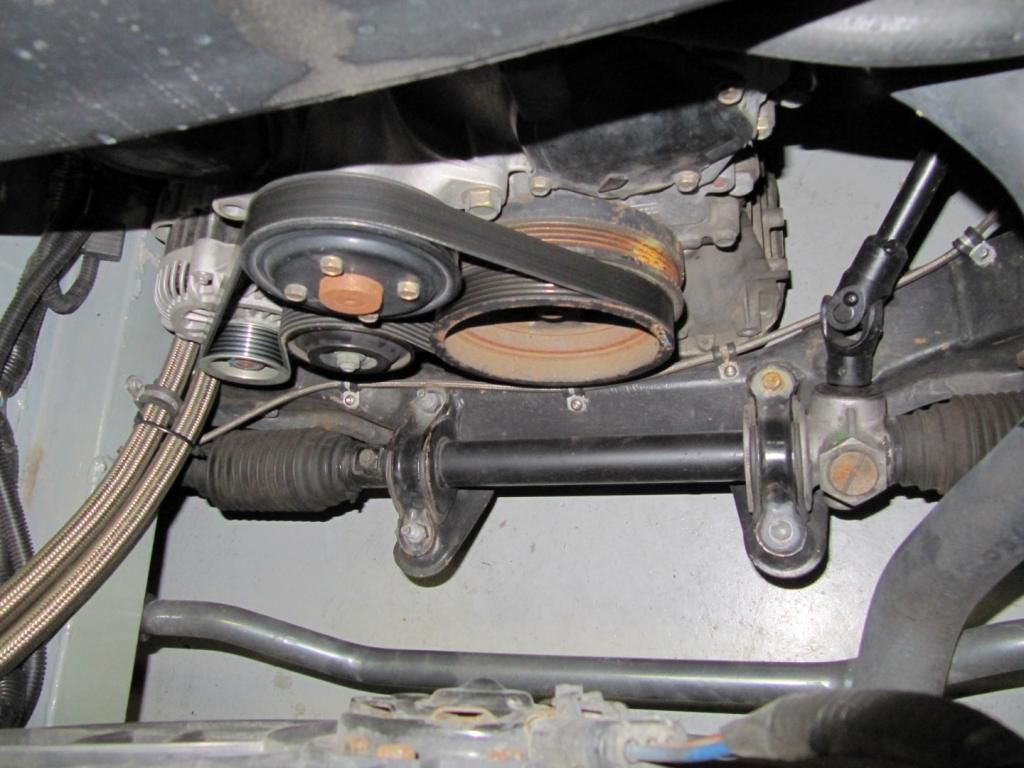

docaam Posted March 2, 2014 Share Posted March 2, 2014 the stock shaft was right in the way of the mounts. i went with willward steering components because they made u joints that connect directly to the datsun rack! i did something similar to emrwhyrohen's setup. Hey you have other details on these steering component, I am problem souring parts here locally a pm with details will be highly appreciated Quote Link to comment Share on other sites More sharing options...

Pharaohabq Posted December 12, 2014 Share Posted December 12, 2014 Pretty Cool... Oh on those Steering linkages. I'm just using spare 280Z steering Ujoints in mine. The stock steerign column I'm shortening to about 18" and going to use the 350Z tilt column in place. I don't really have to have Tilt, but it'll be a fun detail. The Ujoints are compatible with the 350Z steering yoke, and they fit the top where the stock steering wheel fits. I only needed two spares from the Z graveyard. Quote Link to comment Share on other sites More sharing options...

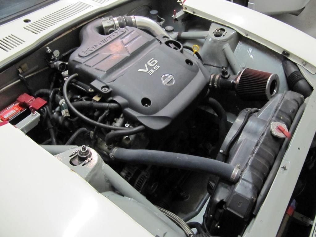

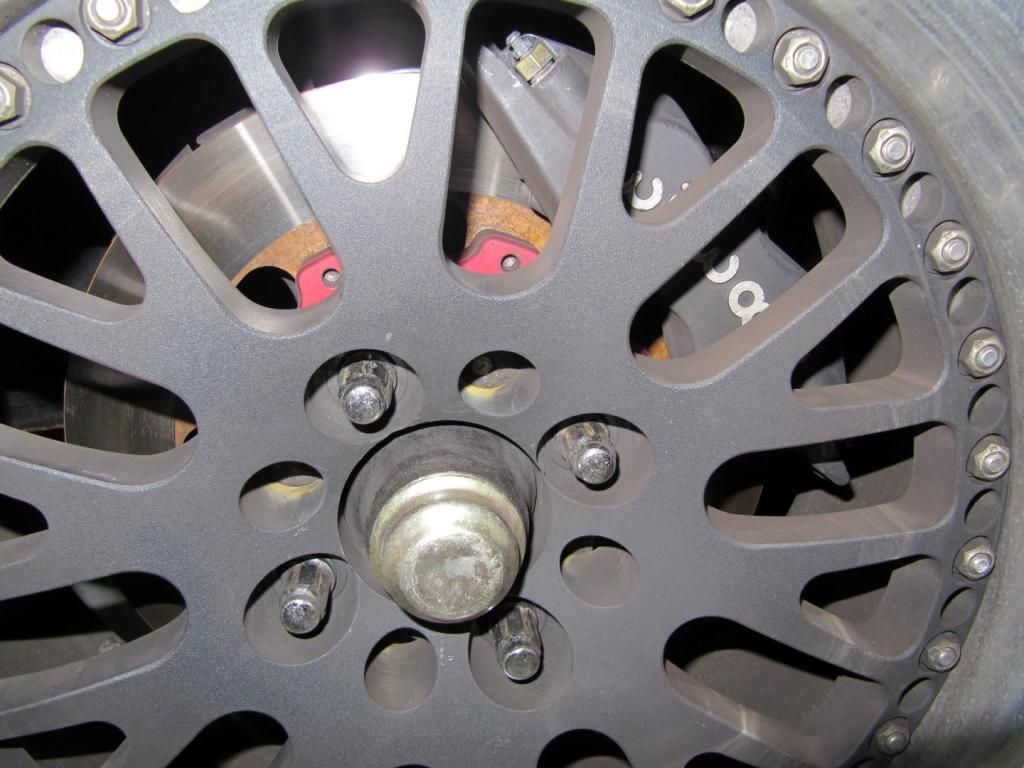

STRMTPR_Z Posted July 30, 2015 Share Posted July 30, 2015 thanks! the radiator actually works really well that way. the fan comes on being controlled by the factory relays. i think i used the low speed output from the IPDM to control the low speed on the fan. im going to see if i can get away with just that for now. I run running no thermostat as well because it heats up pretty quick anyway, within a few minutes. I was having issues with coolant not flowing, after multiple attempts to bleed the system it just never worked out so i pulled it. that steering wheel is an old Tomei wheel ive had laying around forever, i finally get to use it on something.note taken on exhaust, ive wanted to remake my center pipe for a while, but it will have to wait, i have a track day on the 6th of october, gotta hurry.here are some updated pics. Got the test fit CCW classic! these wheels are so awesome. What are your ccw specs? Spacers? Quote Link to comment Share on other sites More sharing options...

STRMTPR_Z Posted August 1, 2015 Share Posted August 1, 2015 What are your specs on wheels & tires? What flares are they under? Thanks Quote Link to comment Share on other sites More sharing options...
