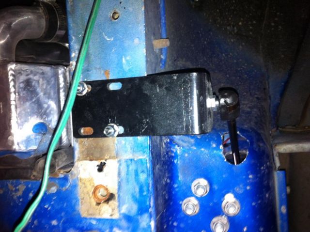

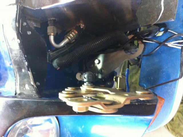

Gas Hood Schock Assembly Kit from Z Race Products and I have rather mixed opionions about it. First it took forever to received the shipment (ordered on June 20th, shipped on August 6th), but they seem very friendly and easy to work with. I can't find the post, but someone complained before about the documentation, and I would have to agree - but the kit itself seems to be of high quality. The templates provided didn't line up correctly on my install so I had to enlarge the opening to allow the strut to have room to go through the body. I made adjustments on the other side and that one works just fine.

The problems are still not over. I wasn't unable to completely close my hood after installation of the kit, and for a long time I couldn't figure out why. I finally removed my fender and figured out that the shock was bottoming out before the hood could close! I got ahold of Jerry and was able to convince him he sent me the wrong shocks. He's told me he will be sending out the correct one's shortly.

  4. The installation seems overly difficult - especially having to center drill and tap the existing bushings to install the upper ball stud. (I got Jerry to do this for me since the delivery took so long). I think most buyers would wind up having to use a machine shop for this.

  5. I was sent upper ball studs that were supposed to be long enough to allow them to be installed using a nut instead of being welded on to the bushings, but they were still too short to allow the nuts Jerry included in my kit to be used (I purchased longer ball studs myself).
