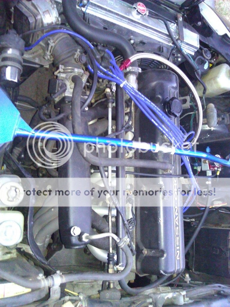

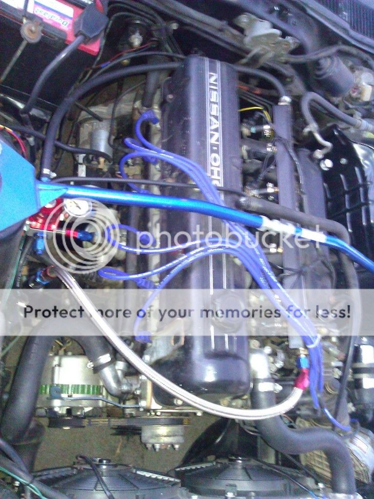

This is what my car is running off of. 80 280zx, did not come with an EGR in the first place so I swapped the manifold out for an N42.
the only ports in the manifold I use are the brake booster, FPR port, charcoal canister, PCV on the bottom, and the crank case to the throttle body.
I removed the idle up for cold mornings and the 7th injector.
You'd probably be better off installing megasquirt with a MAF and TPS. The Stock system is so basic that you're not really going to gain anything by removing parts. You've already stripped out a lot by the look of it. Electric fans, fuel and oil upgrades. What is you want? More power? Modern EFI might help but won't make THAT big a difference. Look at your exhaust, Already no EGR, so already no Cat. Nothing to Delete. So getting rid of the stock AFM and going mega-squirt is about all I can see you could try, unless you want to play with internals, like a cam or something. MS can handle EDIS too if you're looking to get rid of those blue line thingies on the top.
yeah, figured... Even a lot of your bungs have already been shaved so you're going to have trouble cleaning it up much more than that. The NDIS or EDIS systems can get you basically distributorless operation and allow Coil on plug. but even then you're not gaining anything. I suppose you could reroute your fuel lines to your fuel rail and mount everything on the firewall to clean it up a little.
That Turbo conversion will be fun, You'll have a few more lines but not much. It's a good time to go MS+S.
