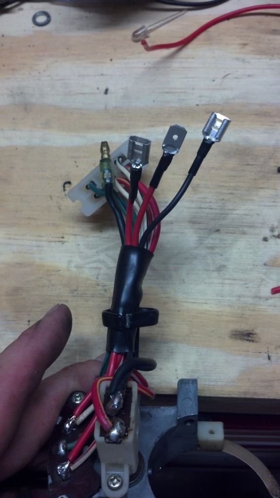

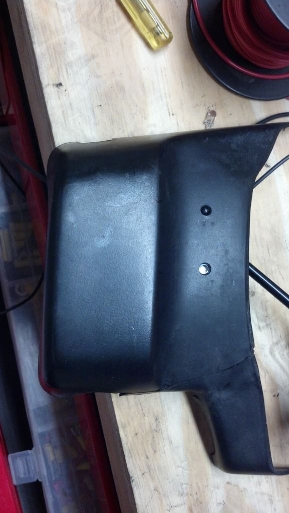

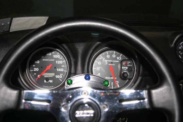

SUNNY Z Posted August 25, 2012 Share Posted August 25, 2012 (edited) Ever since I swapped to autometer gauges, I had no turn signal indicators. This is a quick, CHEAP, and easy way to get some. I took the piece off the top of the column, after I marked it with a sharpie where I wanted the LED's. Then I drilled out the holes, and used a plastic weld 2 part epoxy to mount the LED's flush with the surface. You need to use a resistor on the + side of the LED, i believe i used 1/2 w 1K Ohm Next I soldered wires onto the contacts of the switch Topped it off with spade connectors (idiot proof) . (I later insulated over the spades) and the finished product. IDK what happened when i uploaded the vid from my phone, but you get the idea. Edited August 25, 2012 by SUNNY Z Quote Link to comment Share on other sites More sharing options...

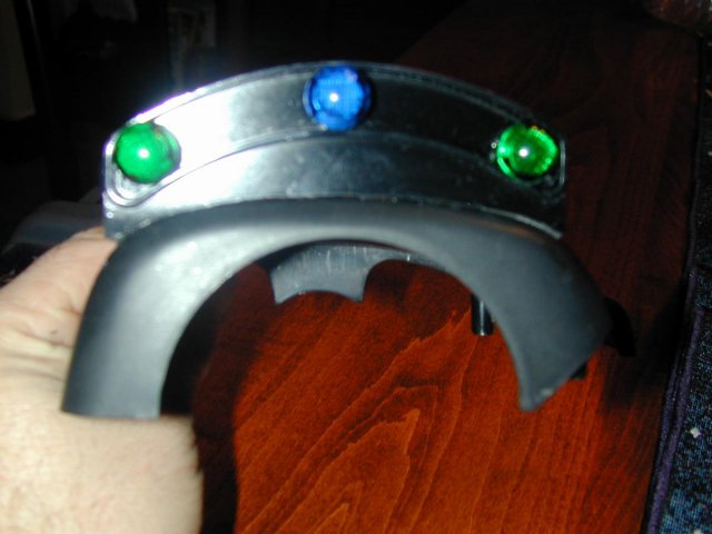

gvincent Posted November 14, 2012 Share Posted November 14, 2012 I found an old Ford truck with the column mounted PRNDL indicator and painted the clear plastic black and mounted 2 green and 1 blue 12V led bulbs and wired them to the existing wiring. I ground down the unit to match the steering column cover and used black double stick tape to keep it in place. Quote Link to comment Share on other sites More sharing options...
