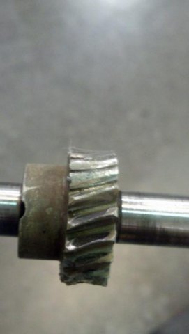

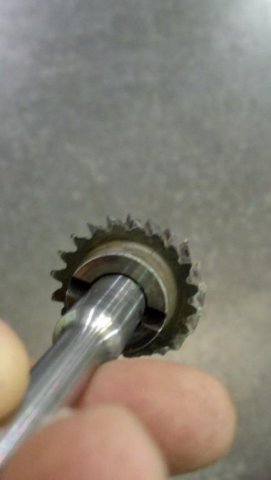

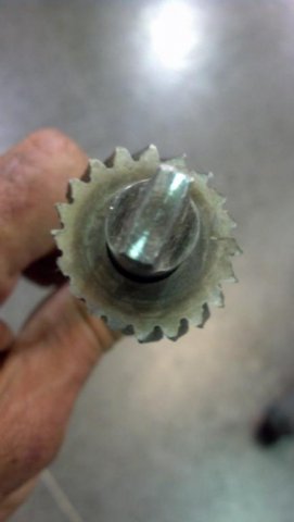

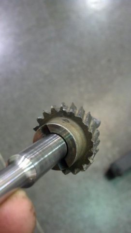

Leon Posted November 3, 2013 Share Posted November 3, 2013 Damn, that sucks! Sounds like the distributor drive gear spun on its shaft. There are some good threads on pinning it so it doesn't happen again. Or, convert to crank-triggered ignition... 1 Quote Link to comment Share on other sites More sharing options...
duragg Posted November 4, 2013 Author Share Posted November 4, 2013 I planned this to be the last event for the little green motor. It served well and really only needs a better Dizzy drive, then can be backup motor. But I am done with Dizzys now. Have BHJ dampers with 60-2 wheels or some such witchcraft for the next motor. Sticking with L motors for a while. The sound. Sticking with Carbs for a while.. The history Sticking with NA for a while... cuz its harder and just plain cooler. 2015? Hmmm... Supercharged L32 Quote Link to comment Share on other sites More sharing options...
Leon Posted November 4, 2013 Share Posted November 4, 2013 I planned this to be the last event for the little green motor. It served well and really only needs a better Dizzy drive, then can be backup motor. But I am done with Dizzys now. Have BHJ dampers with 60-2 wheels or some such witchcraft for the next motor. Sticking with L motors for a while. The sound. Sticking with Carbs for a while.. The history Sticking with NA for a while... cuz its harder and just plain cooler. 2015? Hmmm... Supercharged L32 I'm with you on all 3 counts! I'm running triples and Megajolt crank-triggered ignition in a Z, it's one of my favorite upgrades. All said and done, it ran me maybe $500. I know Lazeum on this forum is also running a similar setup. That BHJ damper sounds like an awesome piece. Quote Link to comment Share on other sites More sharing options...

duragg Posted November 6, 2013 Author Share Posted November 6, 2013 The corresponding gear on the crank is wasted also. The exact cause? If you read through all my posts you would probably find it. But since we are all adults here .... Quote Link to comment Share on other sites More sharing options...

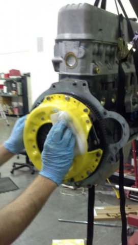

duragg Posted November 26, 2013 Author Share Posted November 26, 2013 I need a clutch solution, my racing brothers. I prefer indestructible vs rebuilding every 3 or 4 weekends. I can spend whatever. Past $1000 bucks I am choking. Right now I have a 12lb "Arizona Zcar" flywheel which takes 225 or 240mm clutch. Or I can dump that and go new flywheel / clutch combo. Help... Too many options. Looking for the "Buy it Yesterday" button Quote Link to comment Share on other sites More sharing options...
RebekahsZ Posted November 26, 2013 Share Posted November 26, 2013 There was a guy at an autocross last year near Memphis who had a 1st series 240z that weighed under 2000#. I want to say he had it down to 1989# but I'm not positive on that figure. That is with a 3.5 Nissan V6, steel hood and hatch with an auto power roll cage. He was racing in FP class. Quote Link to comment Share on other sites More sharing options...
AZGhost623 Posted November 27, 2013 Share Posted November 27, 2013 I need a clutch solution, my racing brothers. I prefer indestructible vs rebuilding every 3 or 4 weekends. I can spend whatever. Past $1000 bucks I am choking. Right now I have a 12lb "Arizona Zcar" flywheel which takes 225 or 240mm clutch. Or I can dump that and go new flywheel / clutch combo. Help... Too many options. Looking for the "Buy it Yesterday" button http://www.whiteheadperformance.com/products/os-giken-ts-series-twin-plate-clutch-kit-used-datsun-240z-260z-280z-280zx/ Its used but less than 1000$ something to get you started on with a twin plate setup. Just probably needs the disc's changed out ... Quote Link to comment Share on other sites More sharing options...
duragg Posted November 27, 2013 Author Share Posted November 27, 2013 I have been talked off the ultralight twin disk setup in favor of a ultra durable system that I can abuse. I don't have a full winch-up trailer yet and 2014 is a learning year for me and the car so this is probably a wiser choice (Blah!!!) Quote Link to comment Share on other sites More sharing options...

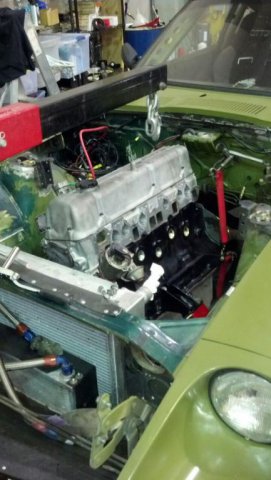

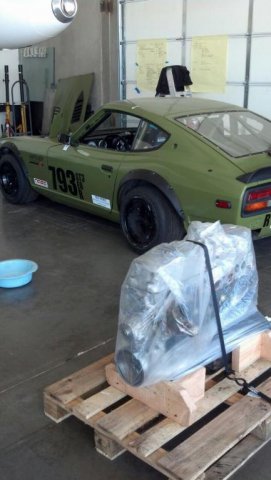

duragg Posted December 18, 2013 Author Share Posted December 18, 2013 Progressing nicely. Should be "Code 1" for the January race at WHP Quote Link to comment Share on other sites More sharing options...
