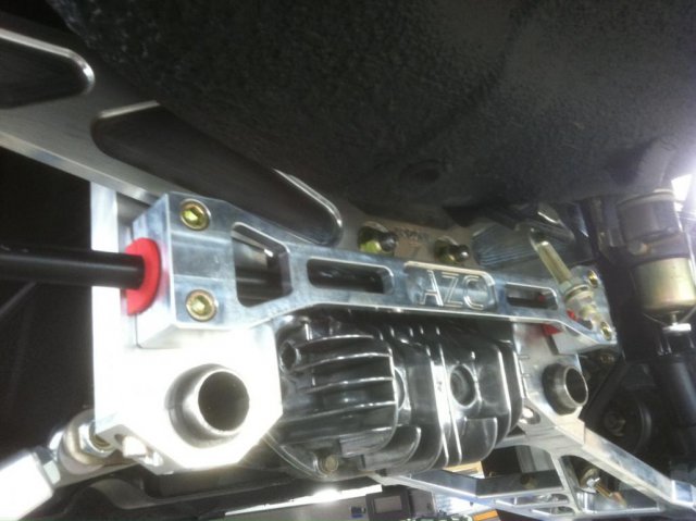

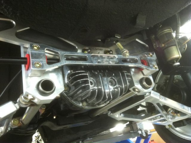

Where did you get those swaybar saddles (super sweet!)? Also, you need to have a spacer made to move the swaybar about 1/2" off the frame, or your swaybar will kiss the frame rail, kink the sheetmetal and wreck your paint. To check to see if this is the case, loosen your strut collar all the way and jack up a front control arm till it is level. Then check sway bar to frame clearance. Then raise the control arm a couple inches more to simulate a hard bump. If the swaybar stays clear of the frame rail, disregard this discussions.
Thanks for the heads up, I will fabricate a spacer.

I now have the R200 LSD in the car after replacing the seals, replating the hardware and installing a new differential mount.
