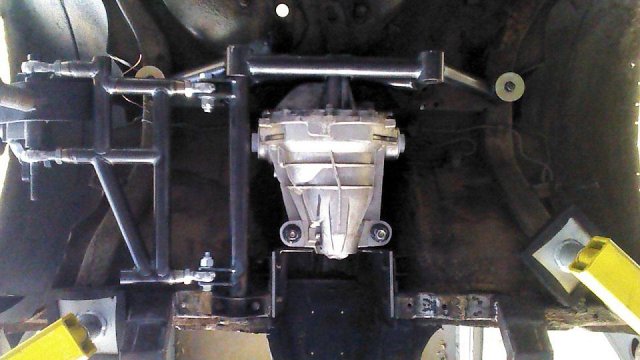

SUNNY Z Posted January 6, 2013 Share Posted January 6, 2013 Just wondering how the ford parts equate to a stronger knuckle than the T3 stuff? I do know that the Q45/ 300zxTT outer stub that goes through the knuckle is 2mm larger than the ford stuff. Looking great! I wish i had access to a tubing bender and a nice mig/tig... I'm working out of a 1 car garage in an apartment complex ! lol I like how you incorporated the mustache bar. However, I'm not sold on how you captivated the rear of the lca. It will work great for you, but for me to drop my diff, the lca's have to be loose on the inside, and folded down, due to the big ears on the cover. Great progress, looking forward to seeing some footage of this thing! Quote Link to comment Share on other sites More sharing options...
01vincer6 Posted January 7, 2013 Author Share Posted January 7, 2013 The T3 Plate being welded makes me nervous but I might have to go with it anyway. To remove the diff on mine you can just take the front mount off and the 2 bolts on the back. I almost went with your cover but wanted to be different than you . Hopefully both ideas work great and we see each others cars at the next big meet.I might be modding my rear mount next weekend to move the diff back another 1/2". Quote Link to comment Share on other sites More sharing options...

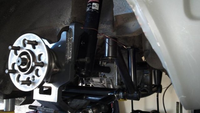

01vincer6 Posted January 11, 2013 Author Share Posted January 11, 2013 Backing plates are here. Definately overbuilt with quality welds. Quote Link to comment Share on other sites More sharing options...

01vincer6 Posted February 7, 2013 Author Share Posted February 7, 2013 Finally had time to work on the car again. I completed the drivers side LCA today. Hopefully I can spend a few more hours in the next day or so to make the other one now that the hard part is done. Quote Link to comment Share on other sites More sharing options...
disepyon Posted February 8, 2013 Share Posted February 8, 2013 Looks good. What did you construct it out of, mild steel or chromoly? Figure out what to do for axles using the 8.8 diff? Quote Link to comment Share on other sites More sharing options...
01vincer6 Posted February 8, 2013 Author Share Posted February 8, 2013 1 1/4 MS .120 wall. I was going to use moly but i would rather bend an LCA than break one.Axles are easy. Just need to order them now that I can put the wheels on and set it down to measure length. If I get the other LCA done this weekend I will order axles Monday. Quote Link to comment Share on other sites More sharing options...
01vincer6 Posted February 11, 2013 Author Share Posted February 11, 2013 Test fitting.. Quote Link to comment Share on other sites More sharing options...
