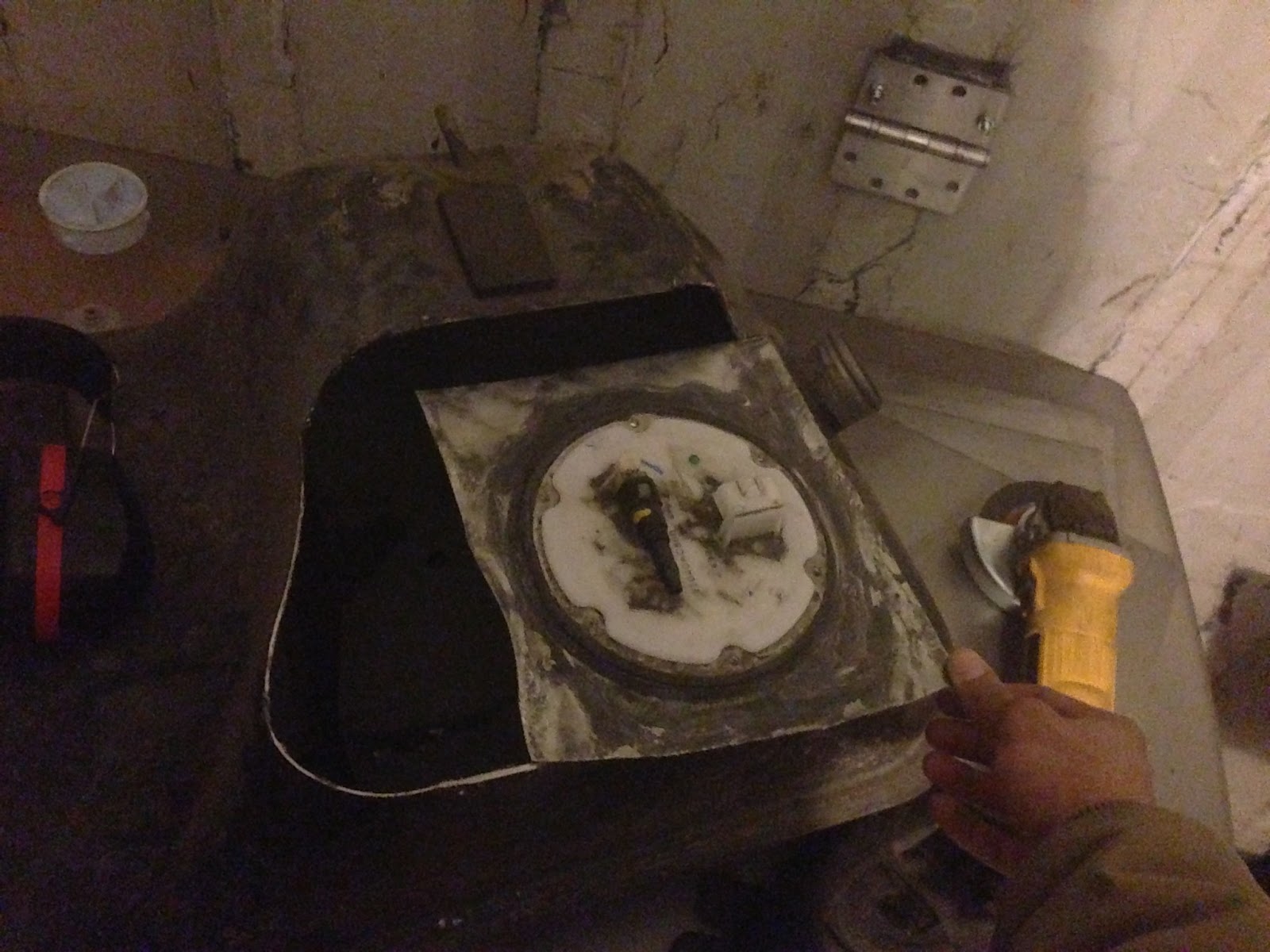

I just ordered a 350z gas tank with pump and all for $100 shipped. I'm gonna try to cut out the flange and weld it into the 240 tank I've got. I'm a little worried about the depth being correct, but we'll see when it gets here.

I'd love to see pictures of this flange swap.  I think it'll work great. if anything a little plastic modification and bending of the float arm should sort it out.  Please post some pictures along the way.  :)
I 2nd this. Getting those parts isn't too hard really. It's just be good to see how you do this and then how it's all connected up and working...
So money is no longer as tight as it was.  Paid off a lot of bills with taxes :icon47:   I am just waitiing to see how the 350z pump swap works out.  Please post lots of pictures, and ample explanation.  I think that this pump setup, if it works properly, will be a great asset to the vq swap community.  If it works, and the write up is good I vote sticky.

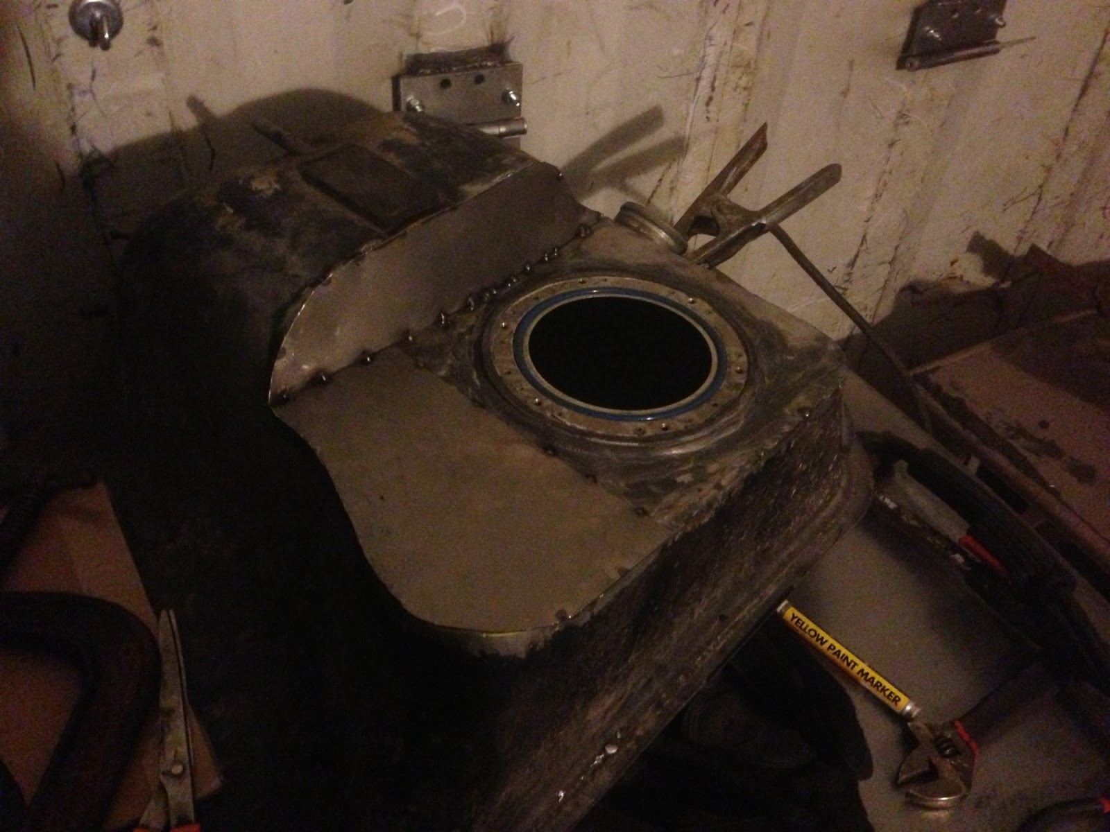

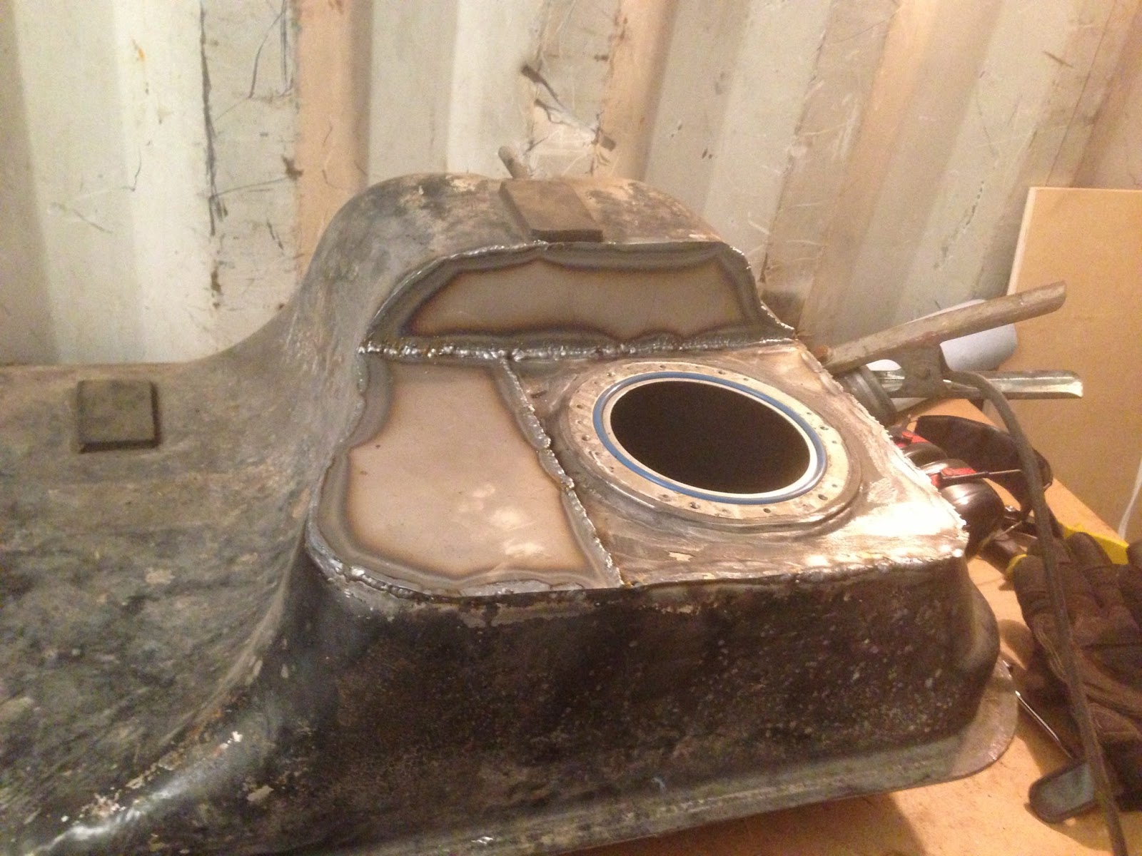

I posted these in my thread but I figured I should share them here too. Here's my progress on the pump swap. After welding it up I used a smoke machine to find the inevitable pinholes. I also ordered some tank sealer  that I'm going to coat the inside of the tank with. My harness should be back next week so I will be able to test it out soon.

Hey Dave,  Yes the 280Z tank has a couple baffles, but would hang lower in the 240Z, due to the larger spare tirewell. But I think its probably the pickup more than anything.  Does it have the issue when the tank is full?  A full tank should be keeping the pickup under the level the whole time.  I'm not sure if you tried any of those other tests.  it could still be your fuel filter. A 240Z filter is too low flow and would certainly cause that. You might try a 350Z filter if you haven't already.  Zero's tank looks awesome.  I want to do that with my VQswap.
