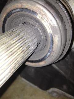

RebekahsZ Posted January 27, 2013 Share Posted January 27, 2013 (edited) McLeod uses its own slave cylinder,although the concept is the same as any other. The ls9 slave has a green baffled designed to keep dust from coming on the sides, but my experience suggests that the dust comes in on the end, so I don't think the boot is a real solution. Keep me posted over time if you have discolored hydraulic fluid all the time as I do. I assume you will use a steel bellhousing? I gotta go back maybe next year and do that. I think it is really helpful to have an opening in the bellhousing that lets you inspect your clutch engagement and look for hydraulic leaks. The shimming of the slave has to be perfect. The hydraulics have to be perfect too. The TIC master cyl is just a tilton with a rod end fitting on the push rod. There is nothing special or magic about the tic. I have purchased 5-6 different tilton masters and half of them were bad out of the box. Get an AN 3 plug and put it in the out port of the master. Bleed the brakes then make sure your master will hold pressure against that plug. If it doesn't, the master is bad. Check that before spending a lot of time looking for red herrings. That is a go-no-go test on the master. Also, cut the metric nut off the yoke for the push rod and have a SAE nut welded in its place so you can use the longer rod that comes with the new master. You can just swap rods and avoid the welding, but the Datsun rod is barely long enough and you want some adjustability. My datsun rod is fully extended even with a 1" master which makes for a pretty stiff pedal. Most guys are doing fine with a 7/8" master if they have a longer rod to allow full travel. The difference between 7/8 and 1" is very noticeable for pedal effort with the 1" being more stiff (think old school racing clutch). Hope that helps-I just shared most of my t56 problems that kept me on jack stands during the height of last racing season. Lots of t56 folklore on the Internet and it is 99.9% crap. Ill try to edit this later and show a picture of the dust all over my slave cylinder. IMG_0752.MOV Edited January 27, 2013 by RebekahsZ Quote Link to comment Share on other sites More sharing options...
