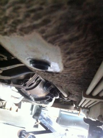

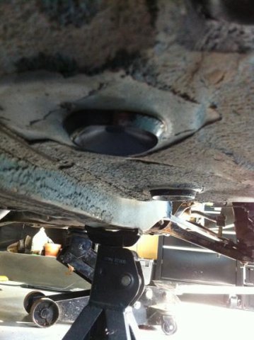

str8pipez Posted February 2, 2013 Share Posted February 2, 2013 (edited) While changing my front brakes I noticed what looked like a couple drops of oil under the passenger door. Out of curiosity I looked under the body and noticed there was leaking around 2 of the body plugs. I've attached a couple photos of the leaking area. Anyone have any ideas? The fluid was oily and colored like brake fluid. I'm not losing brake fluid or any other fluid that I know of. Kinda crazy. Edited February 2, 2013 by str8pipez Quote Link to comment Share on other sites More sharing options...
NewZed Posted February 2, 2013 Share Posted February 2, 2013 Look at the other side of the plug. It's under the carpet. Probably aniifreeze from a leaky heater core or hoses. Quote Link to comment Share on other sites More sharing options...
78Z/250GTO Posted February 3, 2013 Share Posted February 3, 2013 Ditto on that thought. Antifreeze from the heater area mixing with the carpet color and oozing out can make it look oilish. Quote Link to comment Share on other sites More sharing options...
J-hop Posted February 3, 2013 Share Posted February 3, 2013 (edited) It could be rain water as well. If it were coolant I would expect that the OP would have smelled it if there was enough to soak the carpet and pool around the drain plug like that. Seems that St.Louis has had a decent amount of rain lately so I wouldn't jump to a leaky heater core quite yet! Edited February 3, 2013 by J-hop Quote Link to comment Share on other sites More sharing options...
str8pipez Posted February 3, 2013 Author Share Posted February 3, 2013 good thoughts all. i did just repair the vacuum lines to get the heater going again and it has been wet here lately. Quote Link to comment Share on other sites More sharing options...
