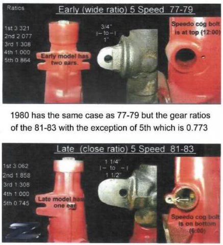

I am installing a 5 speed transmission and I would like to know what year and model it came from.  It has the shorter ear and the fill plug on driverside.  Thank you in advance.
