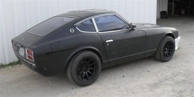

I have 16x10 wheels at rear wrapped with 225/50zr16 if it can help you :
It gives a bubble rounded style more than a straight stretched effect in my opinion. I'm not into the stretched look either and I'm happy with the result. Ticker sidewalls of zr tires helps I think

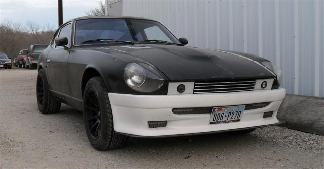

What are running up front ? My tires are coming today . I ordered 225/50r16 for 16x8 +0 , without flares . Hope they'll fit .
16x9 in front with the same size of tires (225\50)
My first setup was some sportmax 16x8 +0 with 225/50 tires and you just have to roll the inner lip of the stock fender to get rid of the rubbing and you are ready to go
Yeah , i bought a set of XXR 527 16x8.25 +0 . Figured i might have to roll the fenders . Do have flares , bought from MSA , just not ready to do the work , on the bottom of my to-do-list . Just got the LS1 in it , doing detail work at this time . Thanks

You'll have a bit more rubber in the back, but this should give you an idea since its similar.
I have 16x8.25, 0 offset, no spacers with 205/50 tires
Yeah , i was going to go with that size . But with LS1 and auto , the exh. sits low . Just trying to close the gap between the tires and the fenders . I haven't lowered the car yet . It looks like a 4x4 with the lighter V8 . LOL .
I would like to have the same stance as yours , it looks great !

Just got tires mounted and on the car . Yeah , 225 are a little wider and an inch taller . Still has that 4x4 look . LOL . Just wounder what spring and strut combo you are running ? I want an inch or so lower in the rear and at least 2 inches in the front . Thanks
