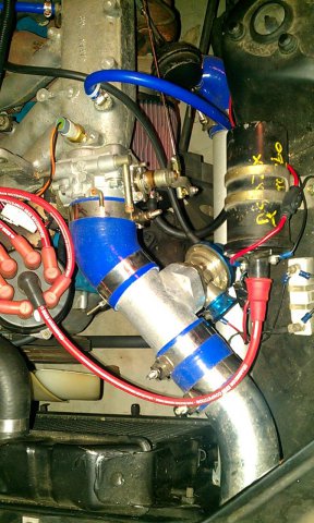

OhBilly Posted March 4, 2013 Share Posted March 4, 2013 It's not a great photo, but here is a shot of my Greddy RS knockoff mounted right before the TB. It's not mounted directly to an elbow, but right in between the elbow connected to the TB and another curved aluminum piece going out through the radiator support. The valve is mounted to a generic ebay special flange. Quote Link to comment Share on other sites More sharing options...
