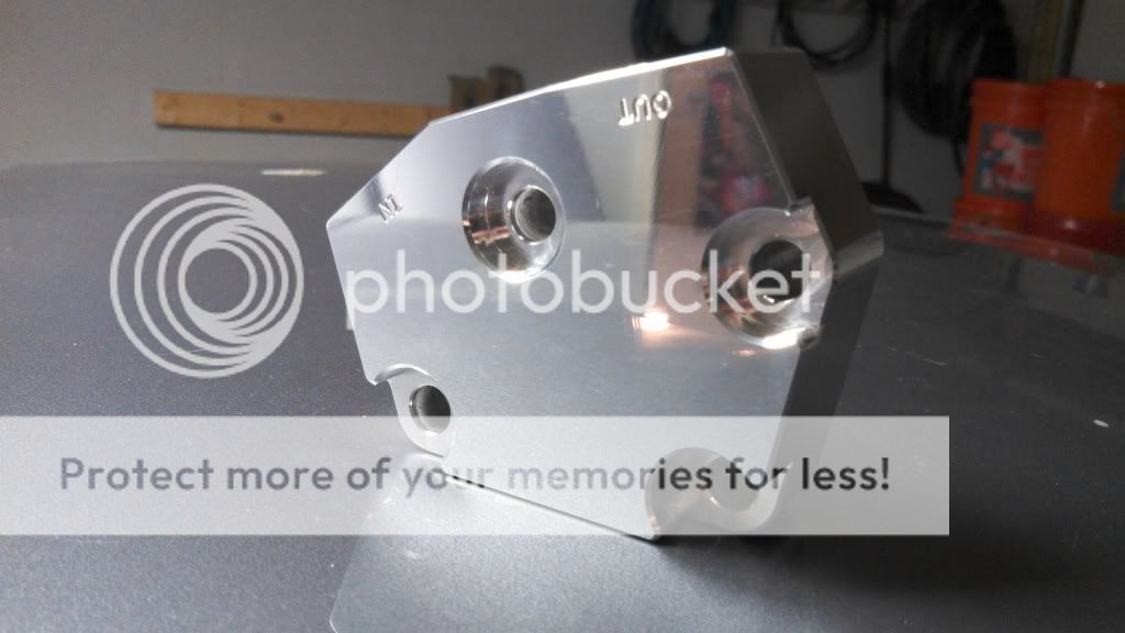

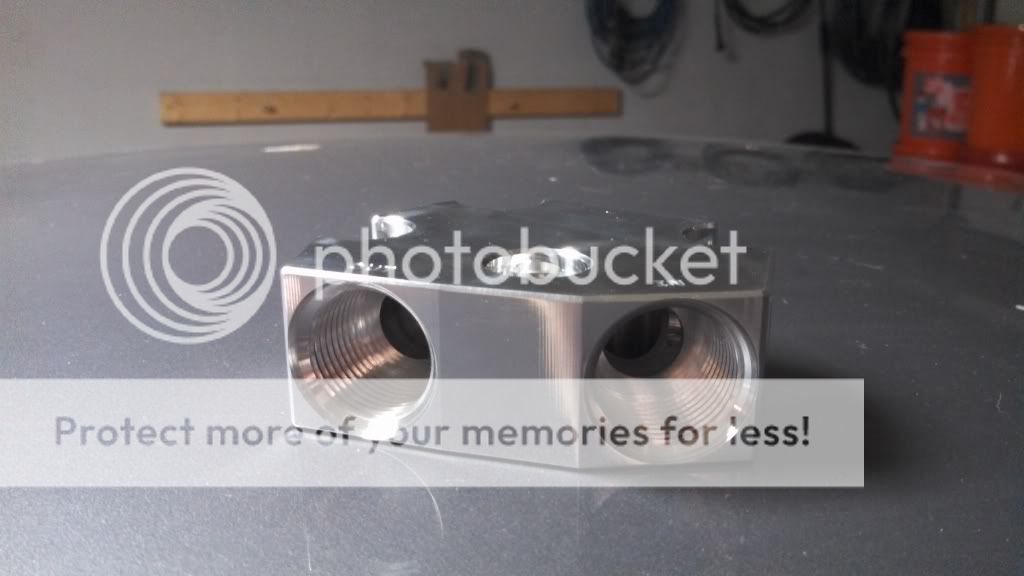

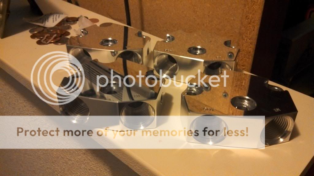

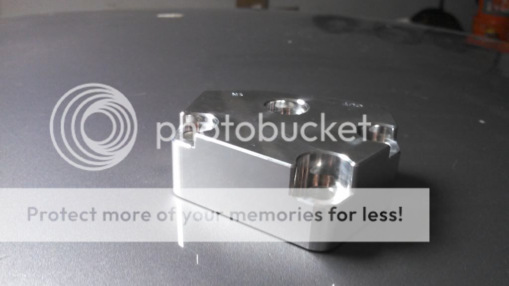

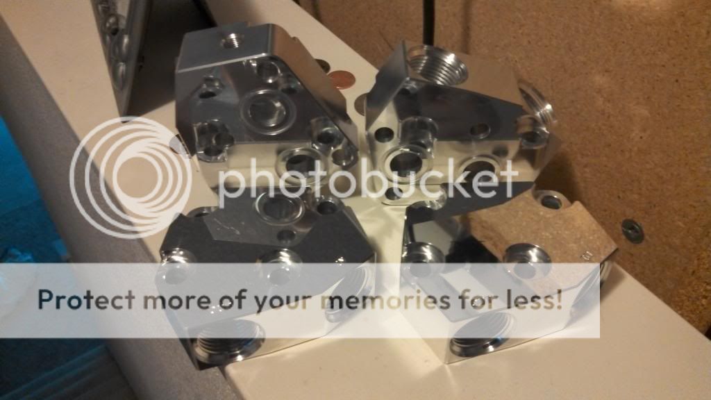

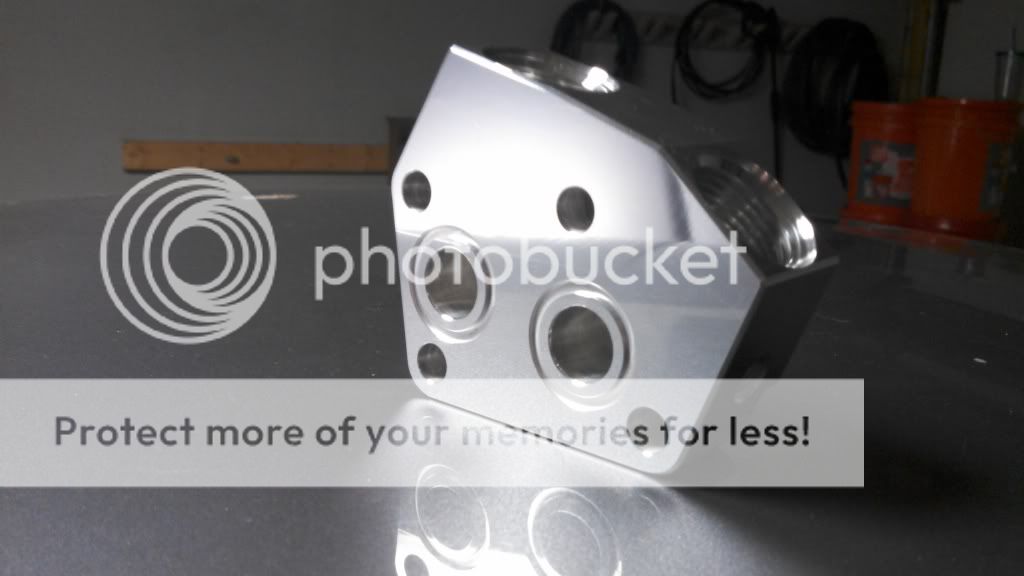

b20vtechb Posted March 28, 2013 Share Posted March 28, 2013 (edited) VH45de Billet Oil BlockUses Factory o-rings for sealing to the block2 -12an ORB Female ports1 1/8th NPT porti just had 20 of these made i have 14 left and they probly wont last long. 200$ shipped Edited April 14, 2013 by b20vtechb Quote Link to comment Share on other sites More sharing options...

fraz Posted August 12, 2013 Share Posted August 12, 2013 i think 200 shipped is the new price? a fair bit of design went into these. I have one on my vh into datsun cedric project which has very little room between the block and chassis rail and with 2 90deg fittings the hoses come out right next to the block. Quote Link to comment Share on other sites More sharing options...
