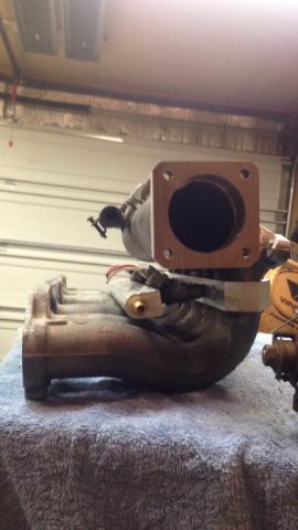

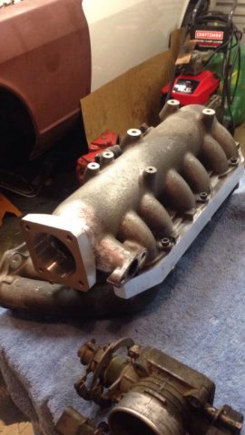

I got this idea after reading and conversing with a few of the engineer types on this forum. Reading that the runners are the most restrictive part in the engine. I've measured the stock intake at 1.25", the valve is 1.55", the new intake measures 1.45" where it bolts to the head, matching a lot closer to the valve then a stick intake ever could. As for the injector positioning, I think it could be enough of a difference to mess with a stock ECU especially being batch fired, but mega squirt has options for adjusting to this type and I assume the other aftermarket FI can compensate as we -
The runners on this intake are a little larger and much longer. I added the flange for the throttle body. Custom fuel rail on the "adapter plate". I don't have an L in my Z anymore, so I can't bolt it up and try it out. I'd like to produce and sell these as a custom option. This being the prototype

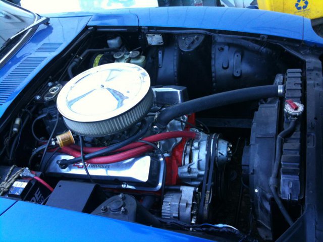

Although I always install my temp sensor in the intake manifold itself. If you have an aftermarket intake, you will have the option too. It gets the temp sender away from all the header heat. Here's a pic of my old 1978 with a 400ci small block I installed. I bought the car with the original inline 6 that threw a rod. -

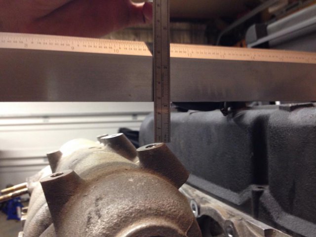

So what your telling me is the diesel intake barely fits between the hood already. I'm measuring from the flat area which is almost 1/2" shorter than the front of the cam cover, But not the 1" to 1 1/2" I was hoping for. Hmm. Than I will modify these intakes the hard way... Still hoping to find a local with a longblock in a Z I could mess with. I find useing small cardboard boxes is a decent way of finding clearance issues. I got a 3" air filter on my sbc swaped 78 that way. -

I have a few diesel intakes sitting around. I'm thinking about modifying them for use on gas type engines. With there longer and bigger runners. But my issue is I dont have a Z around with a L6 in it for me to mess around with testing clearances. My question is, How much can I raise the "log" portion of the intake? Is there a Z with a long block in it I can mess with around Portland OR? I'm located really close to Gresham. Thanks for any help
