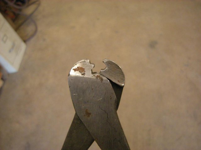

Snailed Posted April 25, 2013 Share Posted April 25, 2013 Take these http://www.harborfreight.com/9-1-2-half-inch-wire-crimping-tool-36411.html and cut the jaws off, leaving just the crimper for bare terminals closest to the pivot point. You can then work them around the end of a tube and make a pretty nice bead in a few minutes, even on stainless steel tube. If you want a really nice surface finish you can dress the jaws a little with a file so they fit the radius of the tube a little better. For $7 it's a pretty good setup. Quote Link to comment Share on other sites More sharing options...
Snailed Posted May 28, 2013 Share Posted May 28, 2013 Like these. Quote Link to comment Share on other sites More sharing options...

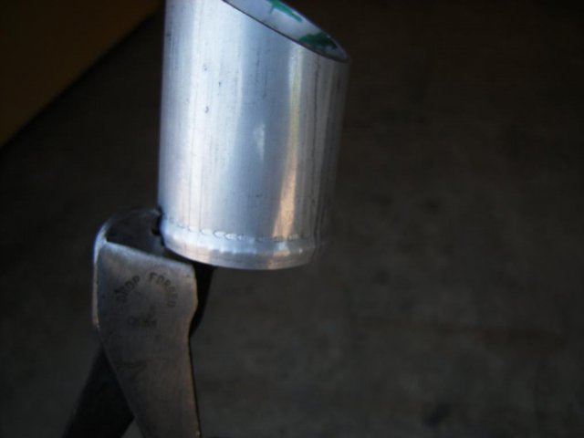

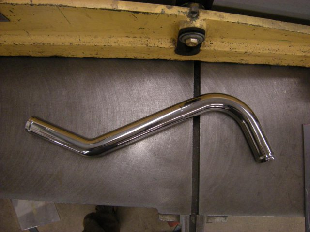

Snailed Posted June 2, 2013 Share Posted June 2, 2013 Ahh that could be even better if you are doing soft stuff like aluminum IC tubes. Good suggestion. I do lots of beads so I use a Bead Form or the Vibrant bad roller. It's nice to be able to do stainless and tubes down to 3/4" like this 1.5" tube I put together. If you plan on doing a bunch of them (or have the $ and like to do nice work) it's worth it to get the right tools. The other picture is a bead I started as a sample for you with the pliers. That is just one aggressive pass so the tool marks are pretty sizable, but it will do the job of retaining the tube just fine. You could make multiple passes and get a nicer result. Quote Link to comment Share on other sites More sharing options...
