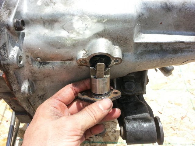

col10see Posted April 22, 2013 Author Share Posted April 22, 2013 (edited) Can someone tell me what way the rev. check sleeve is supposed to go? Edited April 24, 2013 by col10see Quote Link to comment Share on other sites More sharing options...
NewZed Posted April 22, 2013 Share Posted April 22, 2013 You could match up the rust and grime marks. Or put it all together and see which way "checks" reverse. Or both. Quote Link to comment Share on other sites More sharing options...
col10see Posted April 23, 2013 Author Share Posted April 23, 2013 What does that even mean checks reverse... not being snarky just dont understand wtf this thing even does ill check the grime but it may be difficult as I power washed the mofo. Quote Link to comment Share on other sites More sharing options...
NewZed Posted April 23, 2013 Share Posted April 23, 2013 I think that the purpose is to "pause" or "check" the striking rod when you're pulling down from 5th gear. If you've used an older model 5 speed you know that it's super easy to drop in to R from 5th, there's no check sleeve. It only fits two ways and pops in an out. Install it, try the 5th to 4th shift, if it's too easy or binds up, flip it. You can try it out before you re-install the transmission. You might find that it only works one way. Or you can stare at the striking rod and the check sleeve and logic it out. It might be obvious. I've looked myself. but I didn't put the time or thought in to it. If it makes no sense, I have an 83 in the garage I could take a look at. Quote Link to comment Share on other sites More sharing options...
col10see Posted April 24, 2013 Author Share Posted April 24, 2013 Ill give it a few tries thanks Quote Link to comment Share on other sites More sharing options...
col10see Posted April 24, 2013 Author Share Posted April 24, 2013 (edited) Ok I think I figured it out... the flat tab thingy goes on the top. This makes it so you cant go from 5 to reverse but you can go from 5-4... but you can unlock reverse from neutral a wiggle and down to reverse... Edited April 24, 2013 by col10see Quote Link to comment Share on other sites More sharing options...
