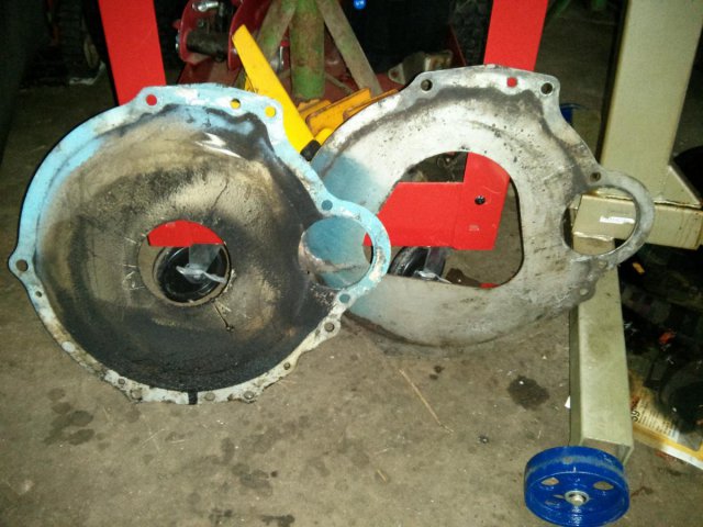

PapaSmurf Posted April 18, 2013 Share Posted April 18, 2013 F54 flywheel backplate has a much smaller hole for the crank than the n42 backplate I just noticed this as I'm pulling apart the n42 to use its crankshaft and flywheel on the f54 anyone know why the n42 hole is so large? Doesn't seem like it would make any difference at all just a curiosity Quote Link to comment Share on other sites More sharing options...
Tony D Posted April 21, 2013 Share Posted April 21, 2013 Cheaper, weighs less. Quote Link to comment Share on other sites More sharing options...
PapaSmurf Posted April 22, 2013 Author Share Posted April 22, 2013 The weird thing is that usually weight reduction and cost savings come later but the f54 has the closed plate and the older n42 has the open plate Quote Link to comment Share on other sites More sharing options...
Tony D Posted April 22, 2013 Share Posted April 22, 2013 Cheaper stamping on the later one, simple round die. Weight reduction on earlier one for "sports", not needed on later "GT" N42 and earlier are all the same big hole. Should have been clearer I guess. Quote Link to comment Share on other sites More sharing options...
PapaSmurf Posted April 22, 2013 Author Share Posted April 22, 2013 Now that makes sense thanks for enlightening me Quote Link to comment Share on other sites More sharing options...
