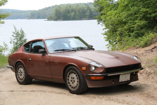

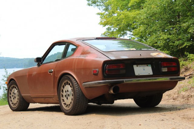

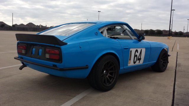

I had to trim mine after it was painted, but by using a file on the urethane and chamfering it inward, it did not show or chip the paint.  I am running some XXR521 which are +20 offset, but I use some spacers (19mm in front and 11mm in rear) to space wheels and tires (225 50 16 yokohama) for best clearance.
attachicon.gif240Z front3.pngattachicon.gifNew Picture (1).pngattachicon.gifNew Picture.pngattachicon.gifxxr521_3.png
are those s12w toyota calipers? if so, did you need a wheel spacer to clear the caliper? what size?
thanks!
