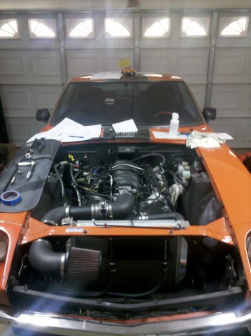

ktm Posted April 24, 2013 Share Posted April 24, 2013 (edited) I used JTR's CAI kit and purchased a K&N cone filter. I did clearance the hole a bit to allow the piping to pass through. Edited April 24, 2013 by ktm Quote Link to comment Share on other sites More sharing options...
wfritts911 Posted April 24, 2013 Share Posted April 24, 2013 I am running the exact setup as ktm posted above, except I ran the tubing through the driver's side core support hole. I didn't need to clearance the hole at all. I am running a cheap Spectre filter from oreillys instead of a K&N. -Will Quote Link to comment Share on other sites More sharing options...

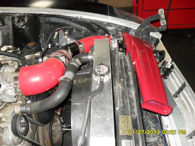

blueshark123 Posted April 26, 2013 Share Posted April 26, 2013 Has anyone tried tilting the radiator back/down and snaking an intake straight over the radiator with something like the corvette K&N intake? I'm no where near that in my build but I do plan to try this. I'm not too crazy about having three 90 degree bends in my intake. Quote Link to comment Share on other sites More sharing options...
Litman Posted April 26, 2013 Share Posted April 26, 2013 Has anyone tried tilting the radiator back/down and snaking an intake straight over the radiator with something like the corvette K&N intake? Kind of, yes, but the car is not complete so I cannot comment on performance. This required fabrication and a custom radiator. Quote Link to comment Share on other sites More sharing options...
Domzs Posted April 26, 2013 Share Posted April 26, 2013 Kind of, yes, but the car is not complete so I cannot comment on performance. This required fabrication and a custom radiator. I like it , looks good ! Quote Link to comment Share on other sites More sharing options...
blueshark123 Posted April 26, 2013 Share Posted April 26, 2013 Kind of, yes, but the car is not complete so I cannot comment on performance. This required fabrication and a custom radiator. Hi Craig. Actually your pictures you emailed me is what caused me to think of trying this. I'm thinking I might be able to do the same without having to modify the rad support and instead going under it by getting a shorter radiator and/or tilting the radiator back. Thoughts? I'm not there yet in my build but I'm hoping to be there soon. Jeff Quote Link to comment Share on other sites More sharing options...
Litman Posted April 26, 2013 Share Posted April 26, 2013 Sorry for my mental lethargy. I forgot about our previous interactions on this topic. I suppose the answer to your question is, it depends. I suspect you can make the radiator short enough and tilt the radiator but will it retain the necessary cooling attributes ? What I can do is take my shortened radiator and see how it would have to be positioned to allow a C5/C6 Corvette intake to pass. I believe, without evidence, that your best bet will be tilting the radiator forward as the TB is about even with the core support. Tilting the radiator back will cause more interference than less. The attached picture may help support my point. Quote Link to comment Share on other sites More sharing options...

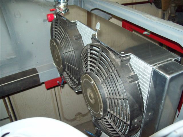

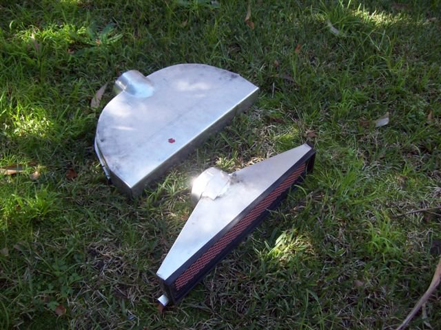

Boy from Oz Posted April 28, 2013 Share Posted April 28, 2013 I had a radiator made that was 50mm lower. I then made a cold air intake to fit over the top with a standard rectangular filter facing downwards and also an alternative shape which would sit behind the radiator. I'm undecided which I will use. Check the Aussie eBay for OTR intakes - they are a very popular aftermarket item down here for LSx powered cars. Quote Link to comment Share on other sites More sharing options...
