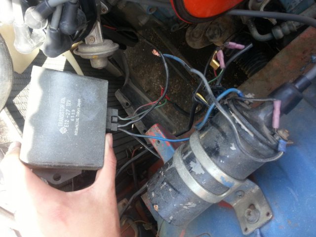

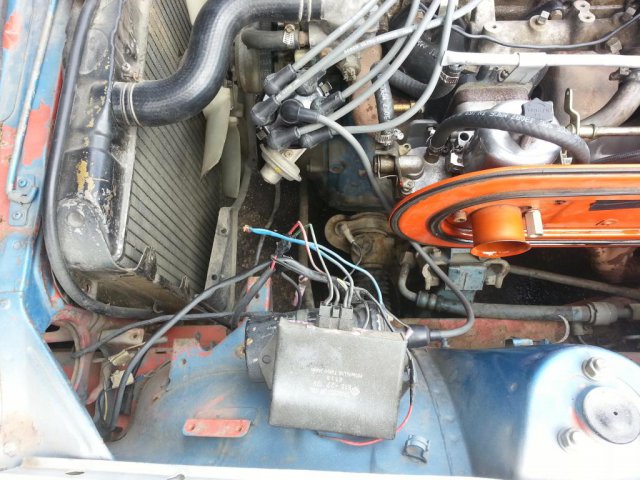

That picture that I just took. I messed with it cuz I wanted to try to see if HEI GM module would work, but didn't do anything.
Are you saying it looks like that now?  You did that?  It looks terrible.
If your distributor works, the GM HEI module is pretty easy to wire up.   If you have an HEI module, a good distributor and a good coil, you could have spark in about 20 minutes.  But if you wire it up like your picture, you'll probably short something and damage it pretty quick.  That old module in your picture might already be damaged.  The HEI module might already be damaged.  They have to be wired correctly with no shorts to ground, from the beginning.  They're sensitive.
No spark, no start, so you might as well focus on that before you do anything else.
That black box is transistor ign. That previous owner hard wired because 240z wiring never came with one and since I have 280z distributor it needs it, how do I check if my distributor is working? plus it doesn't have ballast
Sounds like you know what you've got to do. I'm not sure I'd even try to deal with someone else's frakup.
You might look at just finding a 240Z distrib to get the car running THEN swap to HEI or whatever system you prefer.
