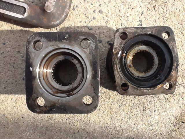

Co0ke Posted May 7, 2013 Share Posted May 7, 2013 I have an entire donor car L28et. I understood that it had an R200. I'm leaving my R180 in my 260z but when I went to swap out the differential pinion flange the one from the R200 is fitted to a larger diameter pinion and will definitely not swap over? All my info on the swap came from this guide.... http://datsunzgarage.com/borg/ Why is this wrong and how do I mate my T5 to my R180? Quote Link to comment Share on other sites More sharing options...

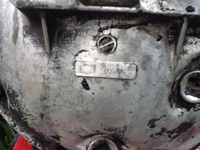

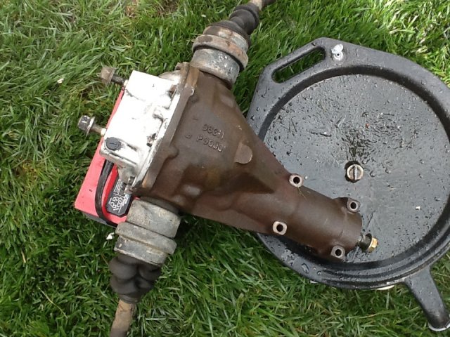

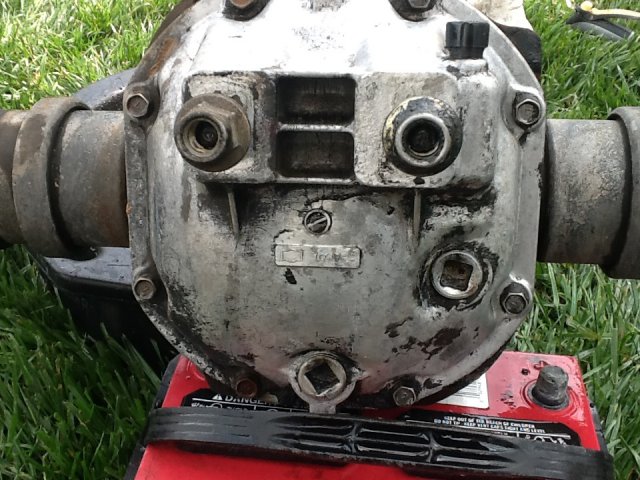

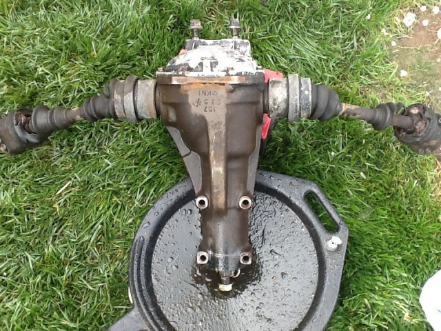

Co0ke Posted May 7, 2013 Author Share Posted May 7, 2013 Here are some photos of the diff out of the 83 zxt donor car. R200? The last pic is the 2 different flanges Help plz Quote Link to comment Share on other sites More sharing options...

Leon Posted May 8, 2013 Share Posted May 8, 2013 Swap in the R200. Quote Link to comment Share on other sites More sharing options...
