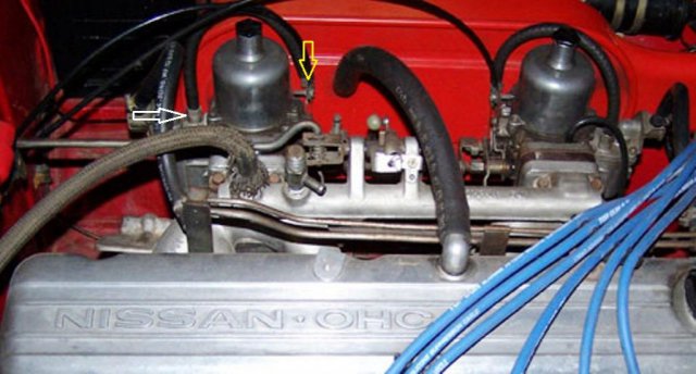

chefen73 Posted May 8, 2013 Share Posted May 8, 2013 Problem.......yesterday when wanted to go driving my 240z (eu spec - no smog), i discovered that gas ran to my airfilterbox and that it came from the nipple(white arrow) in this picture !!?? H E L P..........im not a mechanic so any help is appriciated THX Kenneth from Denmark Quote Link to comment Share on other sites More sharing options...
BluDestiny Posted May 8, 2013 Share Posted May 8, 2013 if you're not a mechanic how will you be able to fix it. It could be your float, it could be your fuel pressure regulator, it could be a lot of things. You should find someone knowledgeable close to you to help figure it out. Quote Link to comment Share on other sites More sharing options...
Leon Posted May 8, 2013 Share Posted May 8, 2013 Needle valve is stuck. Tap the offending carb's float chamber with the handle of a screwdriver and see if it helps. Quote Link to comment Share on other sites More sharing options...
chefen73 Posted May 9, 2013 Author Share Posted May 9, 2013 Thx Leon........finally some advice.....in stead of negative comments ! Quote Link to comment Share on other sites More sharing options...
chefen73 Posted May 9, 2013 Author Share Posted May 9, 2013 @ Leon........i owe you a steak dinner next time i visit sunny California you´ll get "served"..........it now runs without any problems Quote Link to comment Share on other sites More sharing options...
