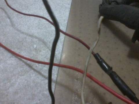

Moving right along, on the other side of the harness (180 degrees around) are three more cut wires (only two pictured). They are a black wire with a white stripe, a white wire with yellow stripe, and a solid black wire. Any ideas what these go to/should go to?
Left-BlackwithWhitestripeRight-Whitewith
A little further down is a cut blue wire with a black stripe. Any ideas what this went to/is for?
UnknowncutBluewithblackstripewirecomingf

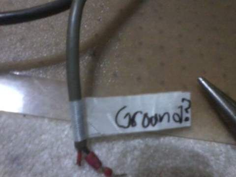

Next is an insulated black and red wire both in the large grey insulator. I read somewhere that the black wire was just a ground, can anyone confirm this? I have no idea on the red wire.
Grayshieldedsmallwirepossibleground_zpsd

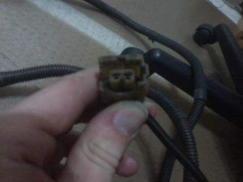

Right next to that is a plug with a black grommet and two wires coming from it they are yellow with green stripe, and black. I’m not sure what sensor this is for but I believe it is either the knock sensor or the oil pressure sensor, the plug is similar to the injector clips, but its on the wrong side of the harness. Can anyone confirm what this is?
UnknownPlugcloseupneargrayshieldedwirepo

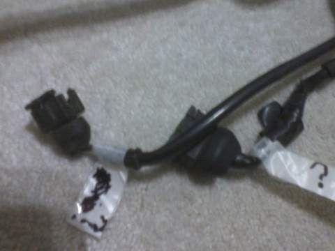

On the other side of the wiring harness are two connectors I ‘m unsure of what they hook up to, one is similar to the injector clips and the other also similar but has 3 pins. They are slightly up from where the AFM wires branch off.  Any ideas what these go to?
Front view
Frontviewoftwounknownconnectorsnearinjec

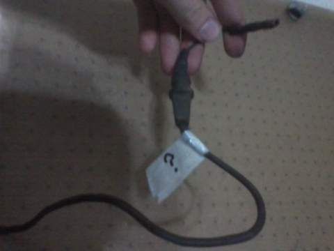

Slightly further up the harness from those two plugs, is the black wire pictured.  Anyone know where this goes? I’m thinking maybe to the temperature sensor or something.
Unknownplugnearinjectorplugssensormaybe_

I take it you never got the chance to see a stock zxt engine bay. I have a couple photos on another site. Maybe I find them later. If you hadnt yet, look at the ECCS component diagram, and read what each part does. Then try the wiring diagram. Find part x that plugs in by wires, and next to it is the wire colors. You have access to answers, and I think that is why more responses have not been seen. Anyhow, the 3 terminal connector that is near the injector/AFM could be TPS if you have only 2 wires in it. Two wires to CHTS, by knock sensor. Match things up. Keep lables being written and attached. Eventually it will start to make sense. When you get stuck come back.

Your next-to-the-last picture looks like the wire that goes to the O2 Sensor.  If it is, it'll have a squarish body with a male spade on the harness end.  Take it apart, show us the end.  What's on the end of it right now is hard to recognize.
