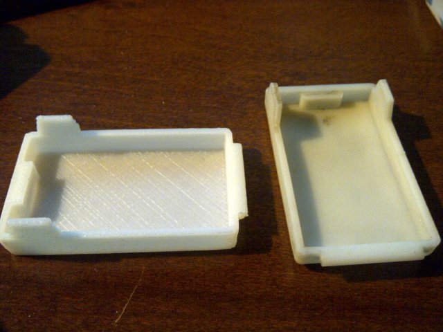

Pharaohabq Posted February 1, 2014 Author Share Posted February 1, 2014 On 1/7/2014 at 9:27 PM, socorob said: I second the dome light. Those lenses are hard to find. Well I finally had some time to get to work on this. I took my NOS light I was saving apart and pulled out the lens. I was amazed that even though this was in a box for the past 35 years and in the plastic, that the lens was kind of spiderweb'd with cracks in it. Kind of annoying, but in anycase, my original is still intact for It was easy to get measurements. I recreated the lens in Creo and made some adjustments. For 3d printing ease I made the face flat rather than rounded and bevelled the edge. this worked well. I Printed it out in White and here's the product: Reproduction on the left, OEM on the right. The top + assembled: A close up: you can see the diagonal gridding of the print, which actually adds a lot of strength. The lens face is only 1.5mm thick. I connected it to a power supply with an LED dome lamp: If anyone needs one of these, please let me know. I'll sell em cheap. Just PM me. Thanks... If anyone else has any ideas for things that would be nice to reproduce for these cars, please let me know. I'll be happy to work on it if it's something that's printable. Phar Quote Link to comment Share on other sites More sharing options...
skerry Posted February 1, 2014 Share Posted February 1, 2014 I'm thinking about building one of those abs vacuum forming setups. I want to create a new center dash that I can modify to fit all of my ideas. Could you create something like that? Just a solid piece of plastic that would fit in that space. Quote Link to comment Share on other sites More sharing options...
Josh280z Posted February 1, 2014 Share Posted February 1, 2014 I need one of those dome lamp lenses for my s130. Quote Link to comment Share on other sites More sharing options...
