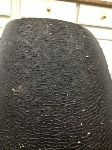

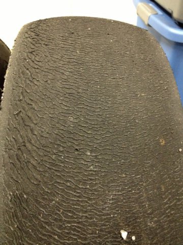

Brought home 26 timeslips. Had trouble hooking from the first run. Turned 2-step down from 3800 to 3000 and had better traction. Turned it back up to 3500 and spun twice so down it went again to 3000 for the rest of the night. 60-foots were high 1.5s (like 1.57 to 1.59); times varied from 7.08 to 7.55 while spinning badly, but ran most consistently between 7.10 and 7.18. Lights were from .471 (3-red lights) and

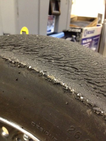

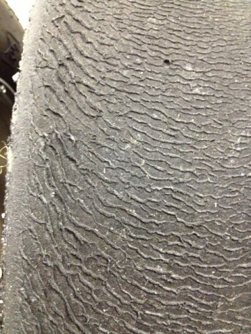

.58-something, but I ran most consistently around .550. Missed the shift to third twice after bad spinning starts (seems it is pretty easy to break my concentration). Had one 2-step malfunction, but an adjustment of the switch cured it. Line-lock did not work for the entire night, which made warming the tires pretty hard, but I went back to my left-foot braking burnout technique and kept running. I played with my brake bias and burned my hands on the exhaust when I borrowed some 10mm wrenches and loosened the emergency brake cable a lot trying to get some line-lock effectiveness, so it must be the solenoid. I think maybe my slicks have just heat-cycled out. They are plenty soft but are at the very bottom of the wear markers. They feel spongy instead of sticky. One spectator told me that the slicks were wrapping enough that he though my rims were gonna hit the ground (13psi). With the camber I have (+1-degree) the wear is very even across the tread. But the rubber is coming off in little sheets, and no one else seemed to be spinning, so I don't think I can blame it on track prep. Strangely, my 3.54 gears were a little short last night: I was hitting the factory rev limiter JUST before the traps. I usually hit it just after the traps, so my next set of tires may have to be 27" if this continues. That will mean changing ride-height...

Need video of the tires on launch...... If they are wrapping up ,,, if you see like a zebra stripe patterns on the side walls you could be walking over the tires. Usually goes into tire shake/ wheel hop. Are your tires screwed to the rims? If not check for rim turning in the tire.

Tires.  Ready to go tomorrow to get the 9" Hoosiers swapped on.  Anybody have an opinion on this wear pattern?  Before Friday I hope to have aluminum rear LCA bushings to try to stop the toe-ing in on launch.  Will set up the bushings to further increase positive rear camber, too.  Bedtime.
