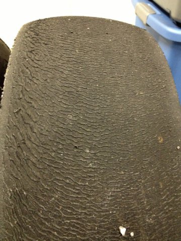

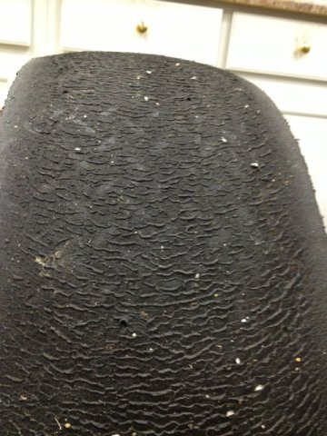

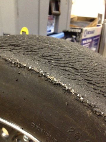

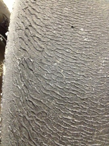

RebekahsZ Posted August 19, 2013 Share Posted August 19, 2013 Any drag racers out there who can tell me if this slick wear is normal? The rubber seems to be peeling off. Had terrible traction this weekend at the track. Wear is JUST to the bottom of the wear holes. This is how they look after about 100 passes; this was how they looked right after the last run. Have been running 13# hot in them; tires are mounted on 7" rims with rim screws. Traction was terrible last night after being really good initially at the beginning of the season. Have I over-heated them with too long of a burn out? Too many heat cycles? Is my alignment goofed up? Is this just normal wear and I need to chill if my next set does the same thing? Quote Link to comment Share on other sites More sharing options...
skirkland1980 Posted August 20, 2013 Share Posted August 20, 2013 Looks normal but a long burnout is not necessary. Just spin the water a trash off them. Just a hint of smoke. Don't burnout in the water. Just a few revolutions of the tires in the water, then pull out and then spin the tires. Quote Link to comment Share on other sites More sharing options...
RebekahsZ Posted October 19, 2013 Author Share Posted October 19, 2013 Never followed up on this. An extra long burnout cleaned the tires up. I had a buddy go into water box with me. Short burnout did nothing to clean up tires so I did a long burnout=tire smooth as a baby's butt and car started hooking up again. Quote Link to comment Share on other sites More sharing options...
