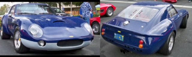

Fauxre Posted October 28, 2013 Share Posted October 28, 2013 On 10/28/2013 at 4:37 AM, tamo3 said: Looks great! Someone should buy another Vela Rossa kit http://sfbay.craigslist.org/nby/cto/4137173389.html So cheap! Wow...that is a great deal. But actually, that's not a Velo Rossa kit. It looks like some one has adapted the VR cheek panels to a Merlin body kit. Wish I had the space... and an understanding wife...I'd snatch that up in a minute. Quote With the doors on she is basically complete. I need front turn signals and to mount the license plate, then I can start the DMV process. Dan, forgive me if you've already answered this question, but why are you going the SPCNS SB100 registration route? Isn't the Z already registered as your daily driver? If you're already smog exempt, and don't participate in the bi-annual inspections, i would think that you should able to keep registering it that way and avoid all the SB100 hassles. Quote Link to comment Share on other sites More sharing options...
