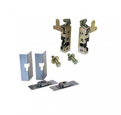

I see we have he same door latches.  They seem overly complicated to adjust and mine are so worn that I don't see any real possibility of getting them to work properly.
I think these small latches would work much better.
