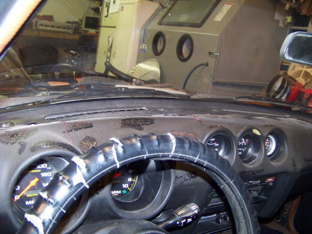

socorob Posted August 29, 2013 Author Share Posted August 29, 2013 The dash has a cover, and I'm scared to remove it to see what lurks underneath. If I have to pull the dash for anything, I will probably try to fix it because, quoting Jalopnik, "the Z dash covers look about as natural as Donald Trumps toupee." Quote Link to comment Share on other sites More sharing options...

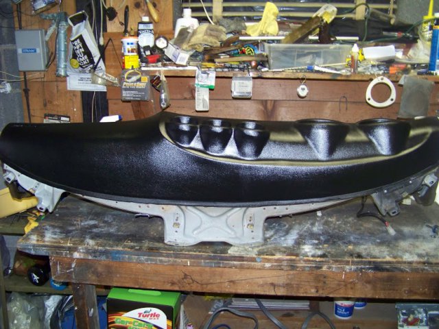

rags Posted August 29, 2013 Share Posted August 29, 2013 I hear ya about the dash cover. I started with a dash that looked like this and replaced it with this one in the second picture. Quote Link to comment Share on other sites More sharing options...
Domzs Posted August 29, 2013 Share Posted August 29, 2013 I hear ya about the dash cover. I started with a dash that looked like this and replaced it with this one in the second picture. Actually , the first pic doesn't look that bad , have way worse . Second pic , new dash or cap ? Quote Link to comment Share on other sites More sharing options...
socorob Posted August 29, 2013 Author Share Posted August 29, 2013 At least you have the matching steering wheel and dash cracked look option. That was a rare combination for that year. Quote Link to comment Share on other sites More sharing options...
