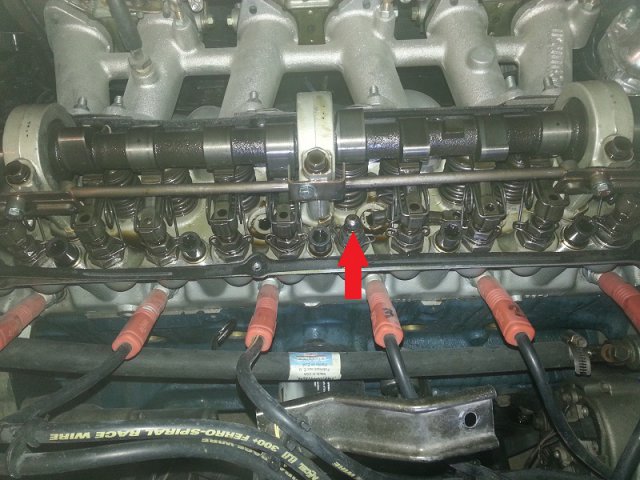

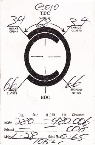

AZGhost623 Posted October 16, 2013 Share Posted October 16, 2013 (edited) So two weeks ago this happened AGAIN. Another rocker popping off. This time I was stranded and had to be towed home engine wouldnt run at all. I fixed it again the next day, and I set all the valves to 8 thousandths from what a local datsun mechanic told me, and compression tested all cylinders which tested to be between 220-230 across all 6. So I have no clue about this valve train. All I know is that it supposedly has this cam (spec sheet attached, which I doubt because of no rough idle), the P90 head has been shaved .080 with the shims and such. I have since ordered from Schneider new double hylift springs, and new retainers. Should I get new lash pads (what size?) and rockers as well? All the rockers look just fine from what I could tell I didnt see any weird wipe patterns or damage on the rockers or cam. I Appreciate any kind of assistance to help get my valve train setup right. Edited October 16, 2013 by AZGhost623 Quote Link to comment Share on other sites More sharing options...
