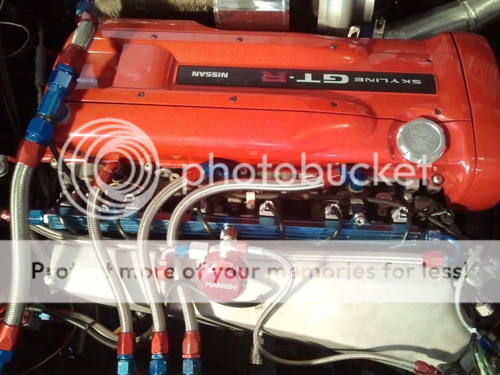

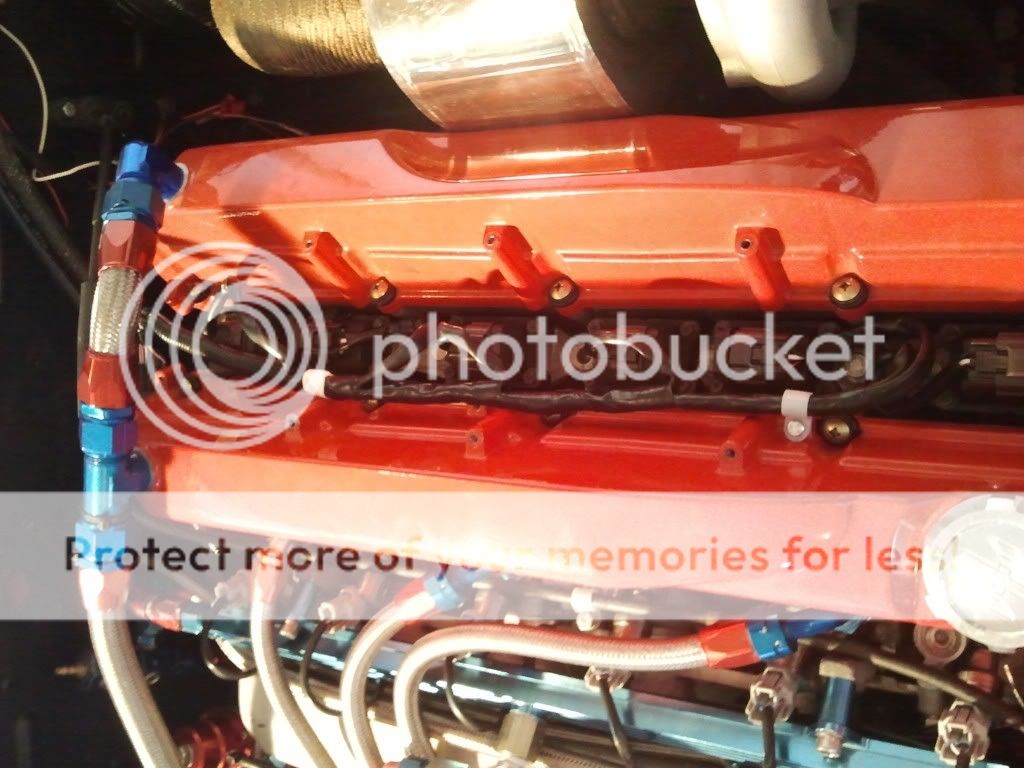

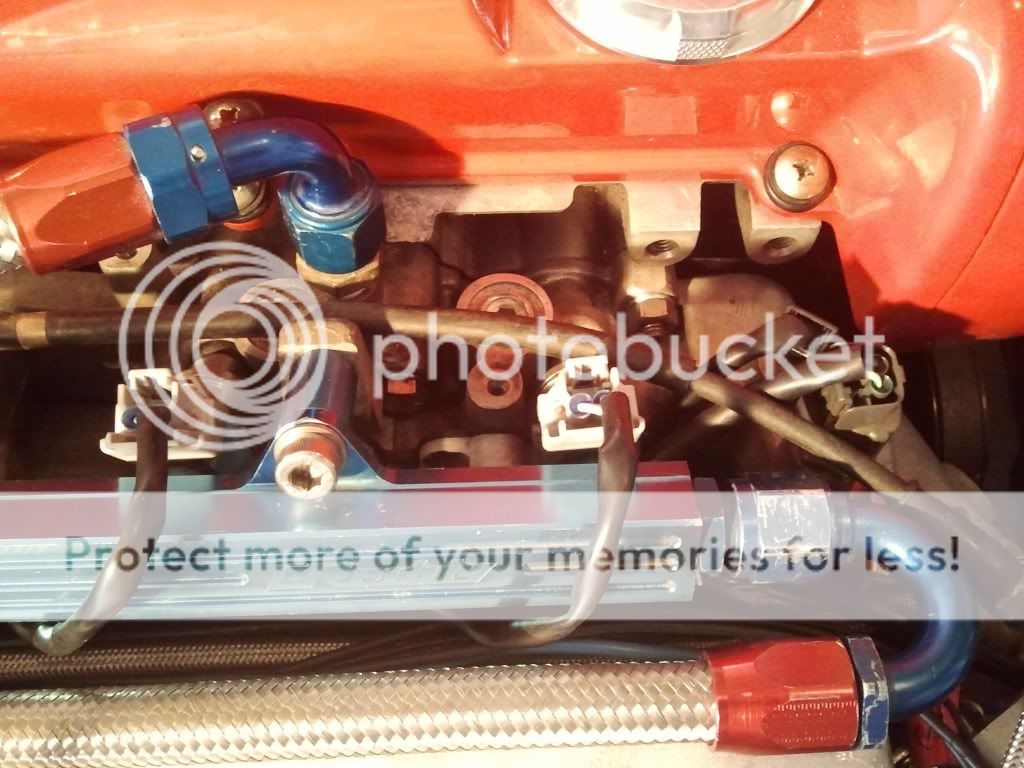

stony Posted December 1, 2013 Share Posted December 1, 2013 Mine is a little different from a stock harness but yes its in there. I also got the injector harness. Here is what my stock harness looked like. Quote Link to comment Share on other sites More sharing options...
